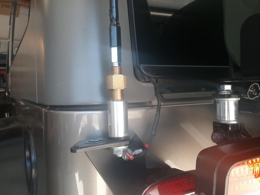

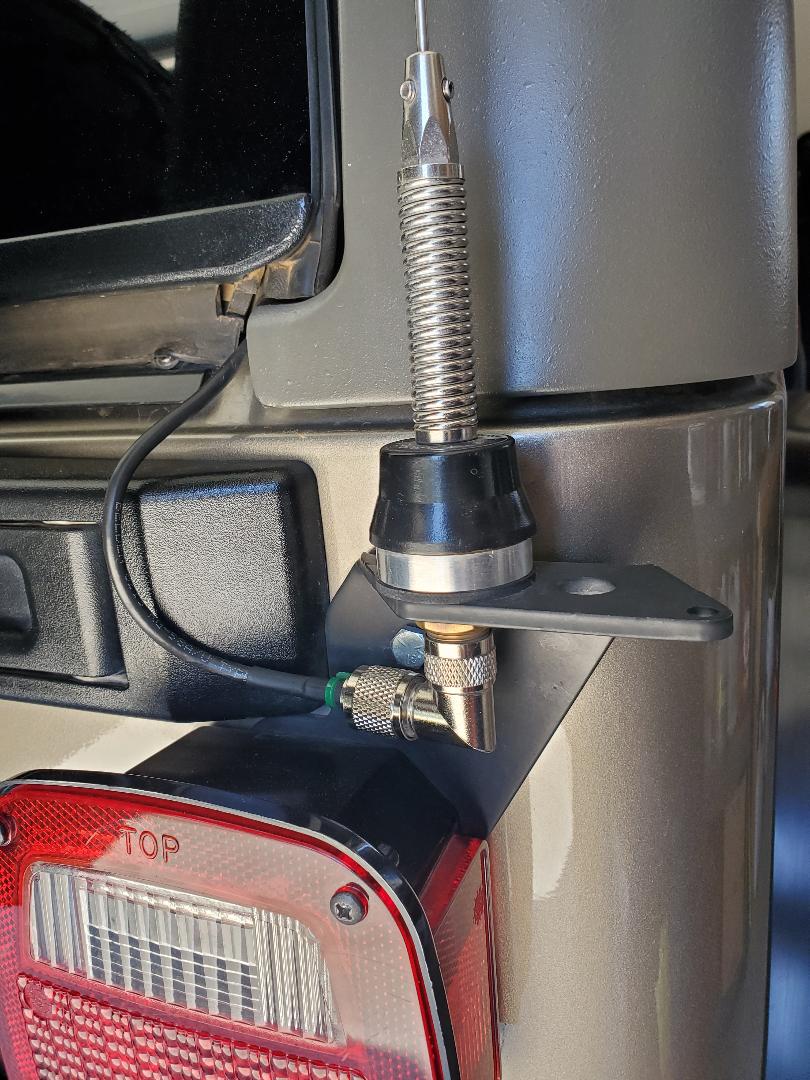

It probably goes without saying but I will say it anyway: in radio, the performance of the antenna, the quality of the coax and connectors and the proper placement of the mount are all WAAAAY more important than any other single factor. Don't cut corners on that stuff and make sure your connectors are properly sealed and strain relief installed etc and you will have a much happier time!
