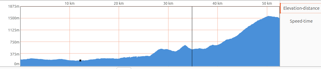

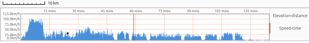

I'll include the elevation-over-distance graph and the speed-over-time graph from that trip up the big mountain when my tranny overheated. The overheat built up to around the 50km mark and I was in high range the whole run up that hill. Probably at about 110 minutes or somewhere after 45km is when I realized that my transmission was hot.

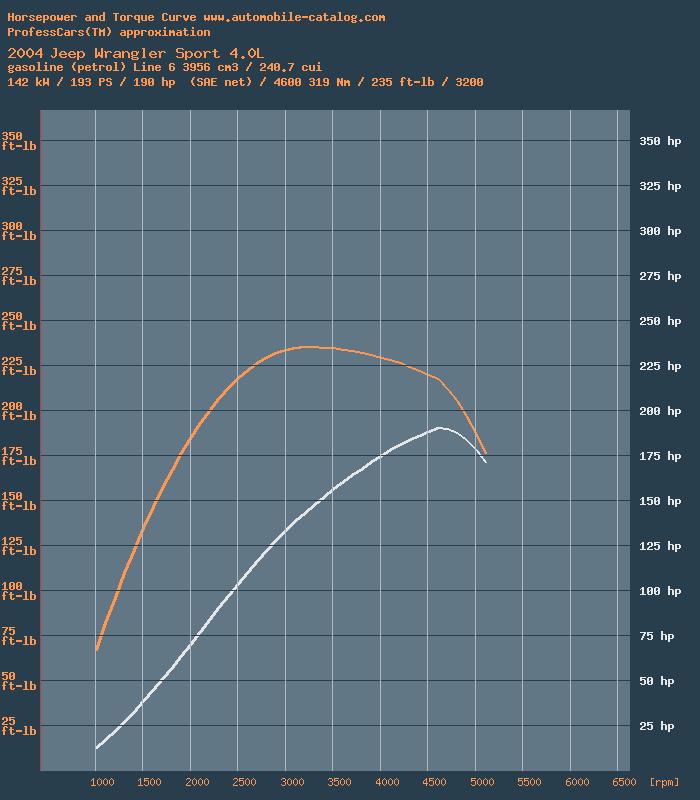

Where abouts is the powerband for the stock 6 cyl 4.0l ?
It is usually technically regarded as the range from peak torque to peak horsepower - 3200-4550 rpm on the TJ 4.0L generally. At 2500 rpm you've gotten most of the way to peak torque so functionally, 2500-4550 is a decent way to think of it. If you're lugging it just means you are applying more throttle, thus fuel at a lower RPM where it isn't making power efficiently. It is more efficient to cruise at a lower rpm when power demand is low. I'm not saying you always want to be in the power band.
