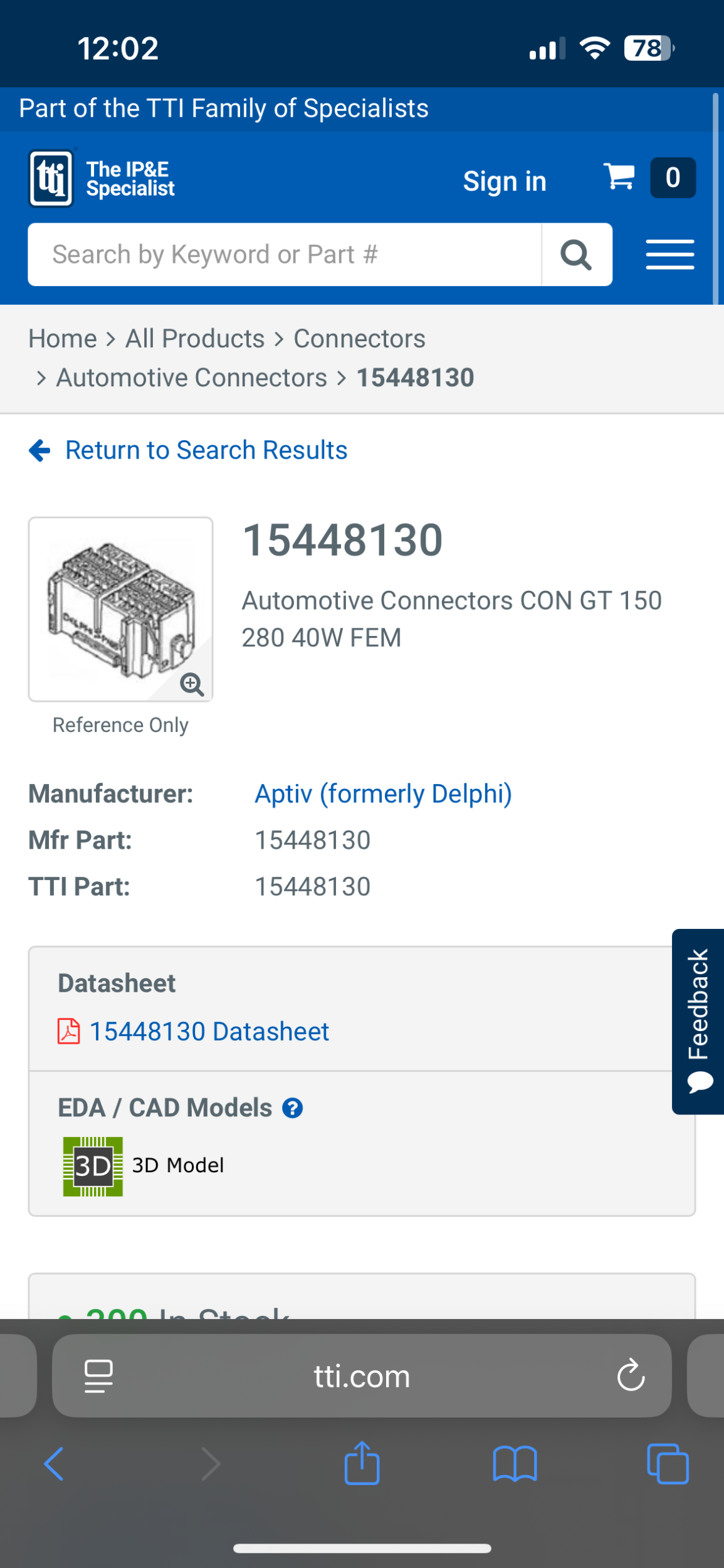

I want to add some switches for accessories in the dash, IE fogs, winch, heated seats, etc. I am the type of person that would much rather use the existing connectors to add my own circuits to keep it clean and organized. So I want to find terminals for the under dash C107, C170 and C202 connectors.
After searching around many electronic component pages I have found that C107 and C202 use easily sourceable GT150 and GT280 terminals. But I cannot find a definitive answer on what type of connector is the C170 is. Would anyone know what series terminals the C170 uses?
Give connector experts a call. They’ve been great to deal with in the past. They’ll even send you the terminals pre crimped with a pigtail if you want which is nice sometimes. I gave them pictures and measurements years ago and they hooked me up.
https://connectorexperts.com/
