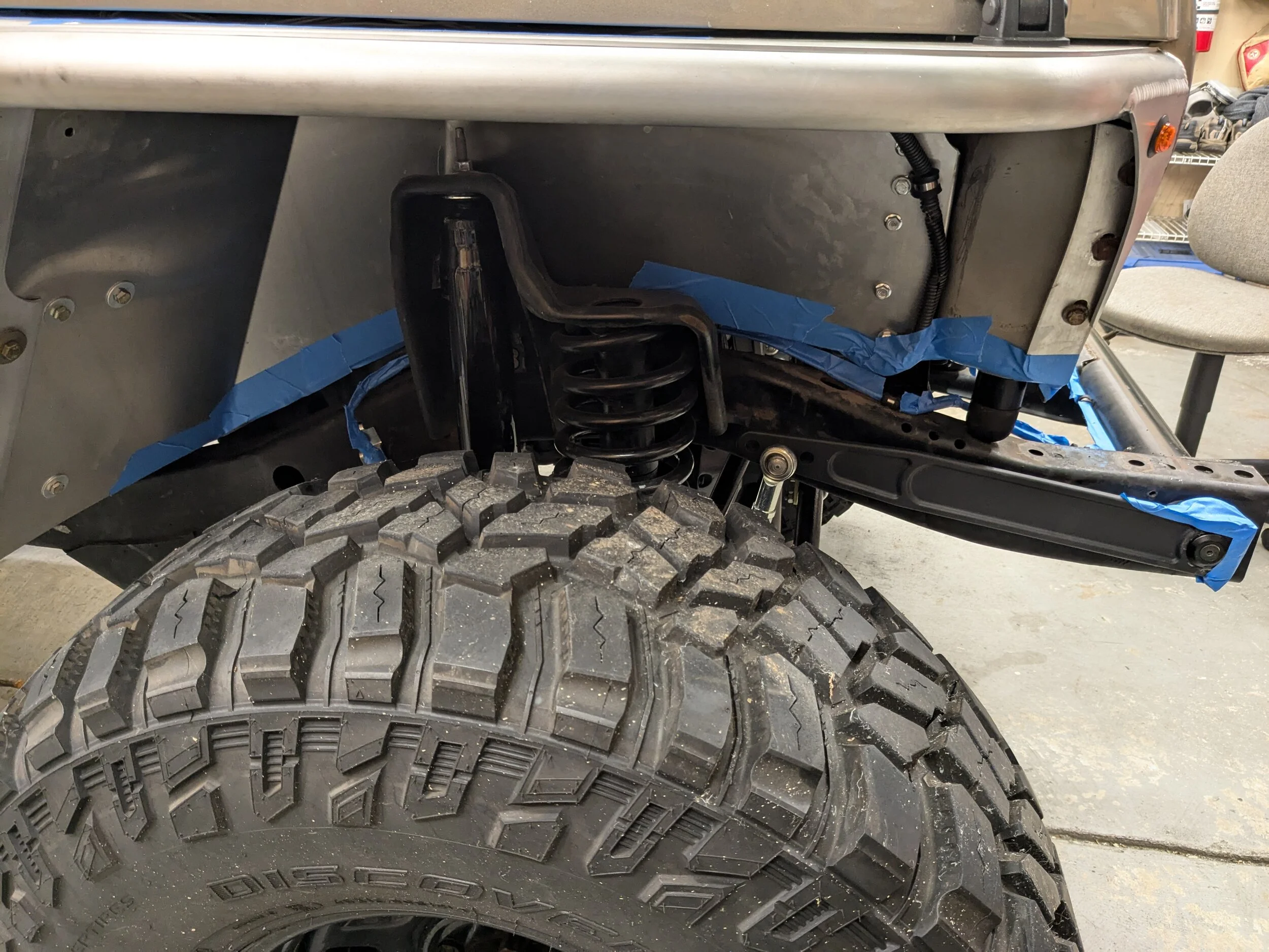

Clearance of the brake line to the bumper now.

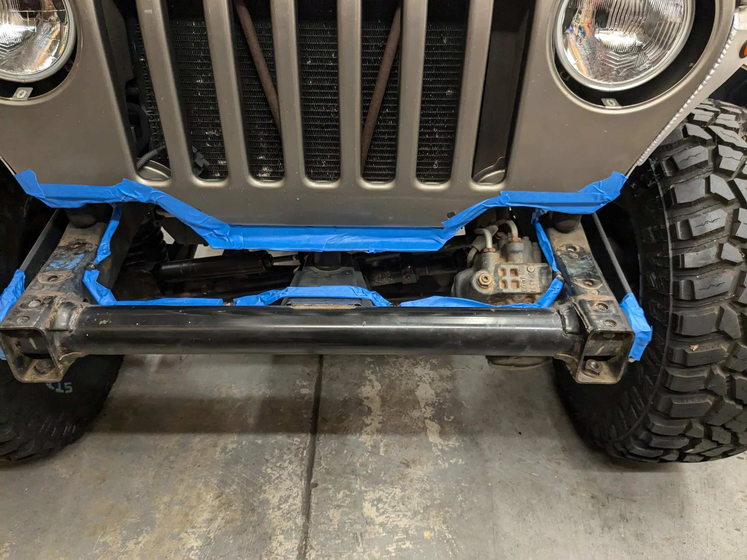

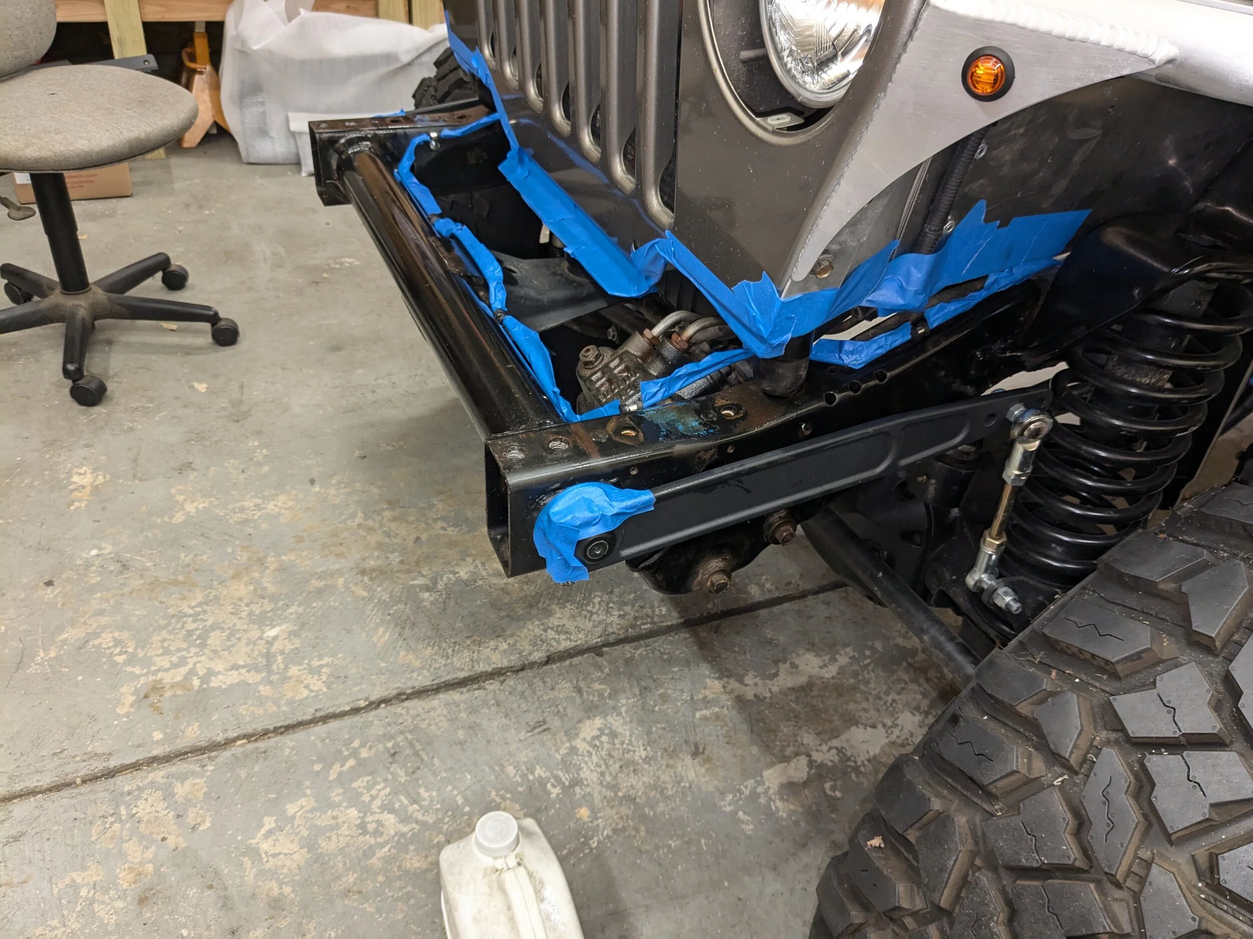

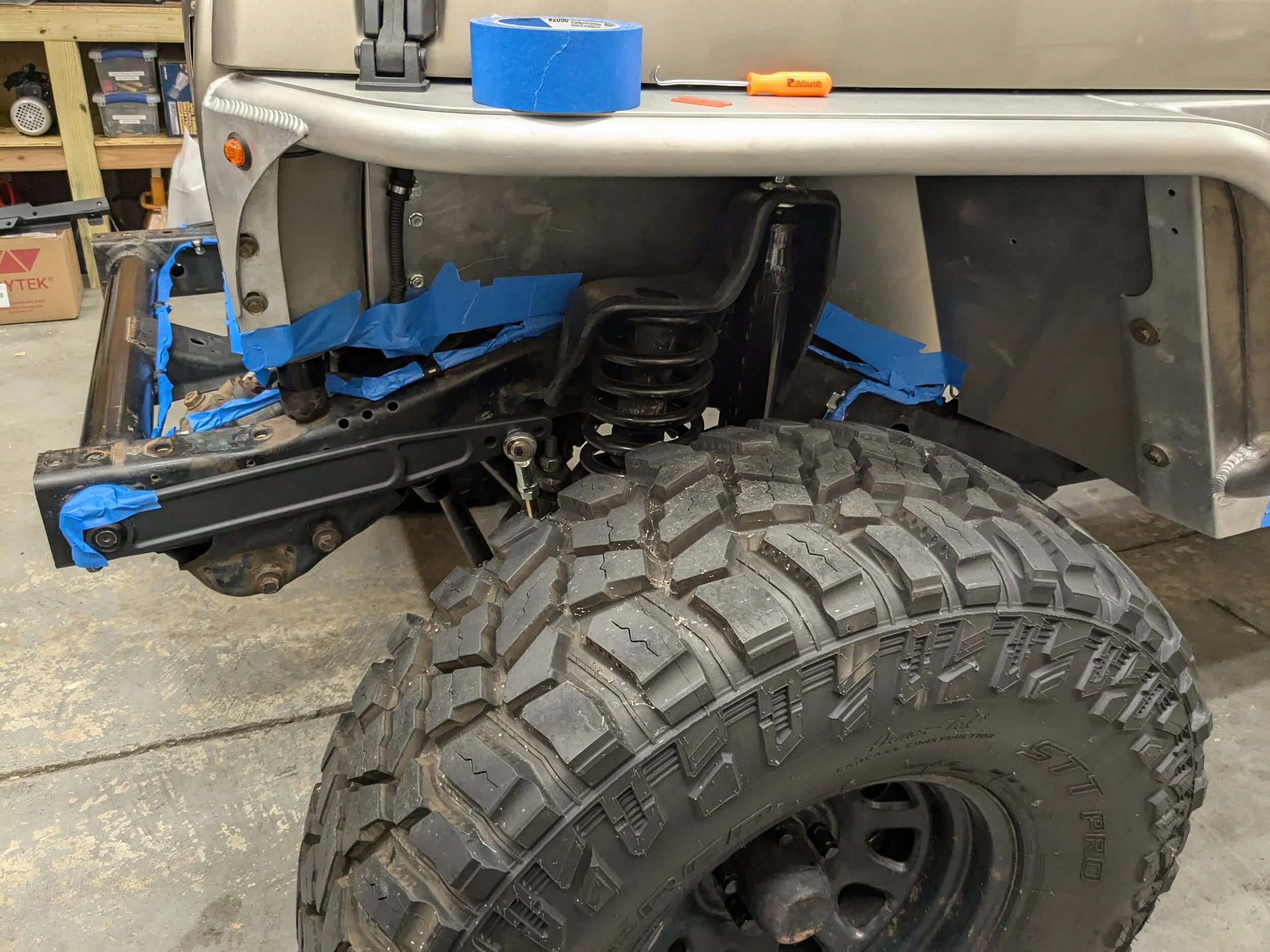

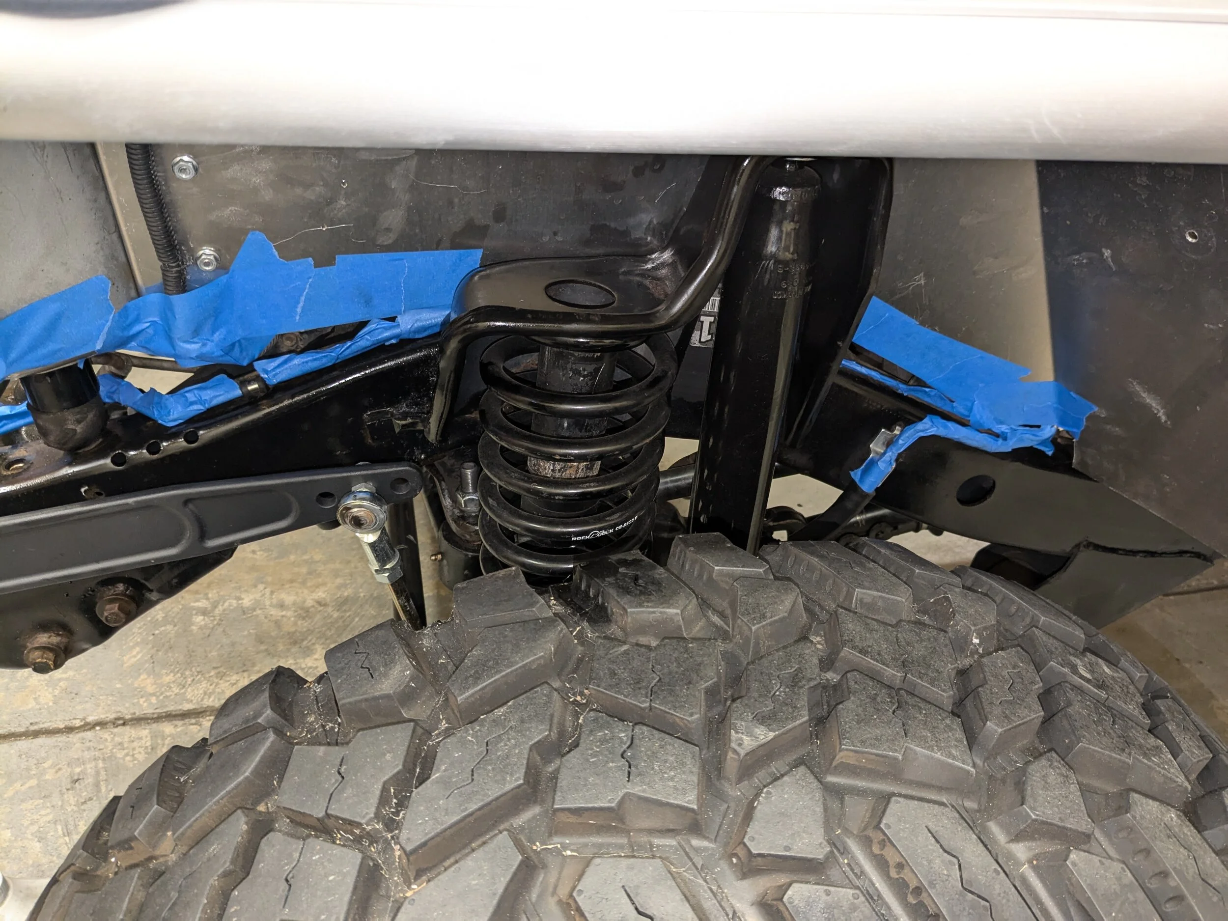

Taped off the stainless steel lines on the front end in prep for painting the frame.
Hit the frame with the first round of mineral spirits to clean it off. It's still a little wet so a little more shine than it will have.
Will hit it a second time with monster spirits for anything missed on the first pass.

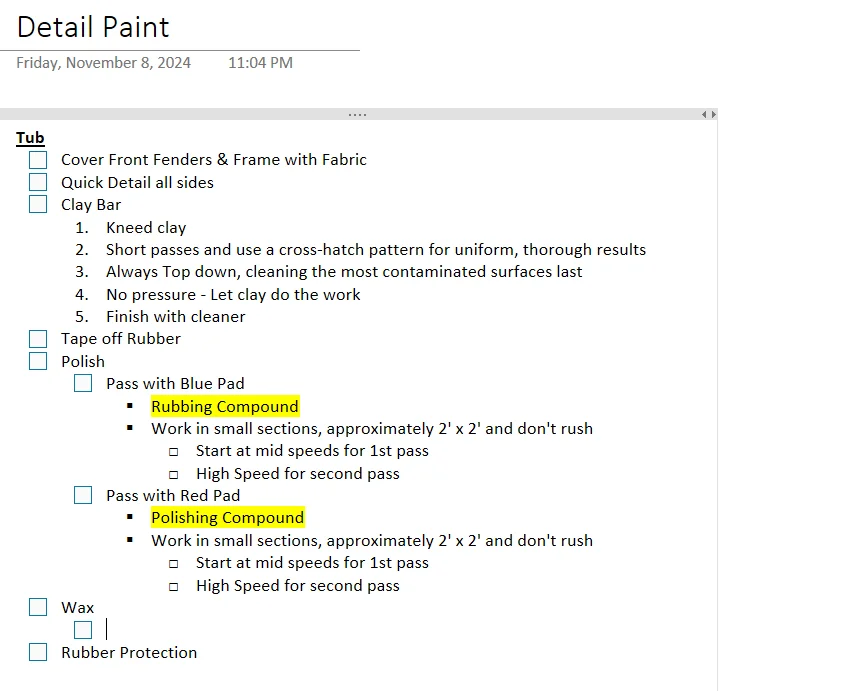

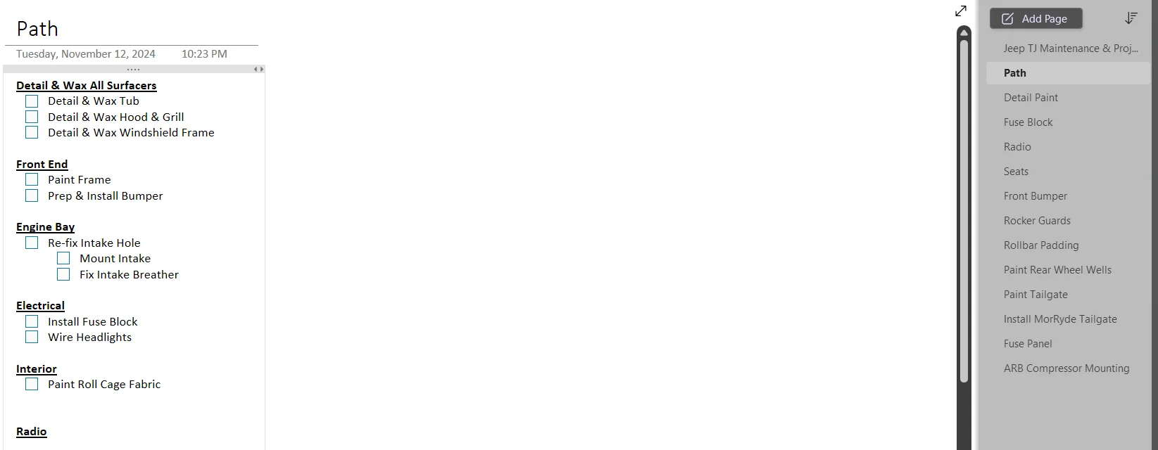

Instead, I'm building a build list instead. Rather than just hitting what makes me happy, I'm trying to lay out a plan...
My priority is the paint because I stripped of all protection when I washed it with dish soap to remove wax and haven't finished detailing...
So that's my focus before I start painting frame and hitting other parts.
Building my plan in OneNote

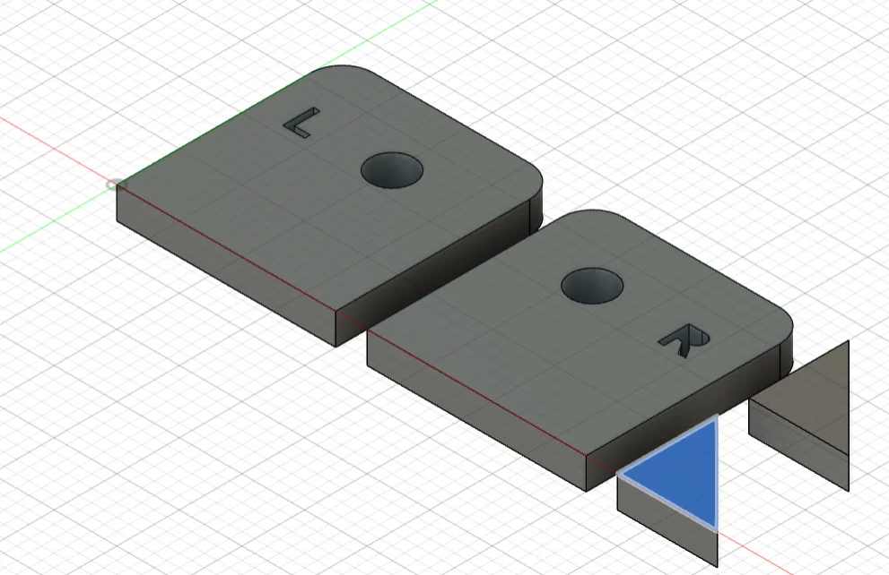

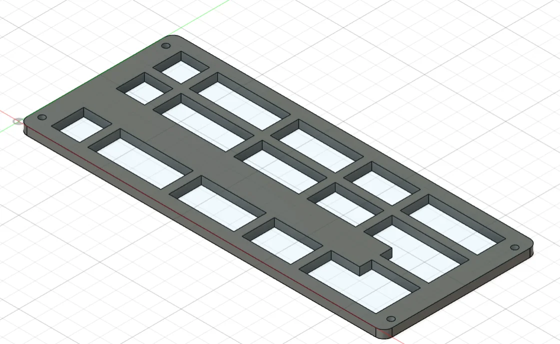

Images of my design:
I'm going to post with @Chris to see if we can upload .dxf files because I can't attach them right now.
Designed in Autodesk Fusion 360.

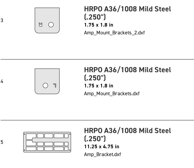

Ordered from Send Cut Send late Sunday evening; parts arrived Friday afternoon. That'll work for me on most/all projects.
Comes vacuum packed:

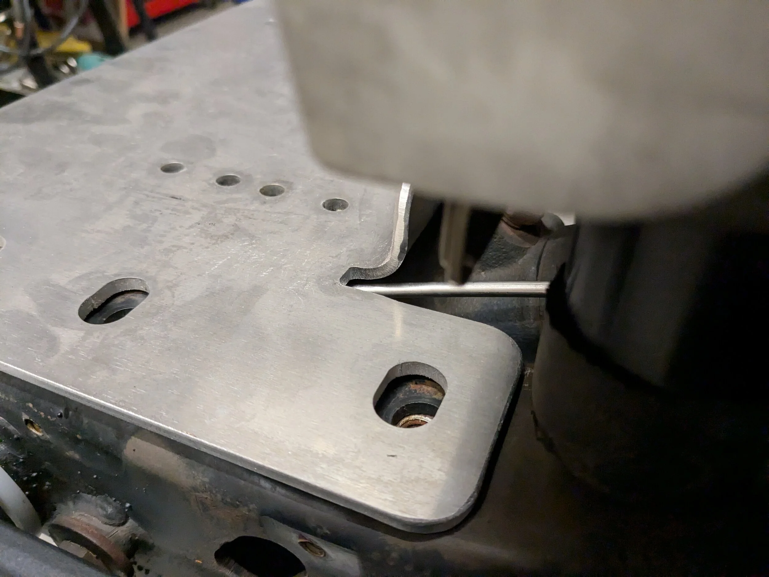

I'm glad I did these reference marks. They came out great:
Pretty happy with how the amp bracket came out:
More residual around the interior cuts than on the perimeter. Should clean up pretty quick with the dremel.
Now that I have the parts, I wish I had included a fillet on these corners (red lines). I can hit them with the dremel too, to round them off.
And, as always with Send Cut Send, you get a snack in every shipment:
I love me some SendCutSend! Hot tip - always use fillets and radii on corners. Sharp corners concentrate strain. Strain = cracks.
Great tip. I should have known better...

I have updated the model with fillets now. So, when I get this installed and can show success, I'll post up the .DXF files (Thanks to @Chris for the update to enable attaching .DXF files!) that will include the fillets.
It does look better with the fillets (y)... But I won't see my box version once its installed under the dash. ;)
