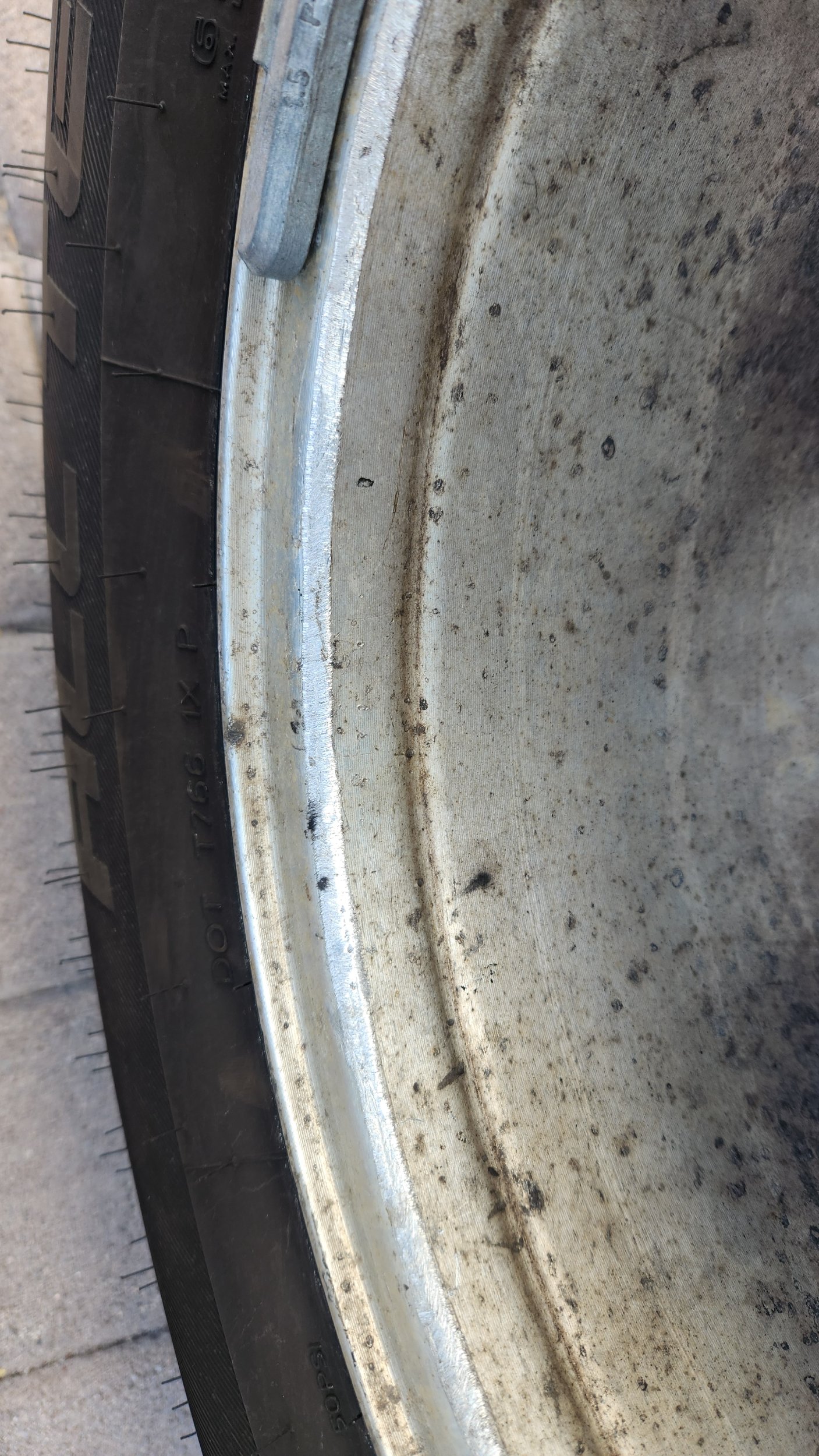

Replacing my shocks today and noticed a ring all the way around the inside of the driver's side wheel, looks like it may be contacting the upper ball joint housing. I can't get it to touch when turning the wheels and I can't get any real play in the joint but it's the only thing close to the wheel right at that spot. It worn shiny all the way around with the wear pattern/lines looking line a back and forth motion. Jeep drives fine, not a hint of death wobble. Stock Ravines with 30" tires.
If the ball joint had been rubbing the lines would go around the wheel. The lines running radially make it seem to me like the wheel has been ground for clearance.
I don't recall seeing that when I installed the wheels a few months ago. I think I'll swap front to rear and see if anything happens.
I would put it up on stands and spin the tire by hand while turning the steering left and right to see what is toughing the rim. My 1st suspect is something is making contact while the wheel is turned. Not able to tell from the photo if you have any aftermarket steering or any other object getting in the way.

The wheels I bought used and had new tires put on them. I installed them on the Jeep myself and didn't recall any marks on the wheel at that time but it's possible I missed it. Also the mark is clean and shiny. I have 2,000 miles on it since then. I'm going to rotate the wheels/tires today and see what happens. It does seem strange how the marks are not consistent with marks being made in rotation like johny jeep pointed out, to make those marks it would seem like there would have to be a rapid back and forth motion.
You have it correct. Someone was trying to build in a suicide surprise by grinding away the rim.

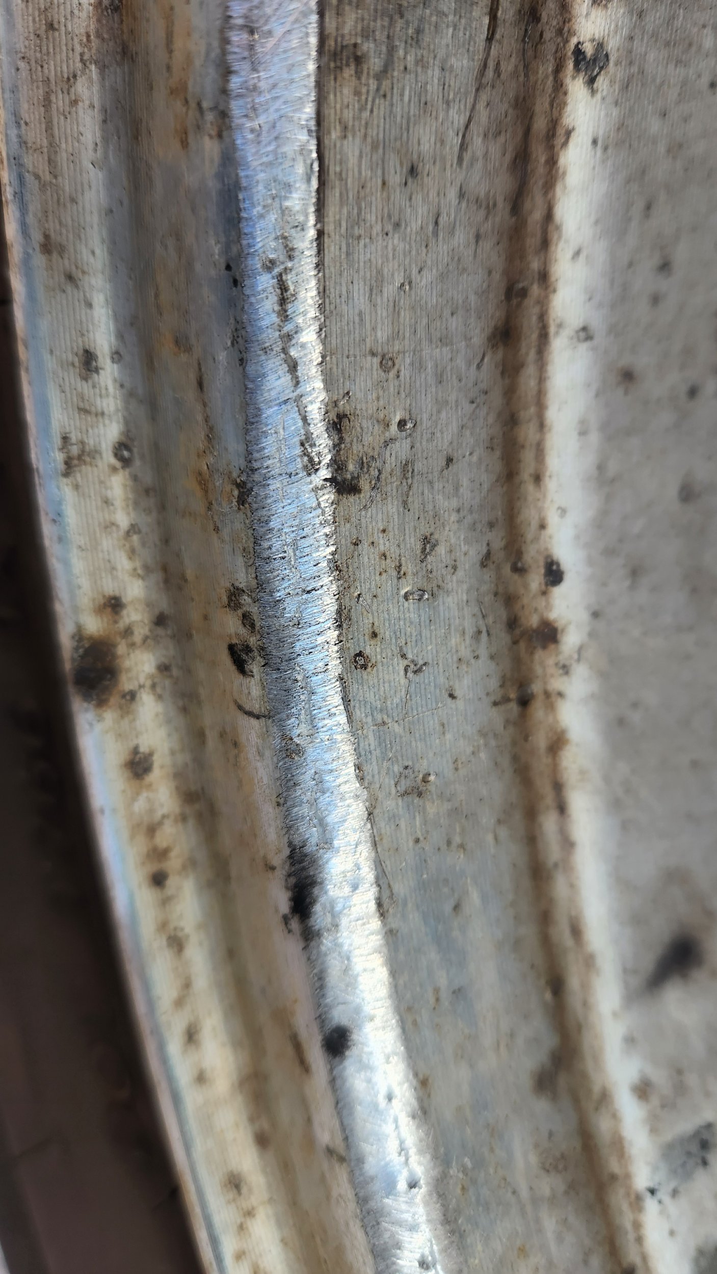

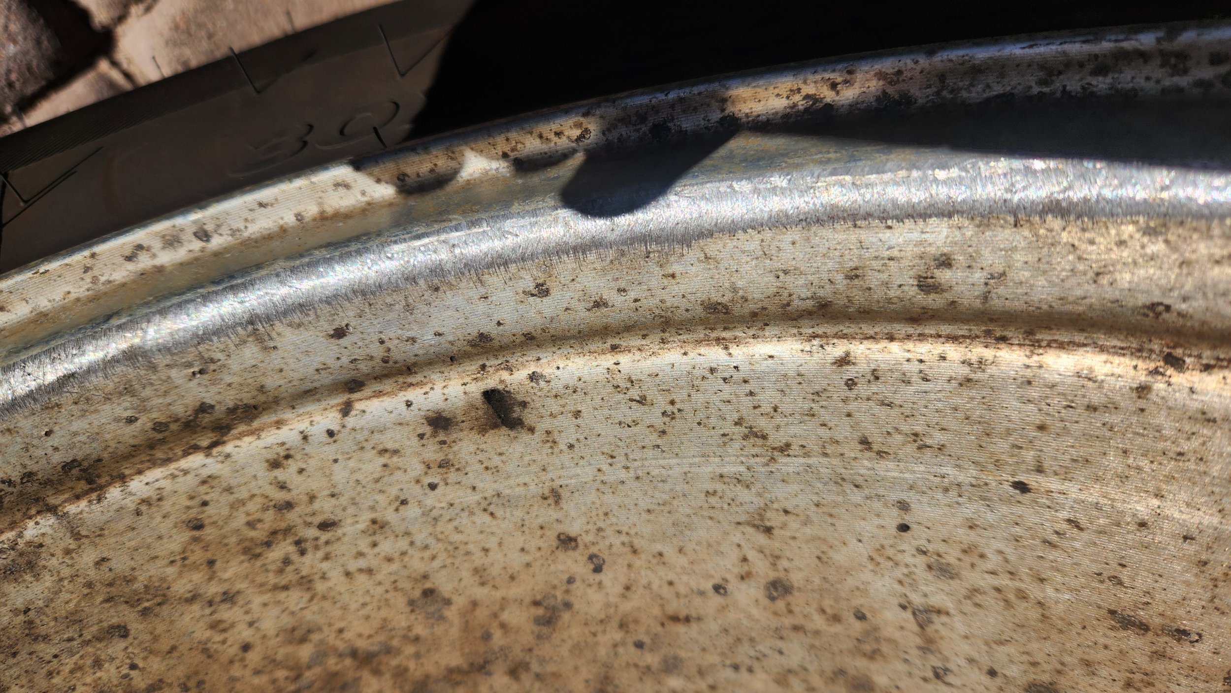

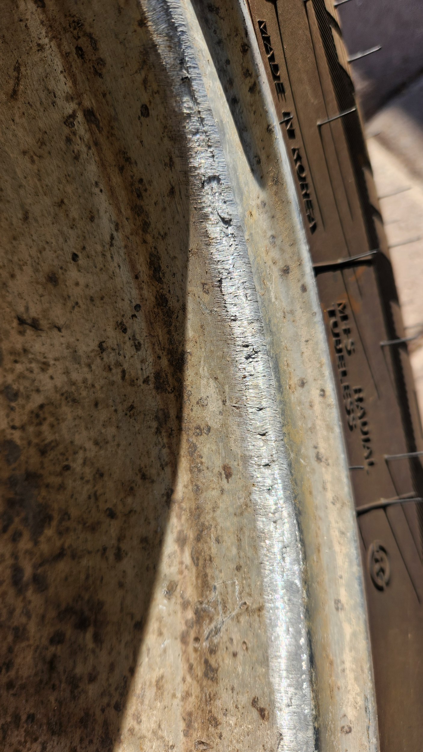

Did the rotation and took more pics of the damaged wheel, very strange. Most of it looks like barely any material was removed but one section has some pitting. These Ravines came off a TJ in Flagstaff 2 years ago that had been sitting a long time, the tires were from 1993! I bought them already removed from the TJ and stacked in someones garage. Somebody probably tried to clean up something on that edge like corrosion and if that's the case I never saw it when I bought them.
I suppose I need to look for another nice Ravine if I want to keep doing 5 tire rotations, not sure I trust that one. I'm kind of surprised Discount Tire didn't mention it when they mounted the new tires.
