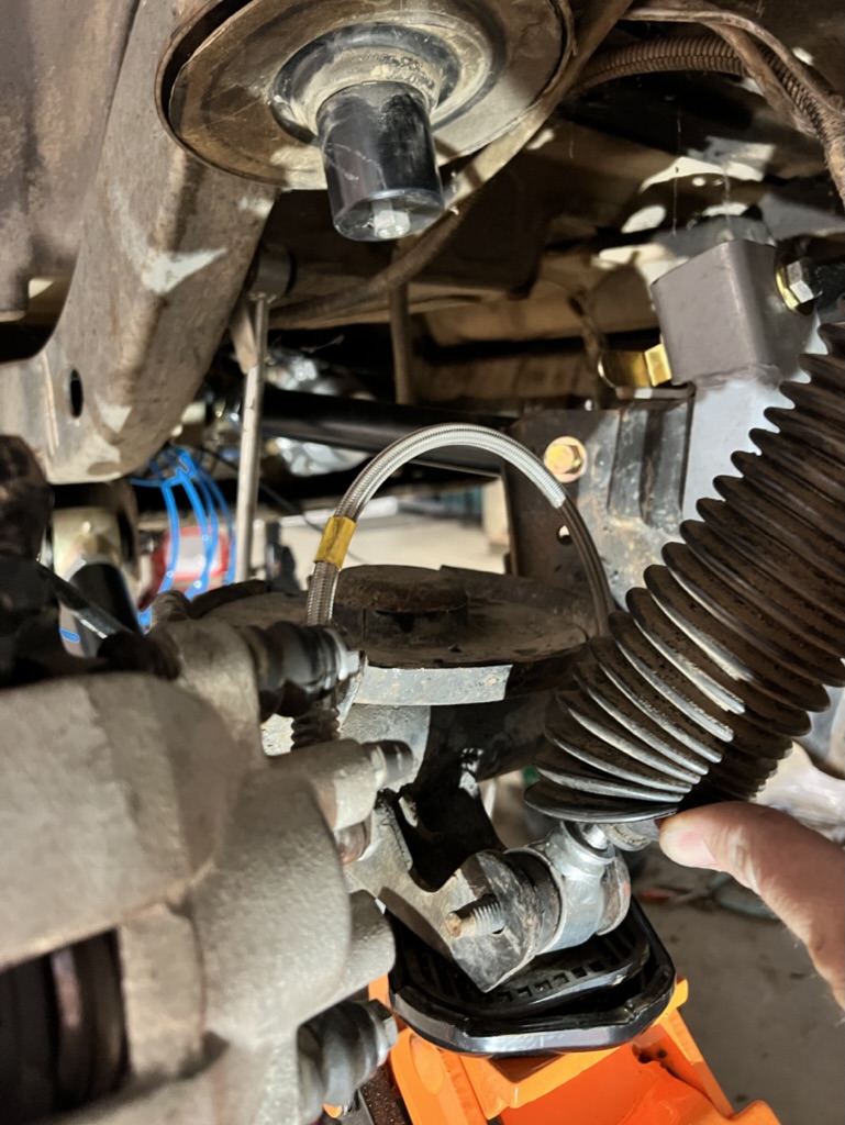

Some more detail on the rear bumps, because I feel like I'm still missing something after thinking about it all night:
I'm missing the jounce cup, but fitted in an extension in it's place, just for demonstration...so ignore the extension mounted to the upper perch.
With the old RE shocks that have a compressed length of 14.8", I'm still struggling with the idea that I'd have to come up with almost 6" of bump below the cup. Pic 2 shows I'm compressed to about 1/4" of shock shaft showing.
I'm still waiting on my Rancho 5000x to come in, but they have a compressed length of 15", so I'm even worse-off there.
I've cruised so many threads on setting bump and cycling suspension, and I'm still at a loss. Any ideas?

With the shock compressed like the second picture, do you have tire clearance?
You are making the mistake of thinking more than doing. Bumps stops are definitely an "is-what-it-is" kind of thing - but only after everything else is dialed in.
Wait until you receive the shocks you are actually going to use. Get those installed, and then test your clearence by fully cycling the suspension both at full stuff, and also at full articulation. You will find that your tire clearence is different between full stuff and full articulation. You can also better determine if the shocks you selected will work. Once you are comfortable with the clearance - then set your bump stops.
Try not to sweat it too much. It's a pain but definitely a process which you must go through to get things right.

This is helpful...calming, even. I think the thing that's getting to me is that it's not so much a tire clearance issue but a shock issue. These shocks I have now are shorter than what's planned for, and even still it's looking like it's calling for that much bump.
I can understand over thinking, for sure. I'm just blown away when I see guys say they're running like 3" or 4" of bump extension for 35s on a 4" lift, and then I measure and see what I see.

One thing to keep in mind - although it may not be so calming :rolleyes: - if the shocks you chose do not allow the tire to tuck all the way up, your shocks are too long (meaning the compressed length is too long for your setup).
And only a few solutios there: 1) New, shorter (meaning properly sized) shocks, 2) rebuild your shock mounts to allow for the longer shock, or 3) Fodeez.
(Three guesses as to which one I would recommend...:))

Yeah, I've arrived at that conclusion. I figure I can run the current RE shocks for a bit if I need to. Then outboard down the road, 37s, 40s, etc.

One additional thought on your comment: 4" lift alone is not enought to run 35's properly on a TJ. To do so you also need a 1" or 1.25" body lift, or high-line fenders front and rear. This of course also impacts the necessary bump stops. So don't get hung up too much on what you see guys sayin'...
