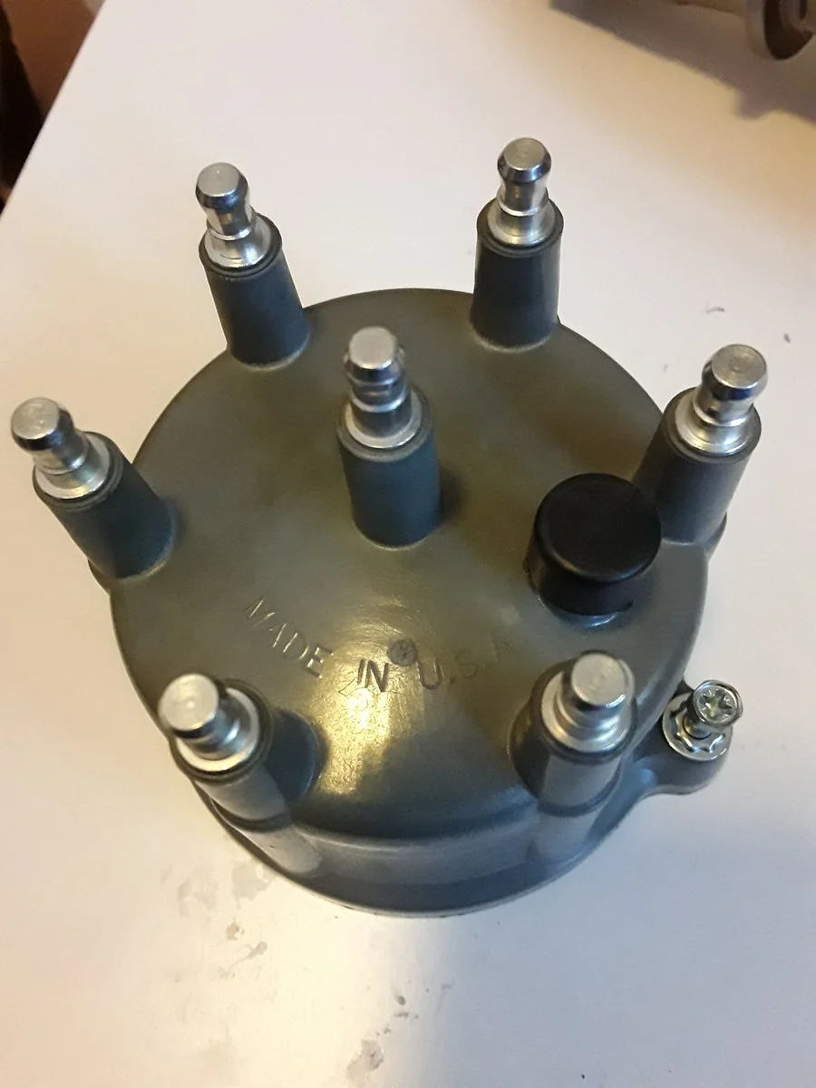

The cap doesn't have the "1" on the top marking the cylinder number and it's gray and says "Made in USA".

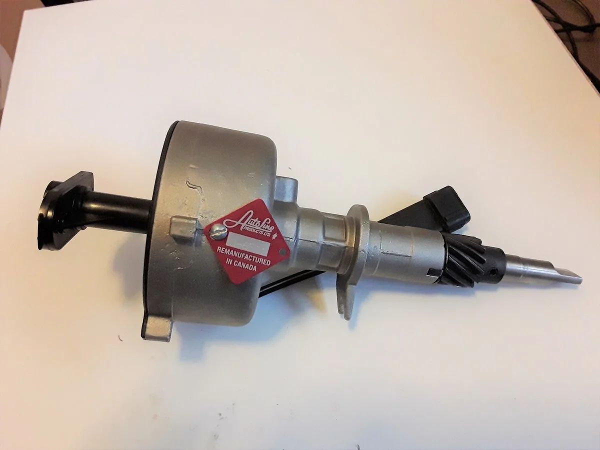

Attached to their distributor casting is a little red metal tag with "remanufactured in Canada" and a part number engraved on it. Nice touch; probably the first thing to go when they get acquired by some global conglomerate.

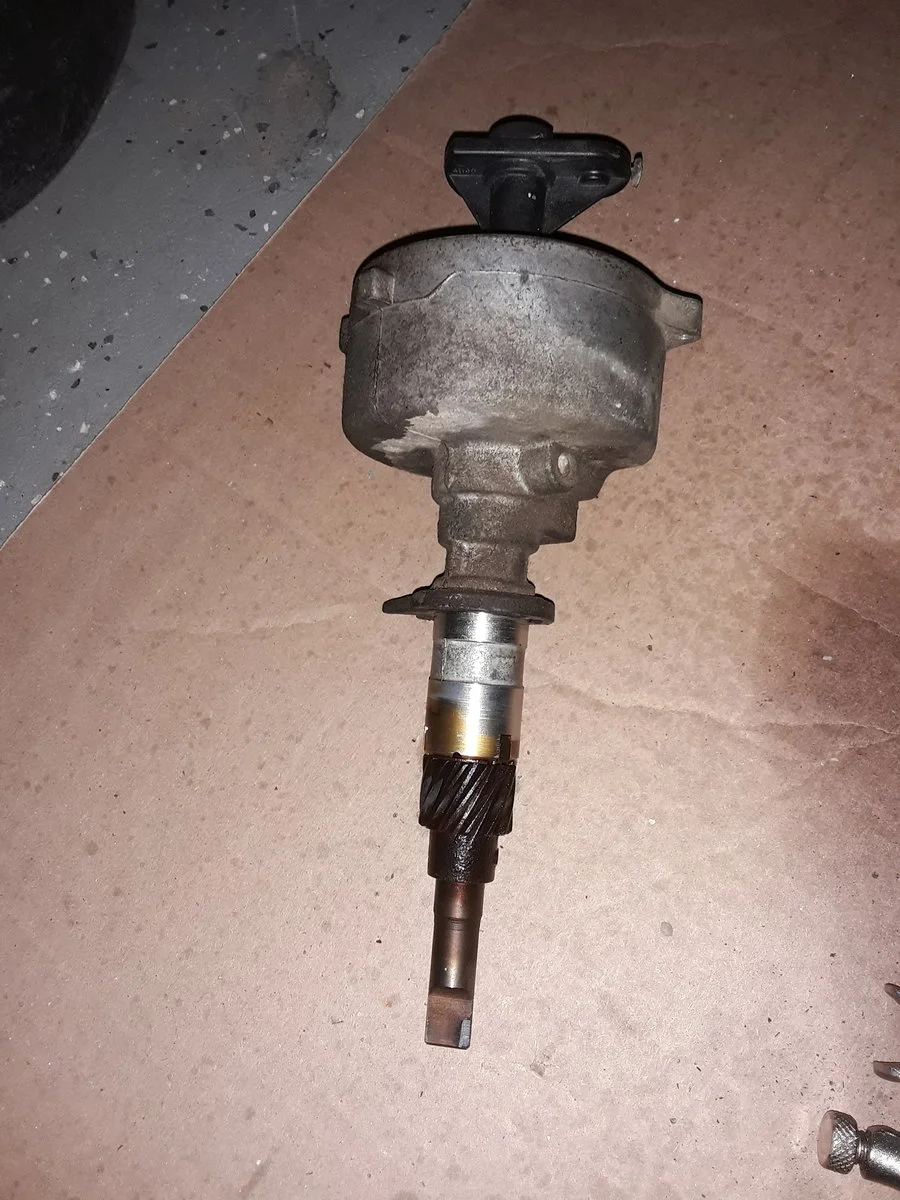

The gear has no discernible wear which leads me to believe it's new. The side to side play is negligible. I'm not sure what to make of the lower part of the casting that sits inside the block - it has a rough cast surface whereas mine seems to have been machined.
I don't see how that could impact the reliability at all but it makes me question the "OEM castings only". I suppose maybe it gets roughed up when they sandblast it as part of their prep process. There's also some slight differences in the casting lines - if you look near the top, the upper line takes more of a diagonal slope downward around that tap vs a more abrupt step in the remanufactured unit.

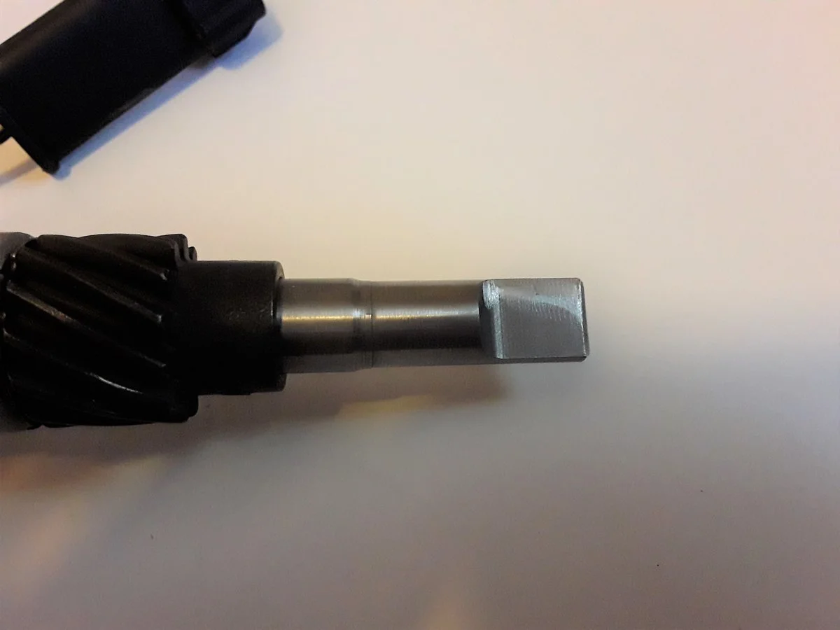

One of the few signs of use that it has is the little wear spot on the face of the shaft tab that drives the oil pump. The shaft looks identical to the one on mine.

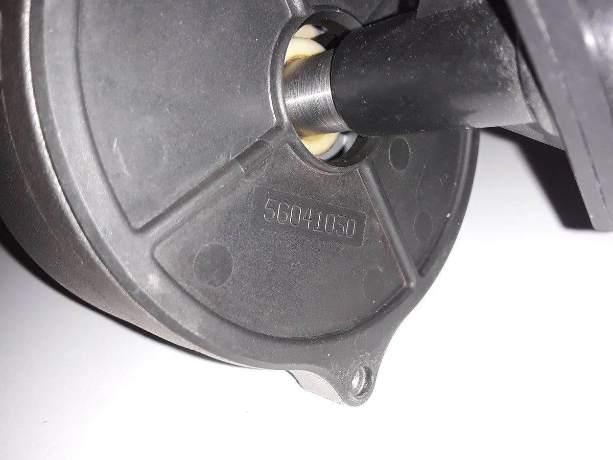

The camshaft position sensor appears the be a factory unit. It has the Mopar number on it and looks identical to the one in mine. The white wire running to the connector is slightly discolored, so it appears to be used. No telling how old it is or how many miles are on it. I had planned all along to keep mine and swap it into whatever distributor I ran instead of an aftermarket sensor, but since it's factory I'm on the fence about it. I wish I could keep both, but I have to send one back in my core to get my $75 refunded.
