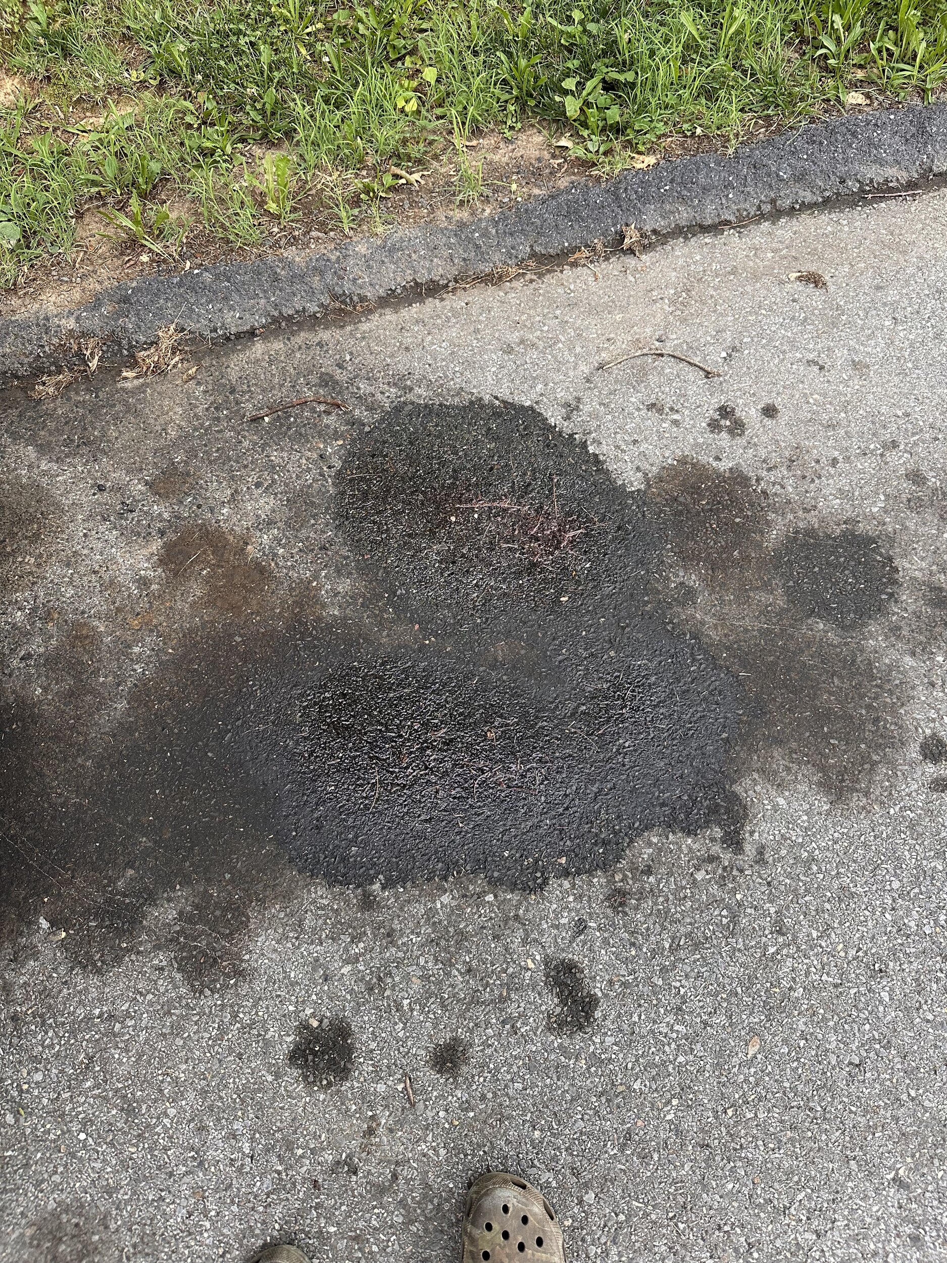

This may have been asked before or posted about but I’m going to start a fresh thread… when my Jeep has been sitting for a couple days after not driving it I come home to just a massive tranny fluid puddle underneath right under the skid plate, I’ve already cleaned it up once but since I haven’t had time to deal with it I have just been refilling my fluid level as needed. Well I plan to dig in to it these coming weeks and was wondering if anyone could maybe point me in a certain direction. Was going to start with taking the skid plate off and probably dropping the pan and changing out the pan gasket. Is there anything else I can look at while I’m down there?

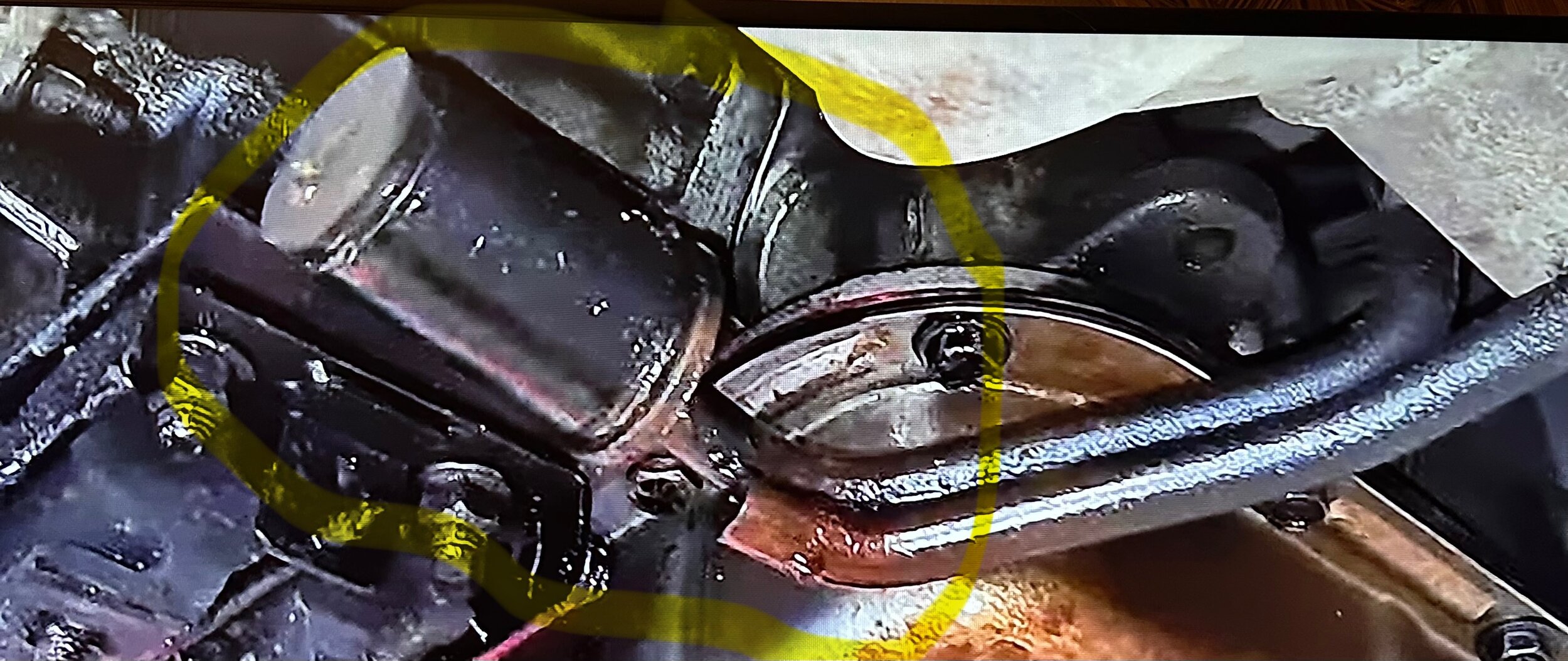

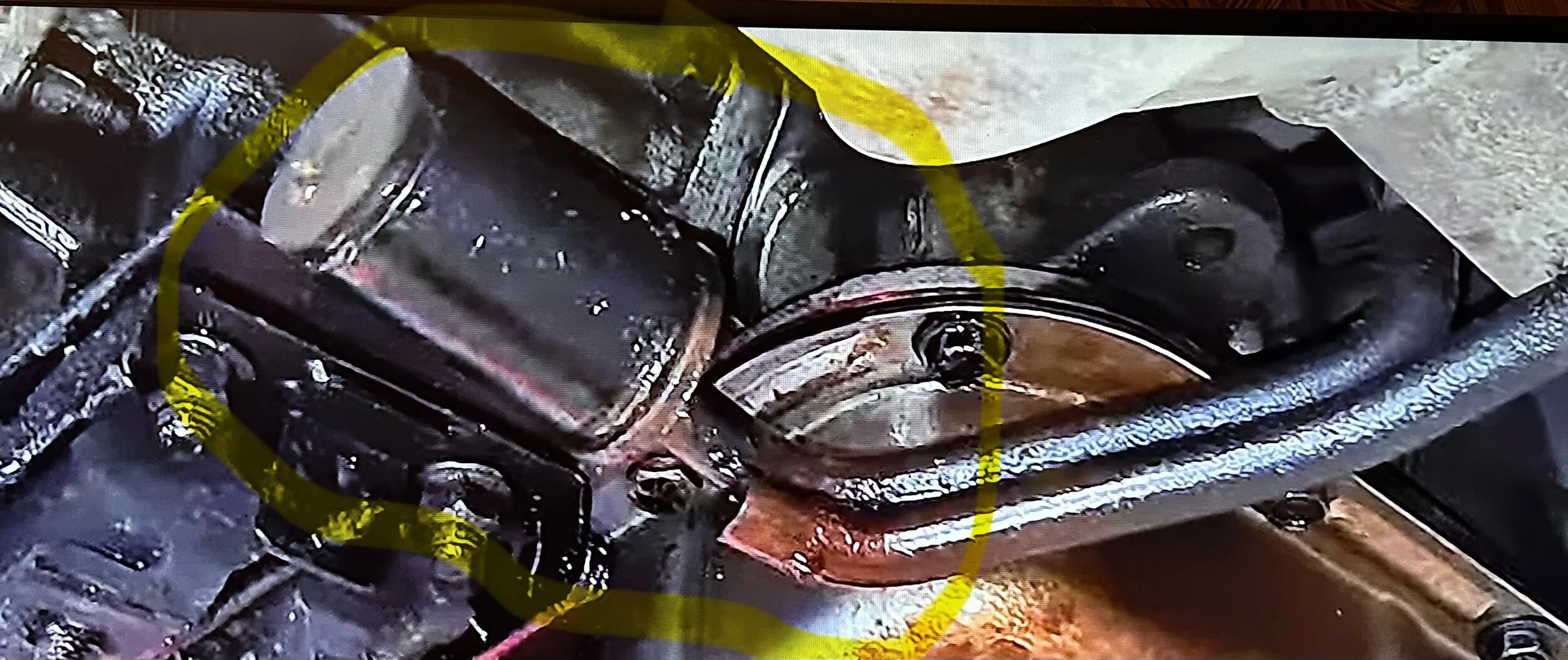

Could it be leaking from this black cylinder? I checked the gear selector and dipstick and everything looks dry there but earlier today noticed a tiny drip coming off the skid plate right below this part?
I guess we’re just gonna do the guessing thing.
I mean nothing is impossible in the naked city, but that black cylinder is just a rubber bushing that your exhaust hangar slides into.
Well I have paper towels everywhere you said and they’re dry. The only spot that is wet is coming off that bushing. So yeah this quite literally is a guessing game. Sorry I’m not very familiar with this stuff and just trying to gauge what the drip could be coming from off that. 👍🏻
