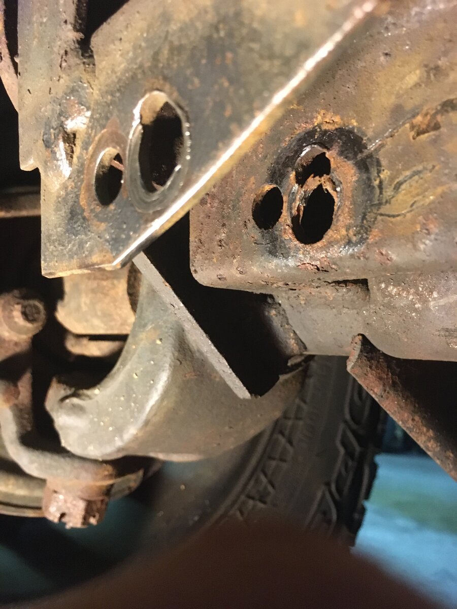

I actually have 3 holes in my bracket from the PO! Does anybody know which one is the original? I want to install an adjustable too.

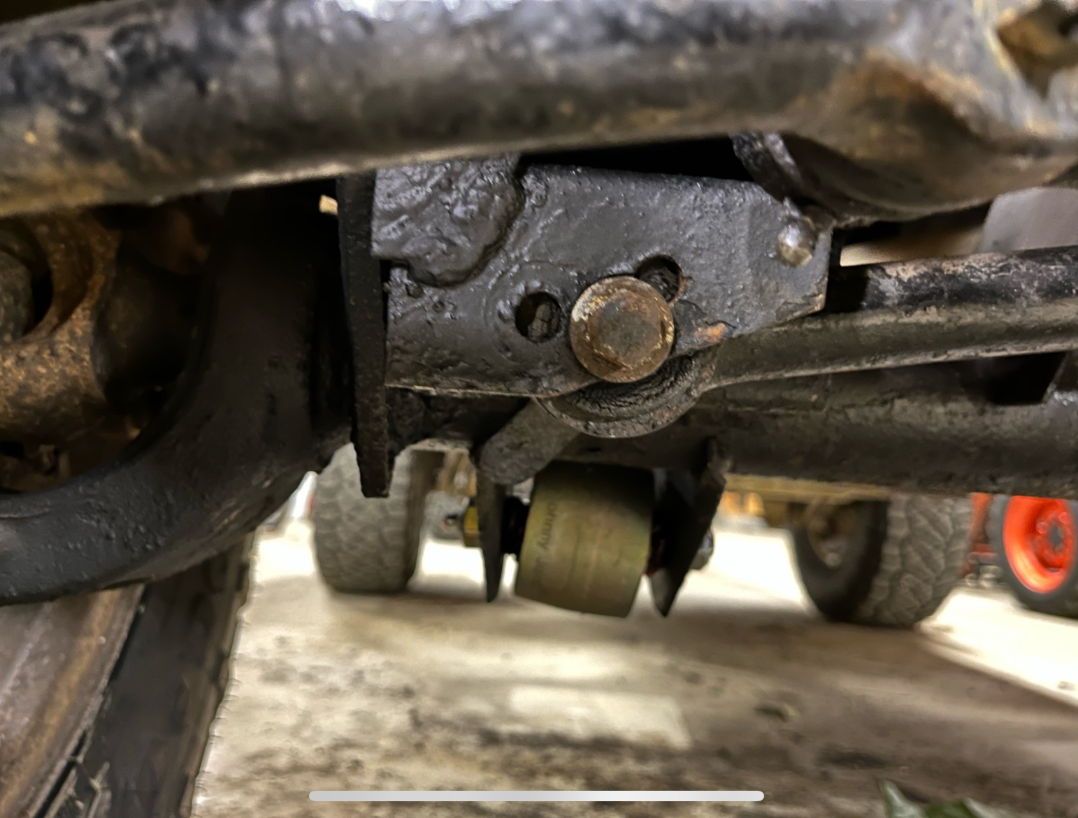

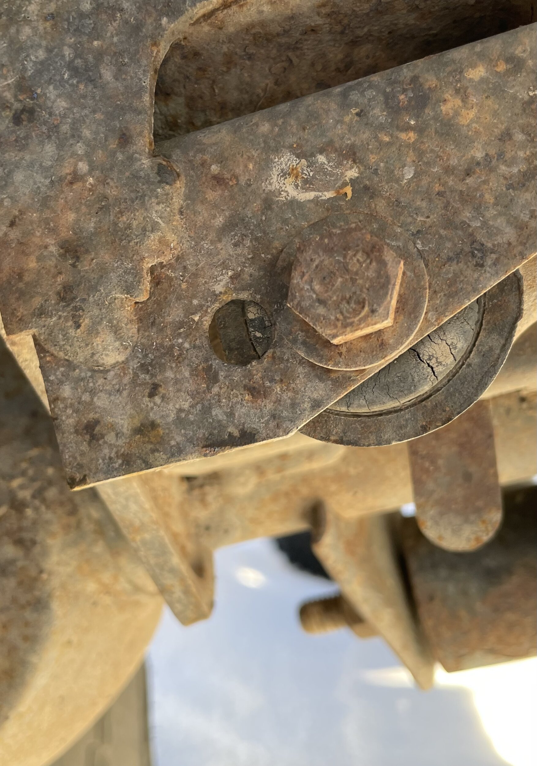

Drilled properly as in just NOT looking like this? (Not my pic, found on another thread)

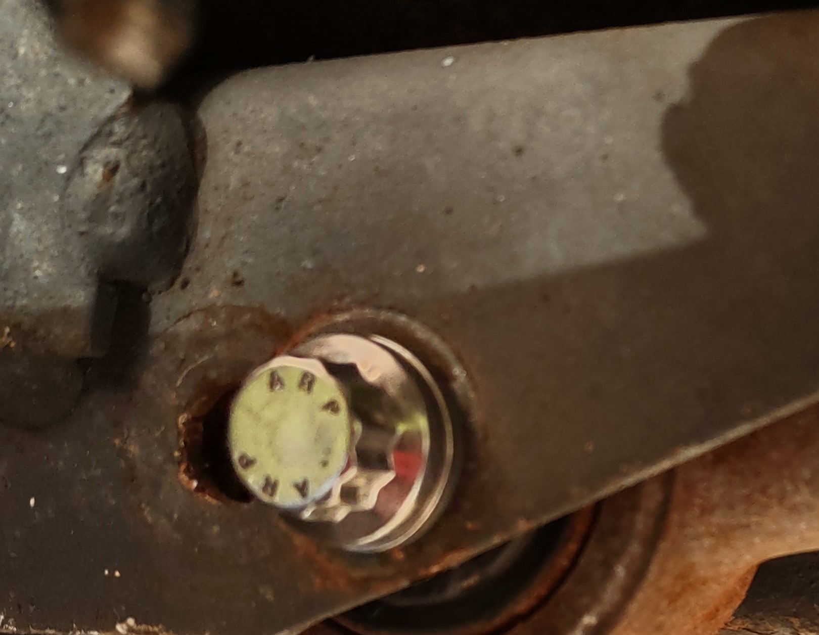

This is mine, not really much help without taking off the TB to look but looks good from what you can see
Good to know I don’t have to worry about the holes.
