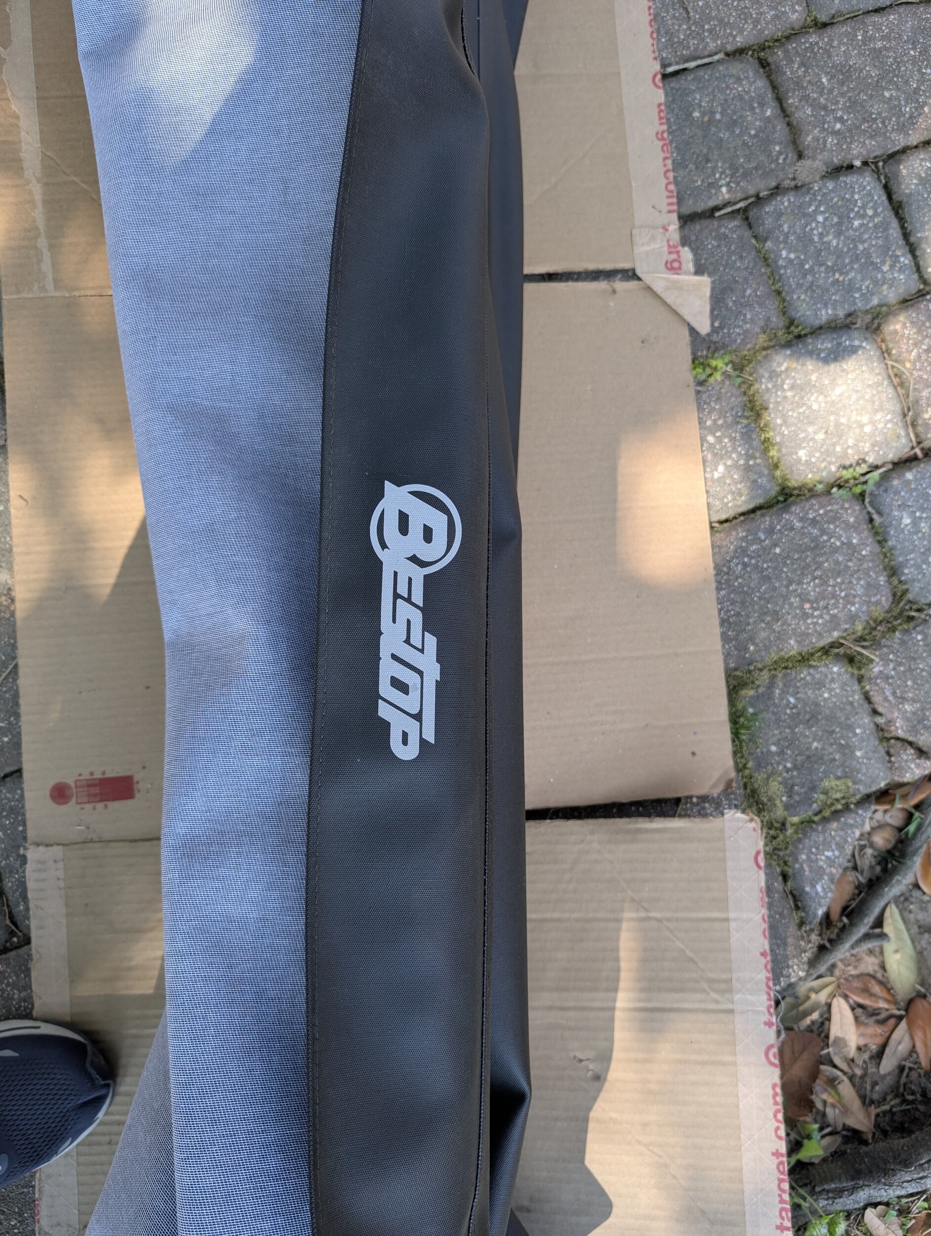

Has anyone been successful getting the reflective logo off a new Bestop soft top without damaging it?

I got it off.
Used a product I got off Amazon. I can find it if you’d like.
It was a sizable bottle of which I used maybe an ounce with a soft toothbrush

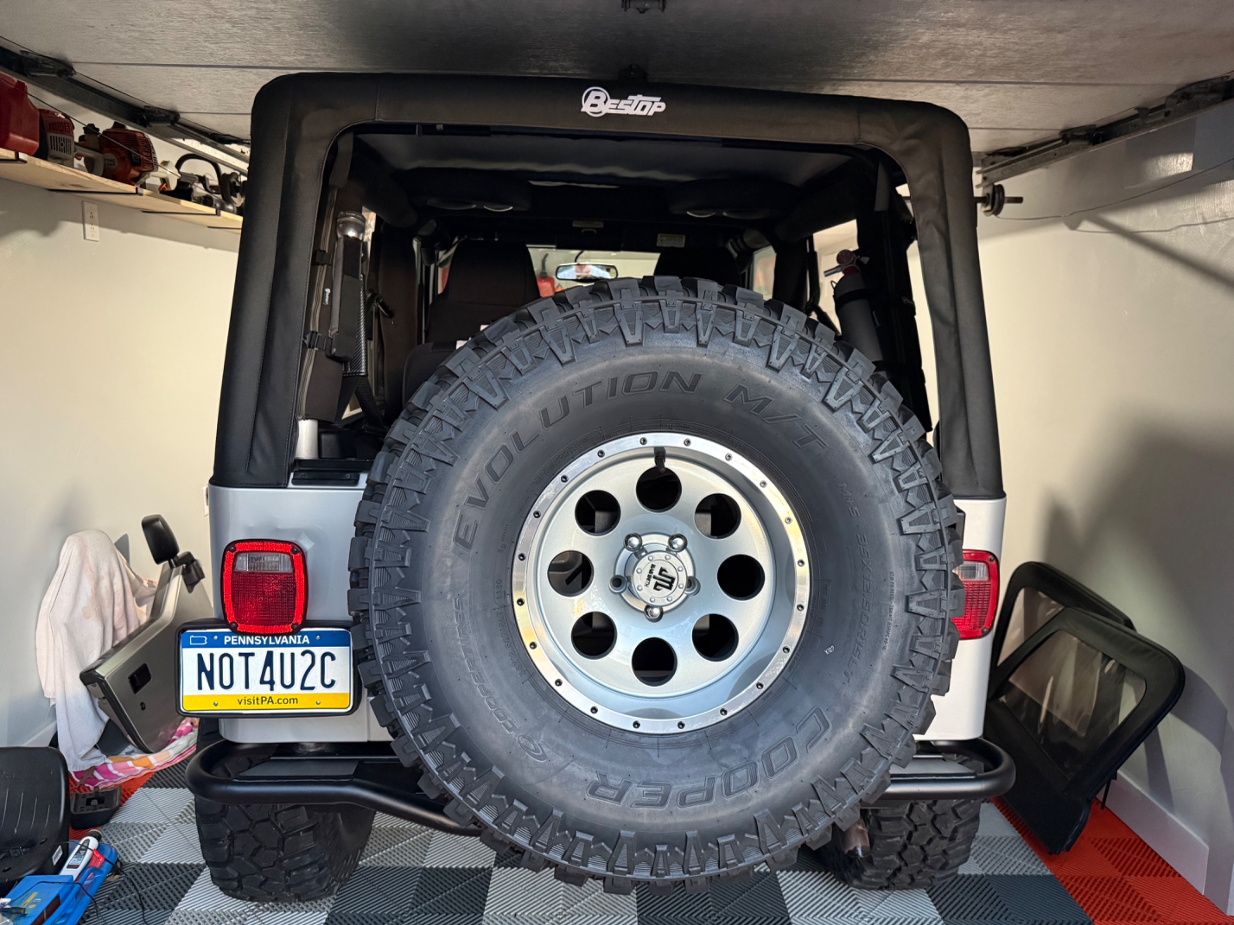

Did you had fitment issues with the new top.?
No issues, very snug, about 1-1.5 hrs to do it. I’ll snap pics tomorrow

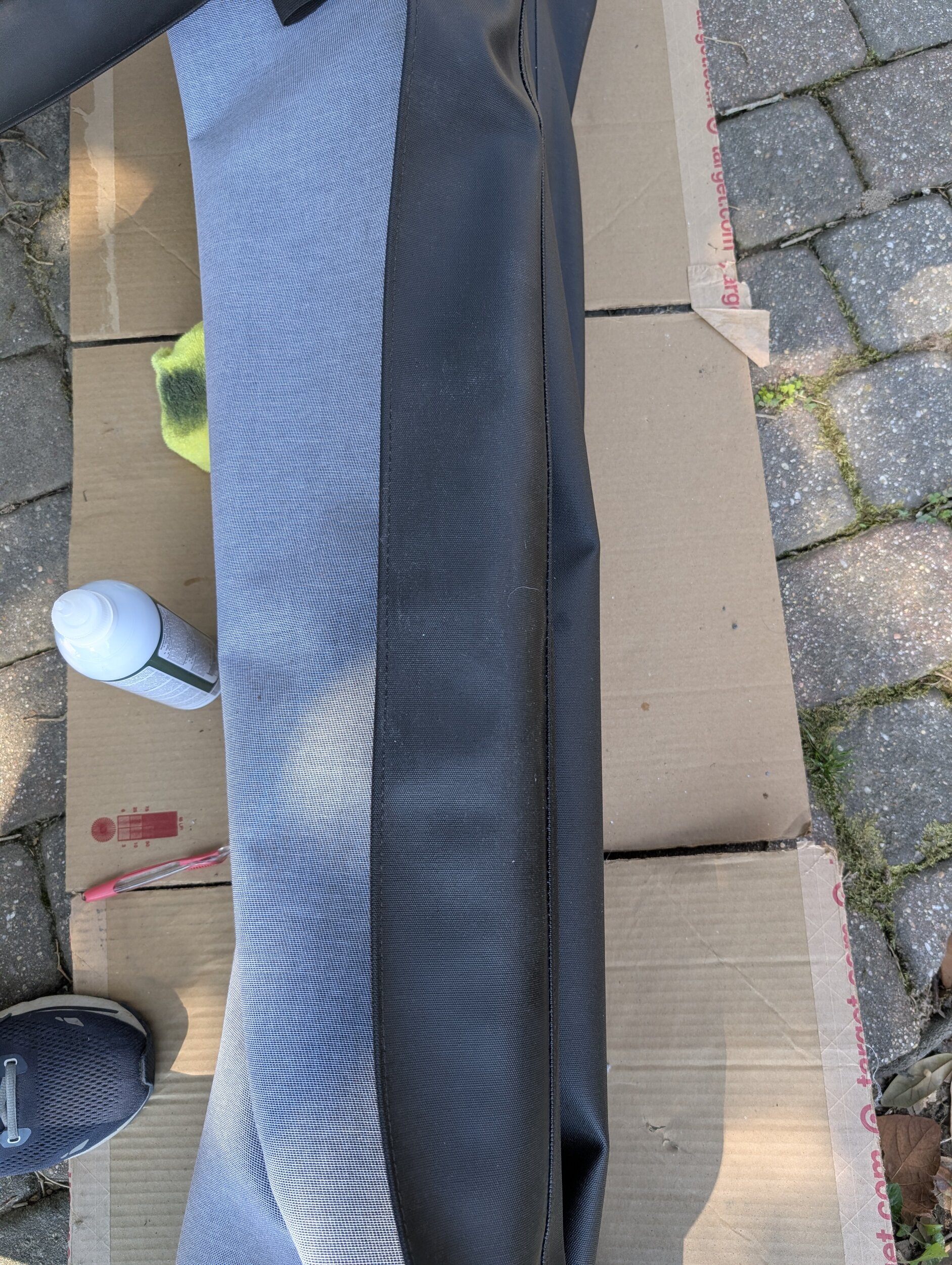

It was a few years ago so going from memory...
I hadn't installed the top deck yet so I placed it on a towel and propped up the sides to control run-off.
Doused it well and let it sit a bit. Used a soft stiffness tooth brush to gently agitate. Wiped clean and repeated.
Rinsed well dried and done.
I really appreciate the info. I'm much happier after getting this done.View attachment 652621View attachment 652622
