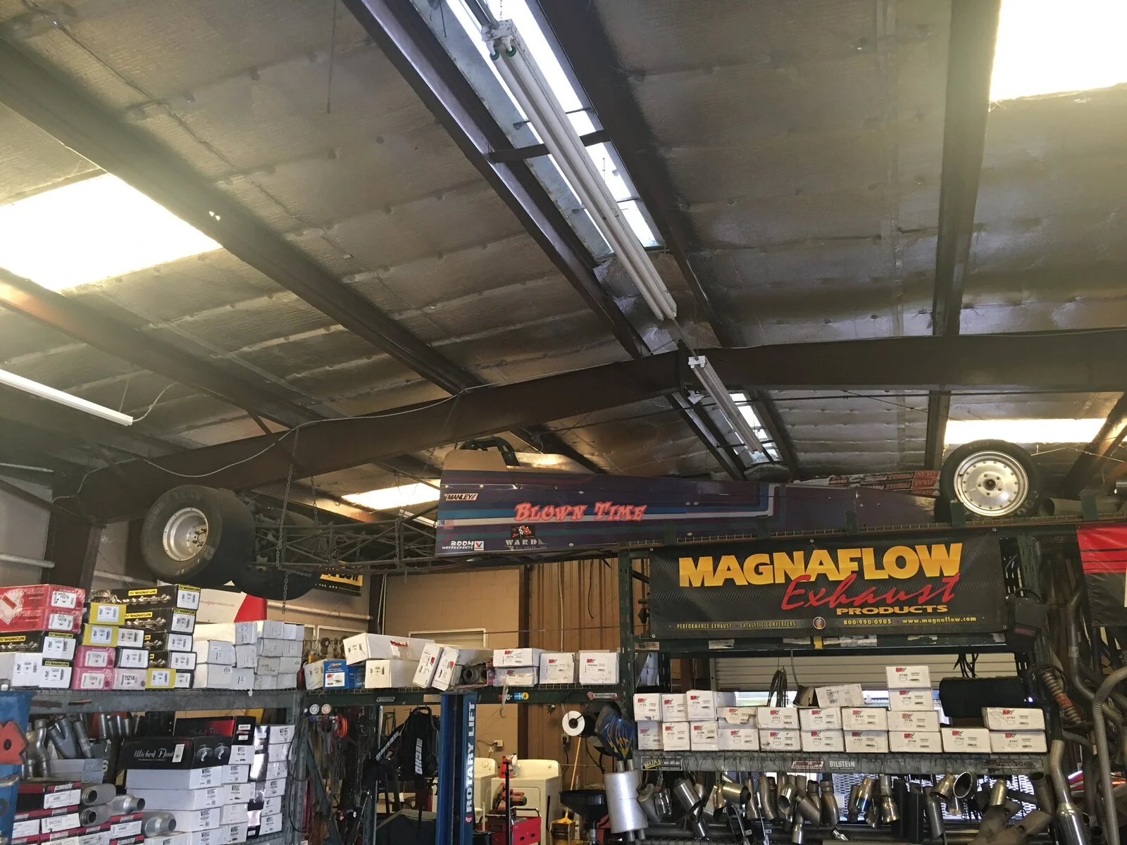

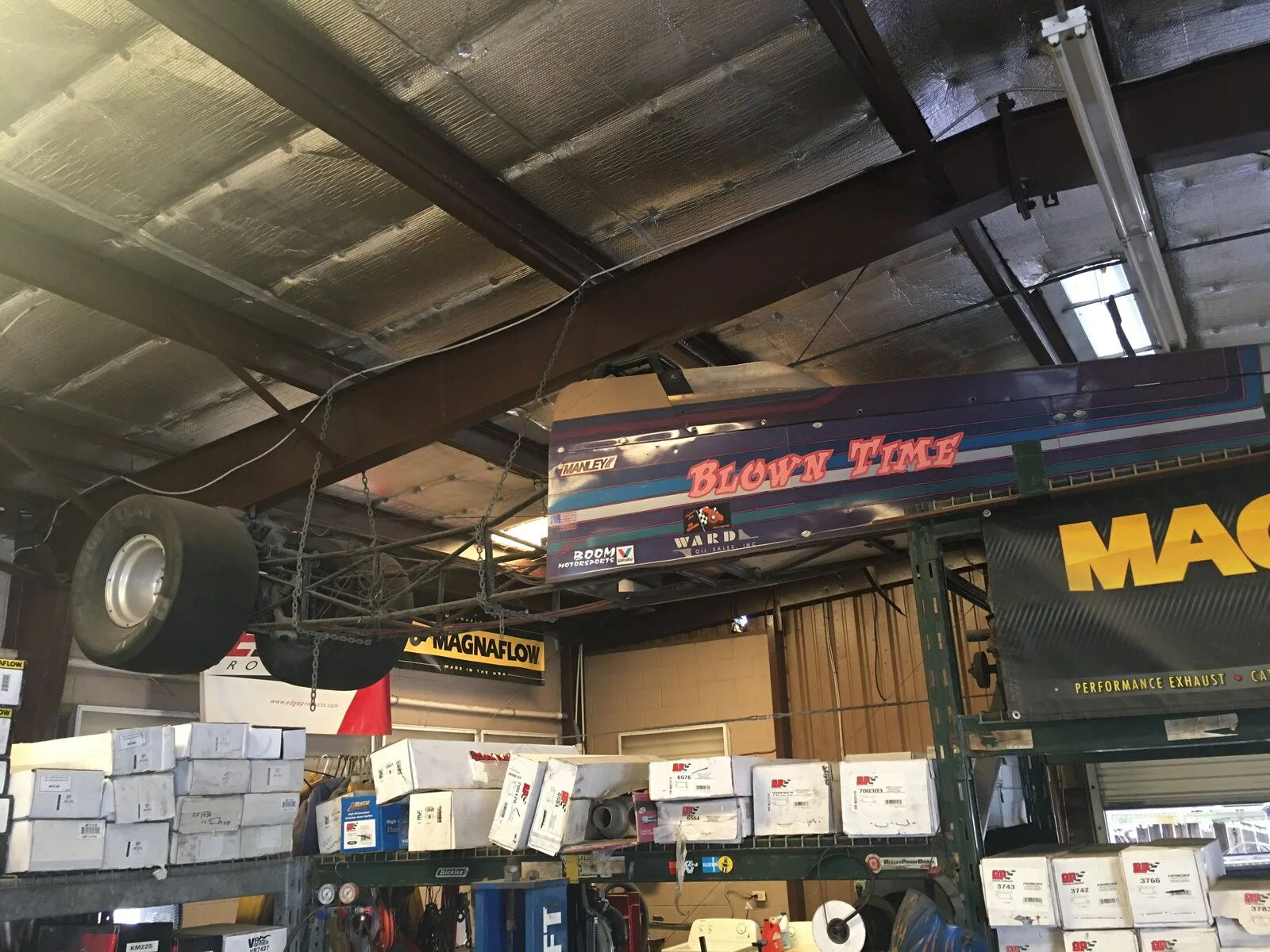

Never crossed my mind. Both chutes are still packed. Retired for life. We often talk about a street deal with a twin turbo LS but now it doesn't cost me money anymore.
