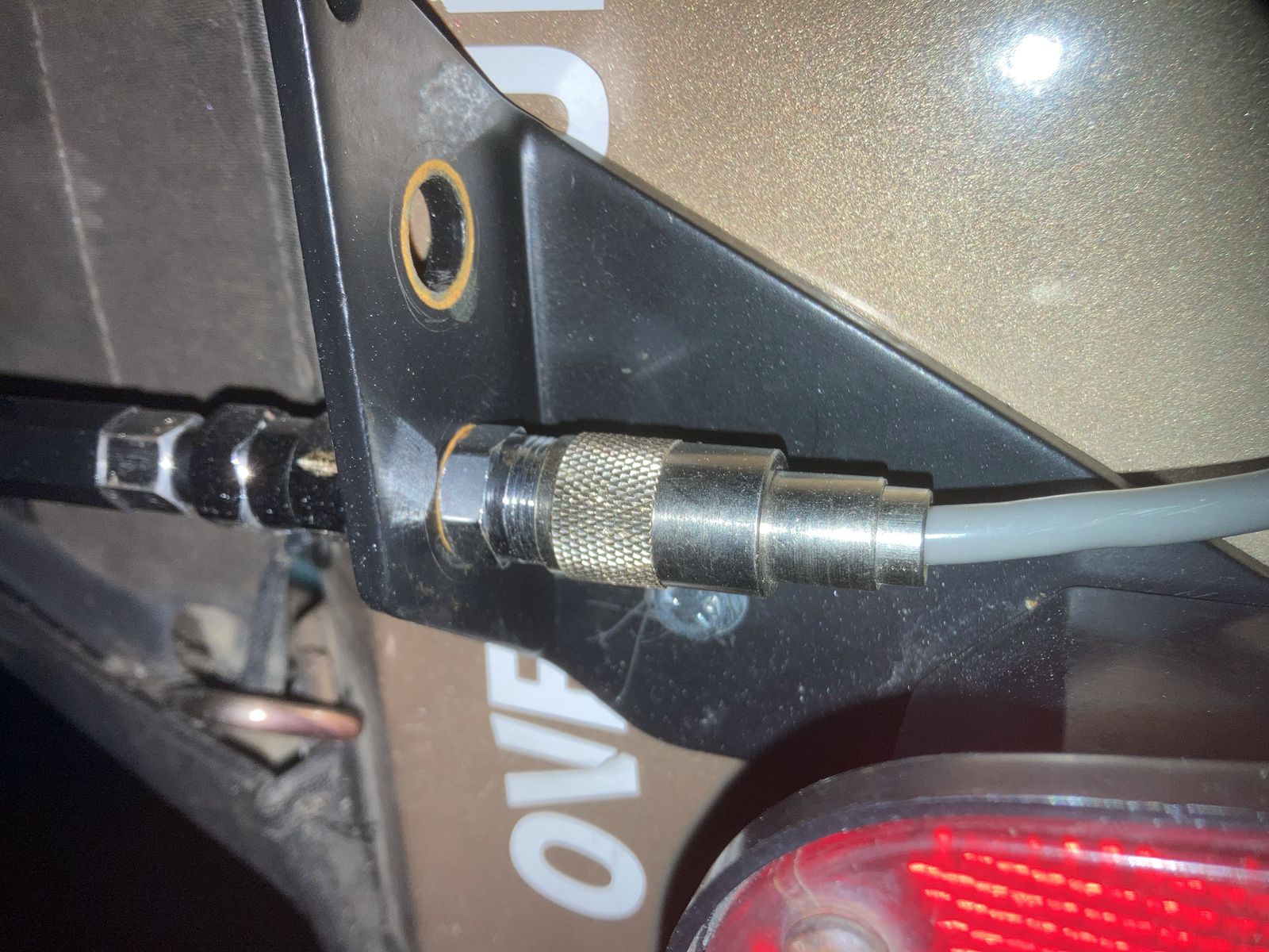

Post that pic of the underside of your antenna mount!
I sanded the paint off before connected the stud to the bracket
IDK why its sideways
