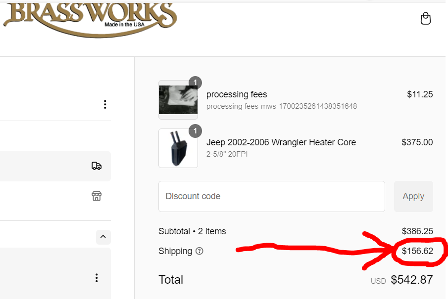

Sorry for resurrecting this olde thread but the more recent heater core thread says I have insufficient privileges to post. My heater core popped yesterday and I was in the process of biting the bullet on the new thick 3-core 20-fpi Brassworks but then in checkout I saw shipping was $156. I live in Maryland. Is this normal?
Looks like you might be getting charged the radiator shipping cost?
https://www.thebrassworks.net/blogs...ing-cost-guide-for-radiators-and-heater-cores
Seems pretty steep for shipping costs. Guess they are pumping up shipping costs to keep the perceived cost of the heater core/radiator lower than they really are.
I'd imagine it's a quality unit but I wouldn't spend that much.
Yup, I called and they fixed it. It was still $40 bucks though. Order place 1/2/25, so we're at 6 weeks 4 days since the order was placed. Their lead time estimate says 6-8 weeks before shipping, so sometime in the next 10 days it should be on its way. Just in time for spring.
