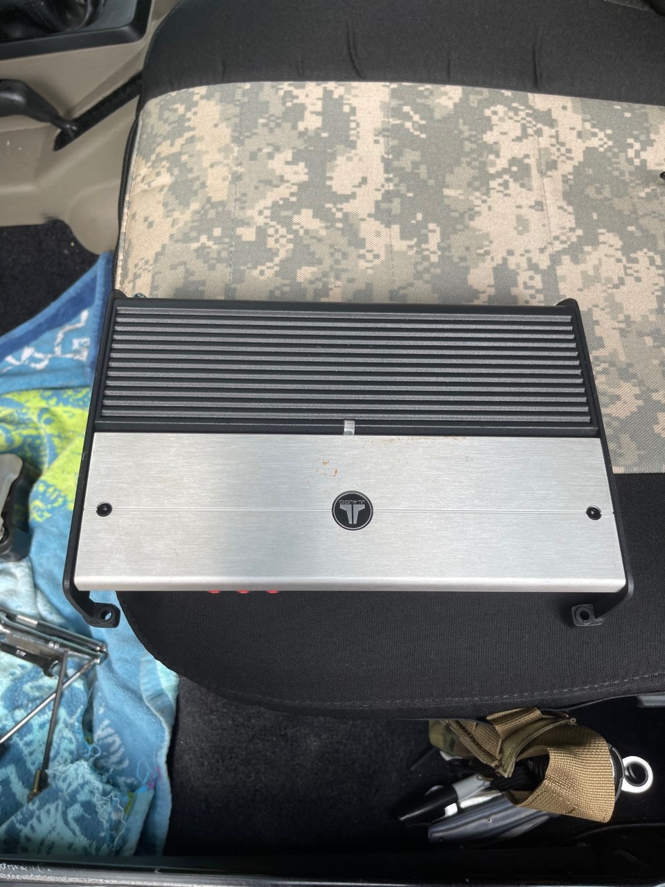

After some research I decided to go with a smaller foot print 5 channel sub. I really wanted the Helix amp that @Chris has in his ride, but it was a little more than I wanted to spend.
So, I opted for this bad boy from Crutchfiled.
https://www.crutchfield.com/p_13698606/JL-Audio-XD700-5v2.html?tp=35808
Even though these new class-D amps don't generate as much heat as a A/B amp, JL strongly recommended NOT mounting it upside down.

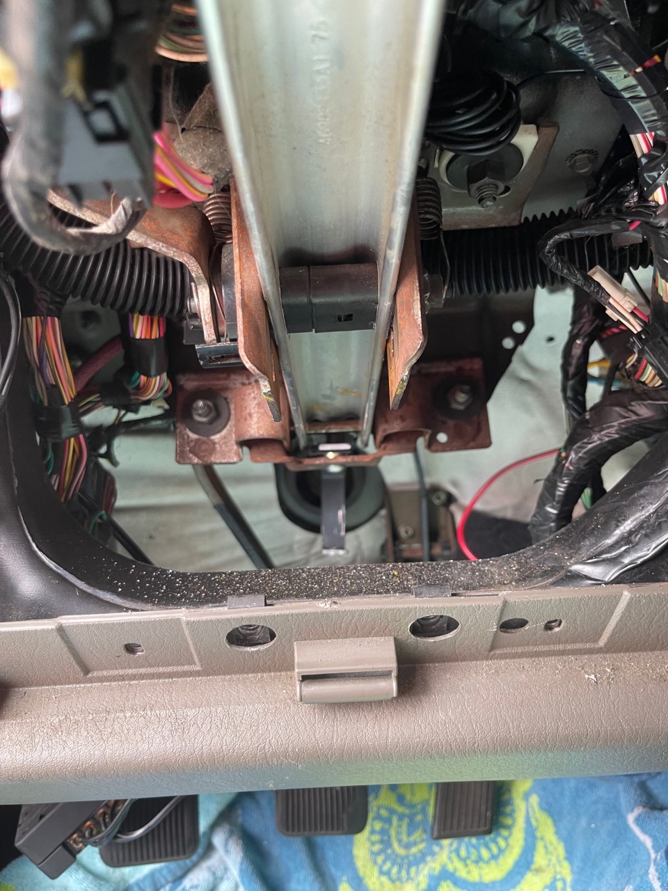

I removed the lower kick panel from under the steering column and started thinking about how I wanted to go about mounting the amp.
I was originally going to make a bracket and hang it off the steering column like everyone else has been doing, but then I would have to space it down to allow for proper air flow.

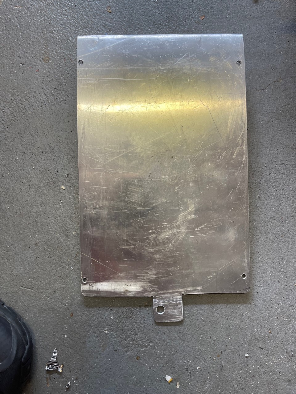

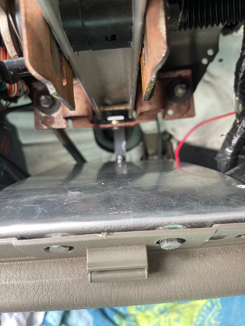

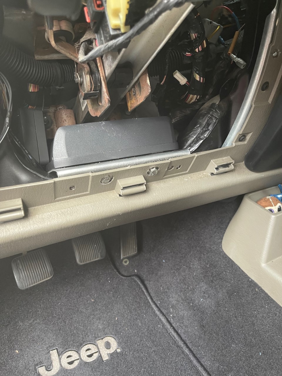

Instead I decided to make a shelf where I could actually slide the amp in.
I have a piece of aluminum lying and some steel lying around so I came up with this idea.
Unfortunatley I don't have access to a sheet metal brake so I had to bend a lip using a vise

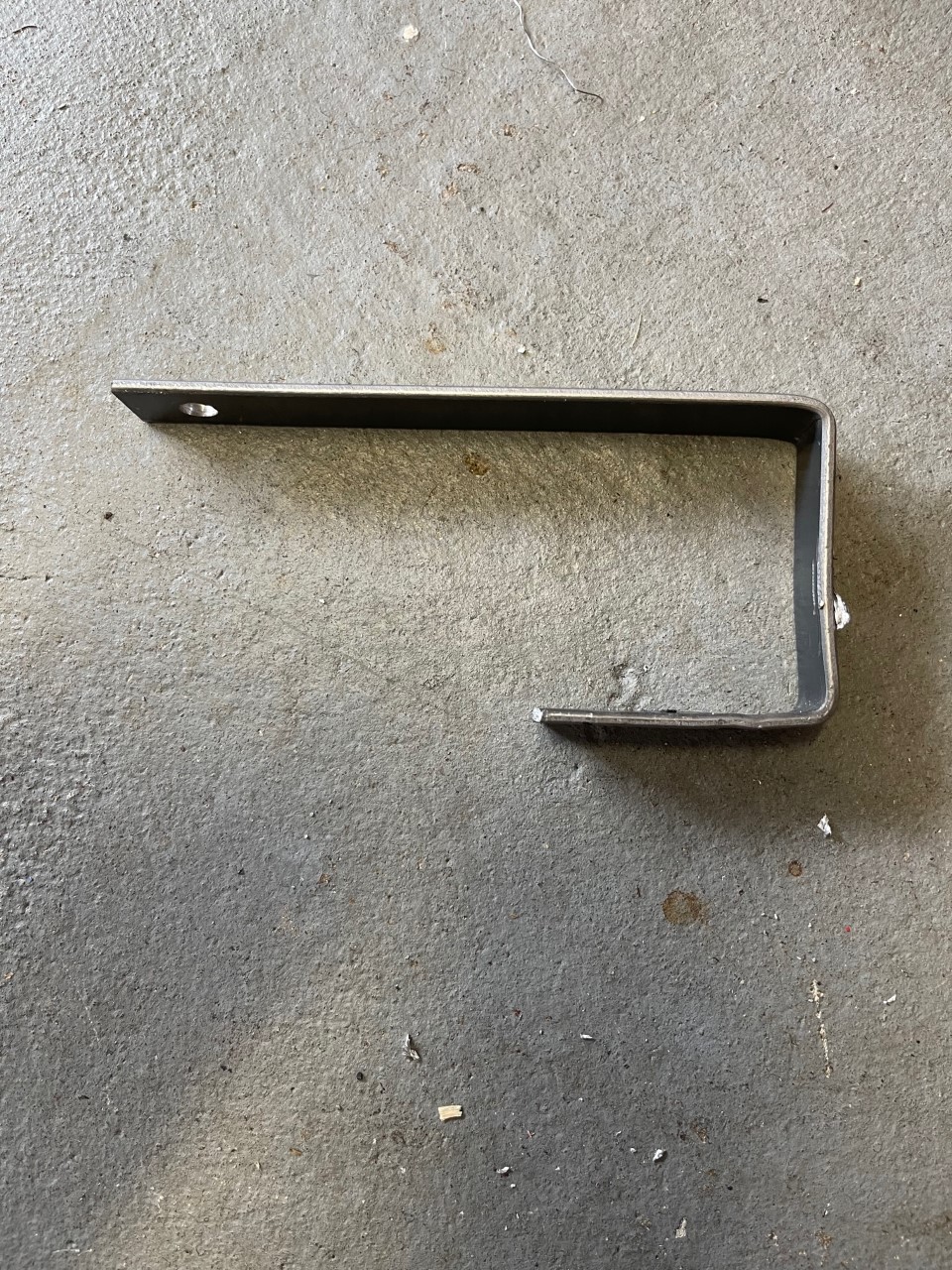

I made a bracket to support the rear of the plate. The bracket mounts to the bottom of the steering column. I used a button head cap screw to attach it

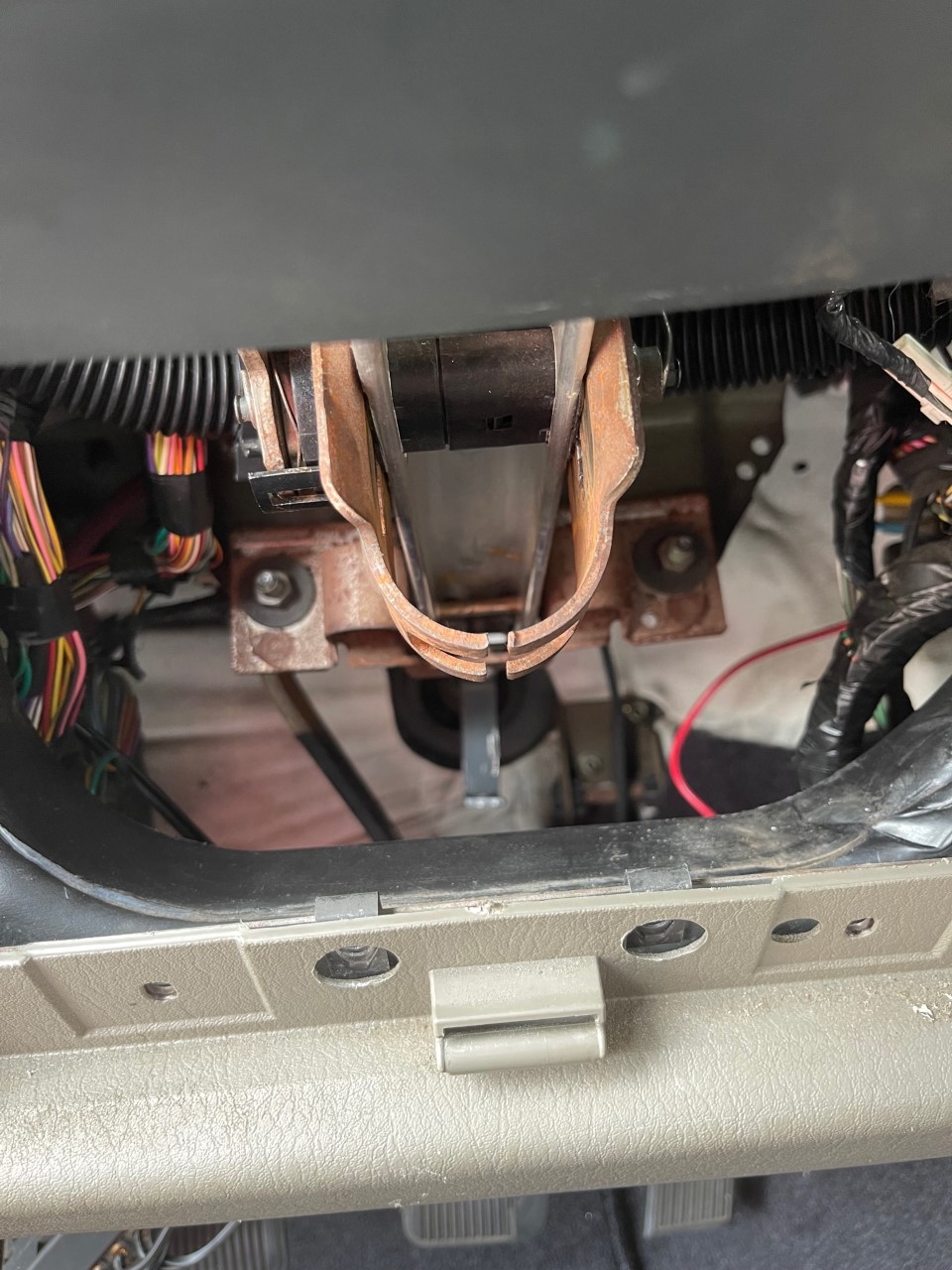

I pulled out the trusty Sawzall to make a little room by removing the steering column limiter.
I slipped a couple 6mm speed clamps between the dash and the dash support.

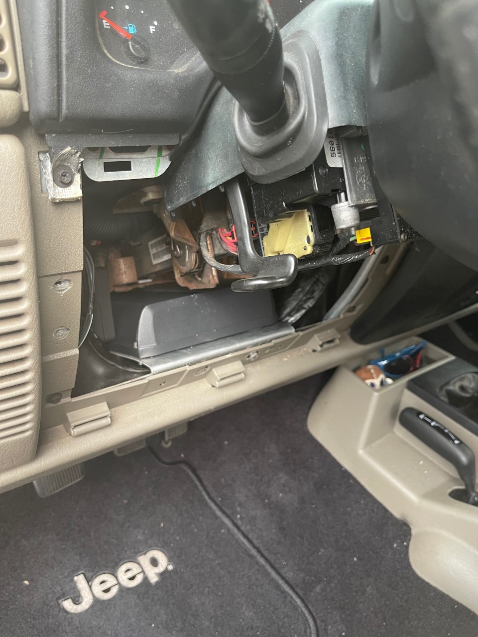

Here is it all bolted up.
trial fit. everything looks good
It's all wired up and installed.

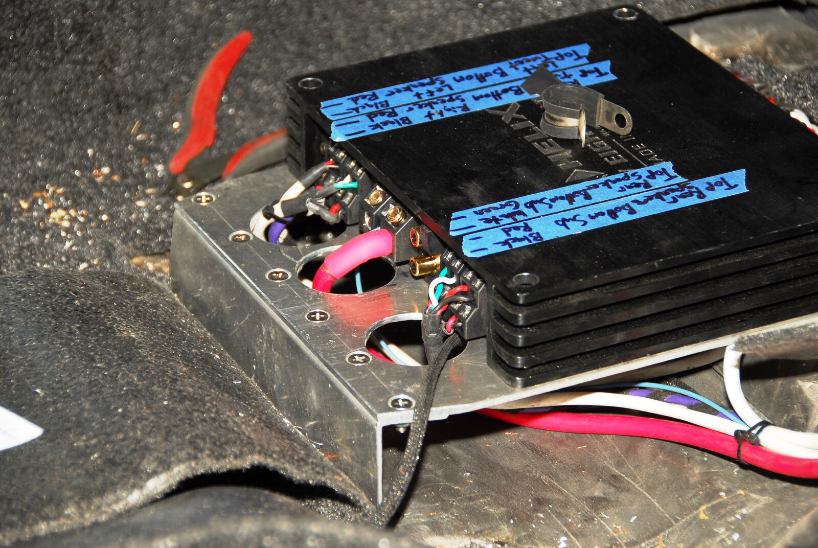

I agree, very nice work. I would just tune the amp myself. The variety of other noises a Jeep may make due to soft top, no top, no doors, et. al. limit the kind of sound reproduction that would be studio class. As long as I can hear mine well going 60mph down the highway with the top off, I'm more than happy. Great work!

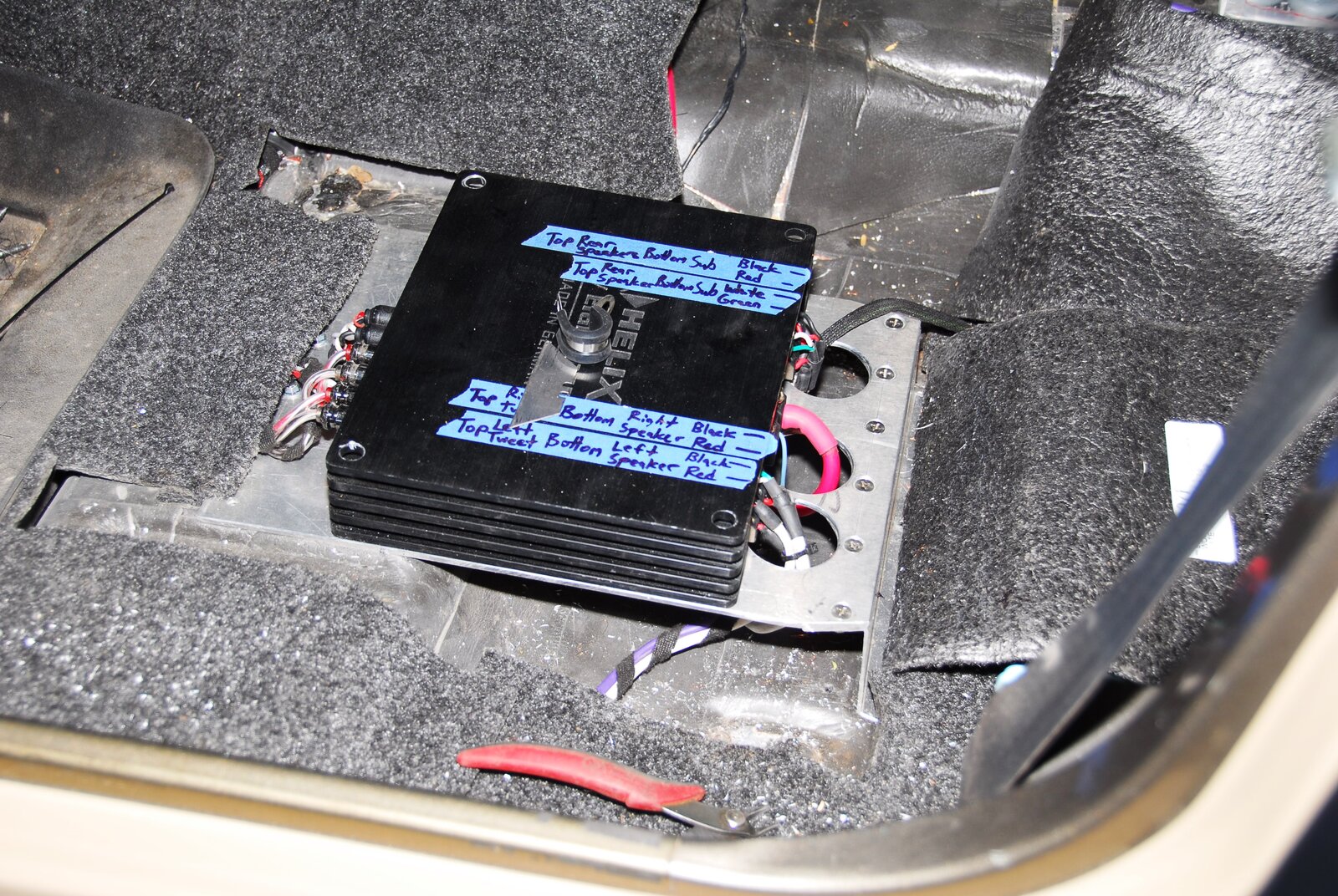

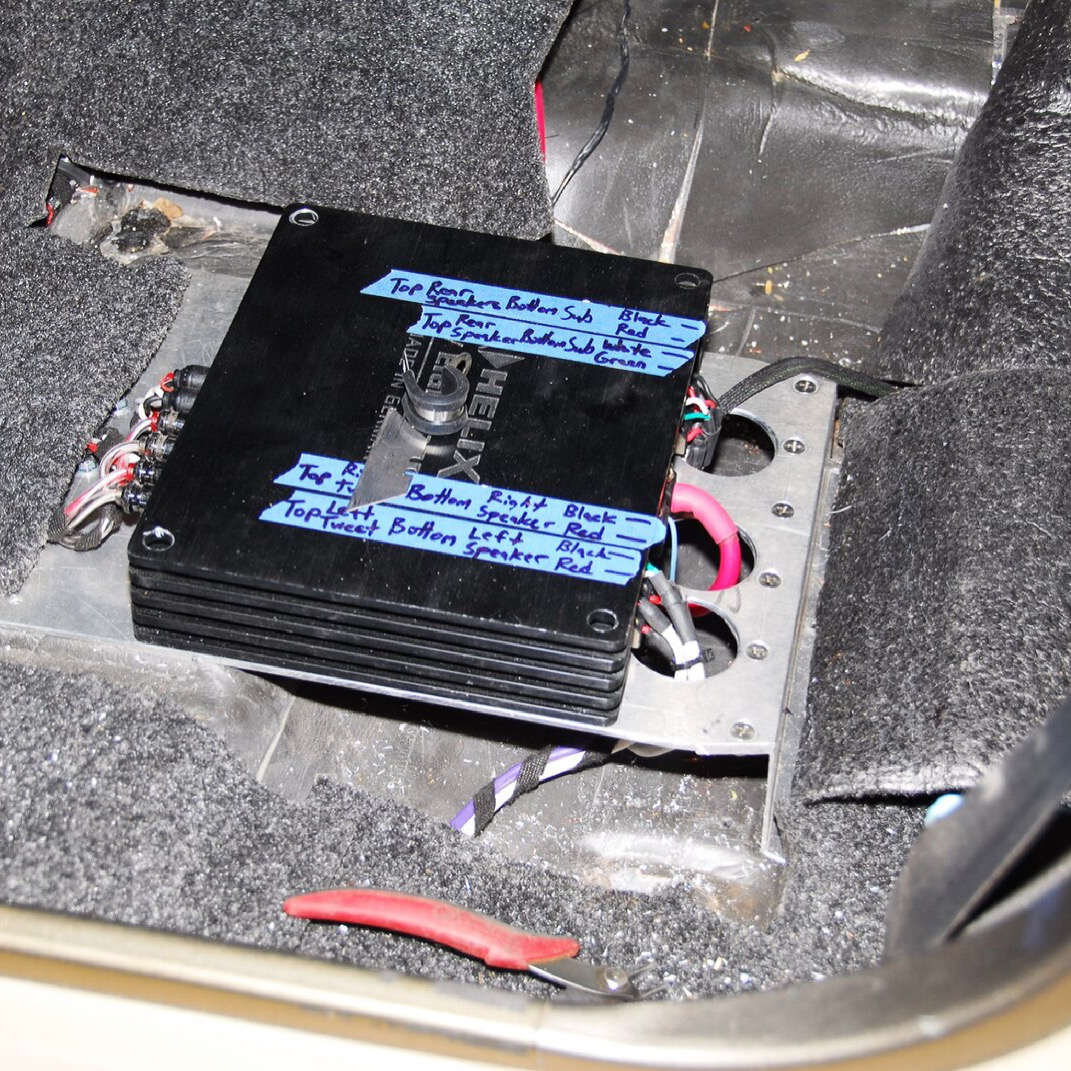

That is under your front seat correct? I thought of that but have fold and tumble on both sides. I wouldn't clear the amp.
Yep, it’s under my front seat. I’m not sure if this would have worked with the fold and tumble as my PRP seats don’t have it. @mrblaine would likely know for sure.
