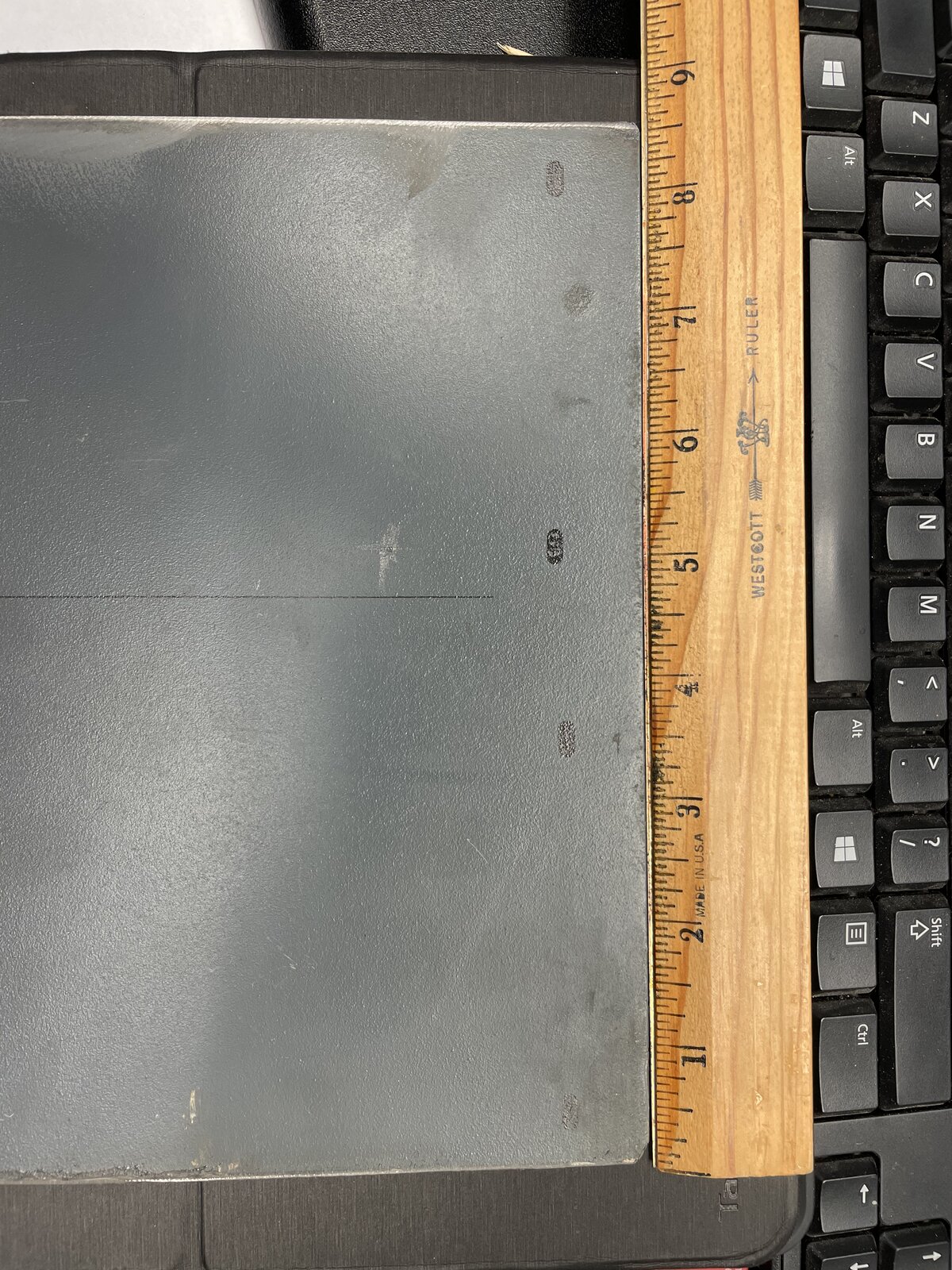

I wanted to install 2- MB Quart micro amps under the steering wheel and had seen in someone else’s post where they use a plastic cutting board as their installation platform. I decided to use a metal plate instead. I wanted to show the dimensions i used to create it.

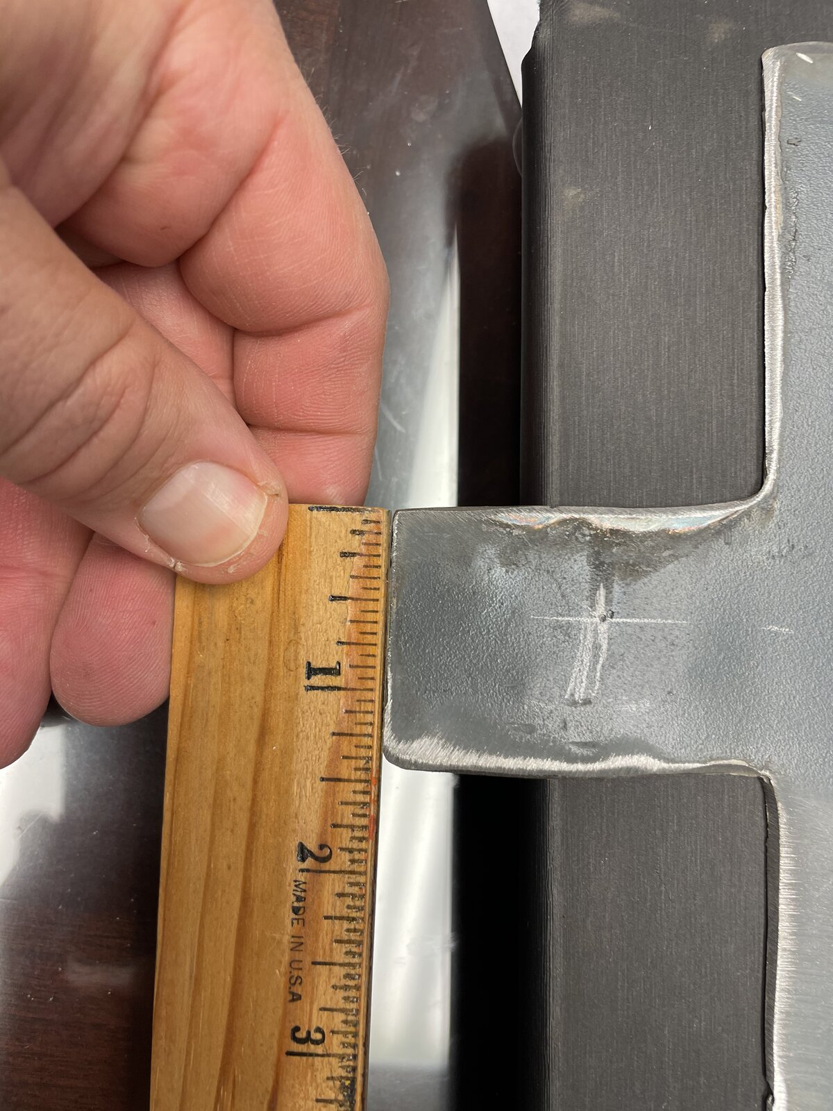

The tab on the front is slightly offset to the passenger side. If I wanted to spend more time with it I possibly could’ve made the whole thing larger to accommodate a bigger amp but I didn’t need to so I didn’t bother.

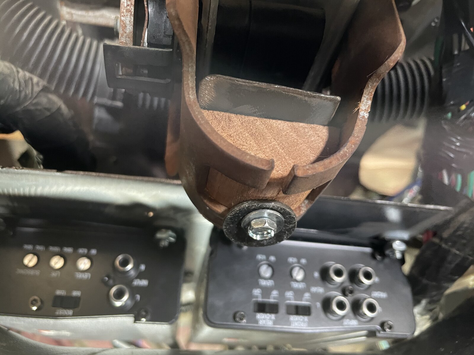

My amps did not allow me to use existing hole at the base of the steering column because the bolt hole was underneath one of the amps and I couldn’t get it to work. I ended up drilling a hole through that same plate and using a self tapping screw between the 2 amps to hold it in place. ( Circled in red).

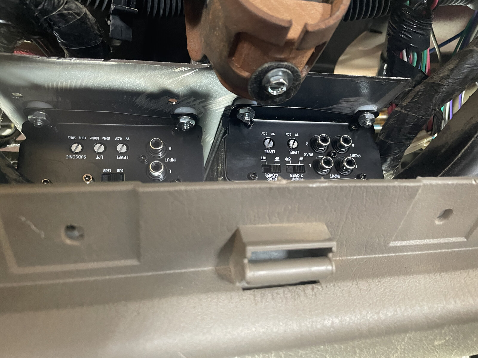

The first pictures show the dimensions on the plate, including a tab on the front that slips into the U-shaped section of the steering column. I used a piece of wood as a spacer so I could bolt that tab into place as you see in the pictures. I went to Ace Hardware and got some nylon spacers so the amplifiers had a little bit of airflow between them and the metal plate. I had to offset the left hand amp closer to the firewall because it was bumping into the structure around the steering wheel.
One of them is a four channel amp and the other one is a mono amp for the subwoofer. It certainly wasn’t as easy as I imagined it but I’m very pleased with the outcome. The 2 Amps are completely hidden and all the wires are well out of the way of the foot pedals.
