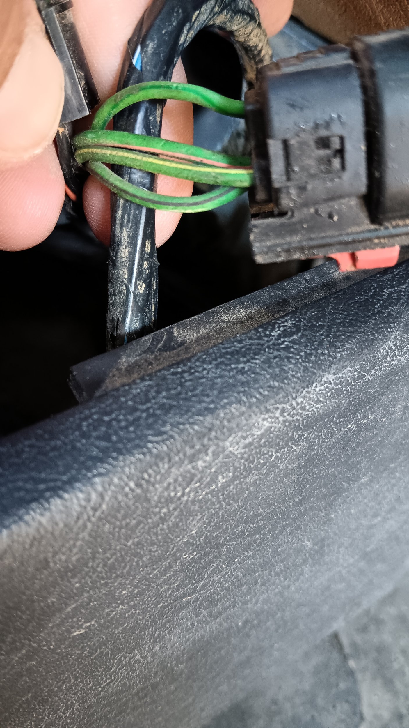

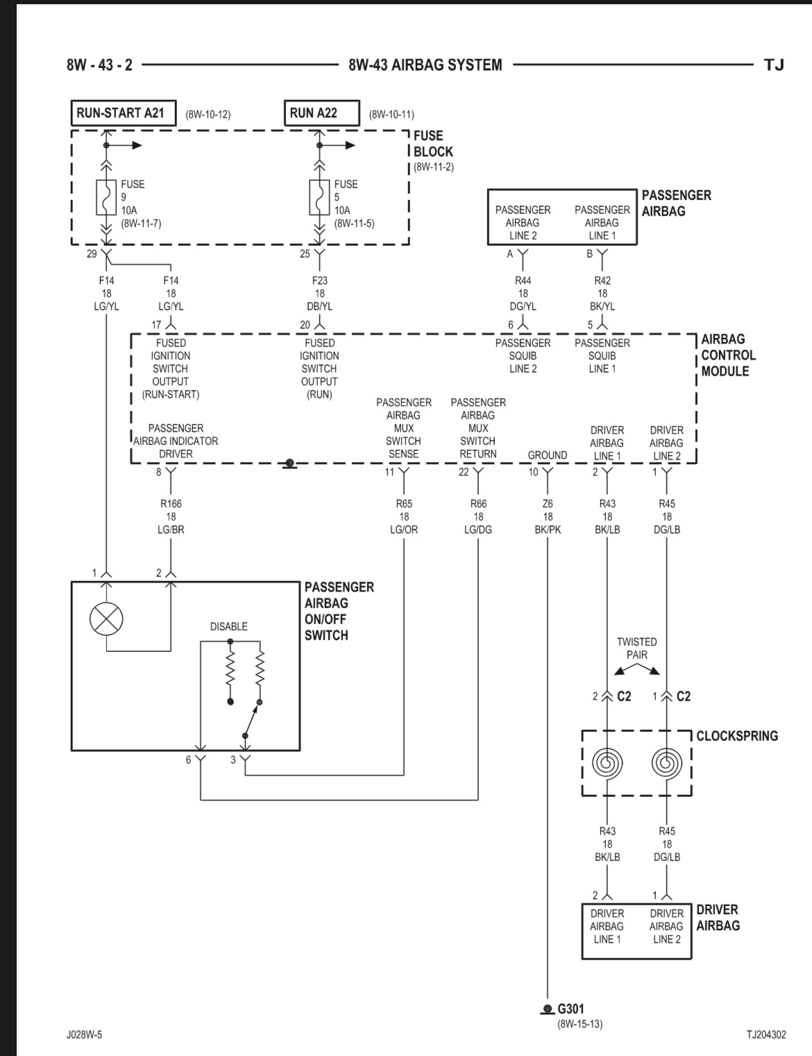

I’m new here, thank you in advance for any advice. I can’t get my airbag light to go off. I have searched the forum and found a lot of good information, but nothing seems to work. I replaced the bulb on the passenger deactivation switch with some degree of success. It became intermittent until the other day now it is just on. I have a code reader that shows the faults. It was just the 0052 PAB Disable Warning Lamp Open/ Short to Ground and now it has a 0056 Airbag Disable Switch Open. I have 2 passenger air bag switches with the same codes. Any help would be appreciated. I am willing to bypass the switch, I don’t have little ones to worry about in the front seat.
