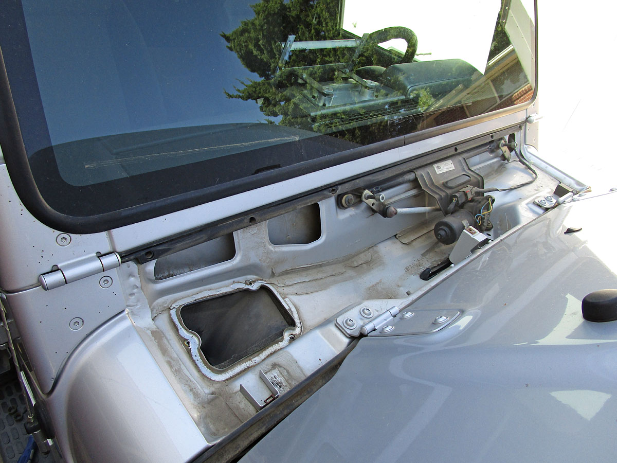

Was that from inside the cab? What about under the cowl, outside? Remove the cowl cover, and then remove the plastic rain guard on the passenger side (3 screws). You can look straight down into the fan. Or snake your borescope into there through the vent, if it will fit.
