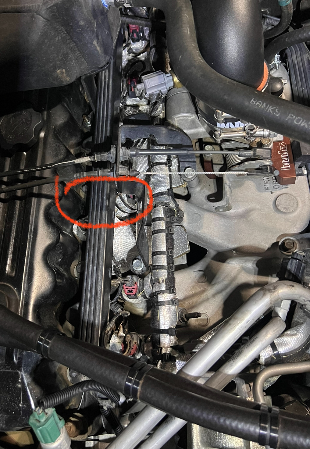

FWIW, I installed the Mopar corrugated split-wrap, 500* wrap, and 1800* wrap over injector #3.
I don’t know if it’s necessary, but these were the measures I took when trying to fix the misfire issue. I thought it helped some at first, but ultimately it didn’t solve the problem.
