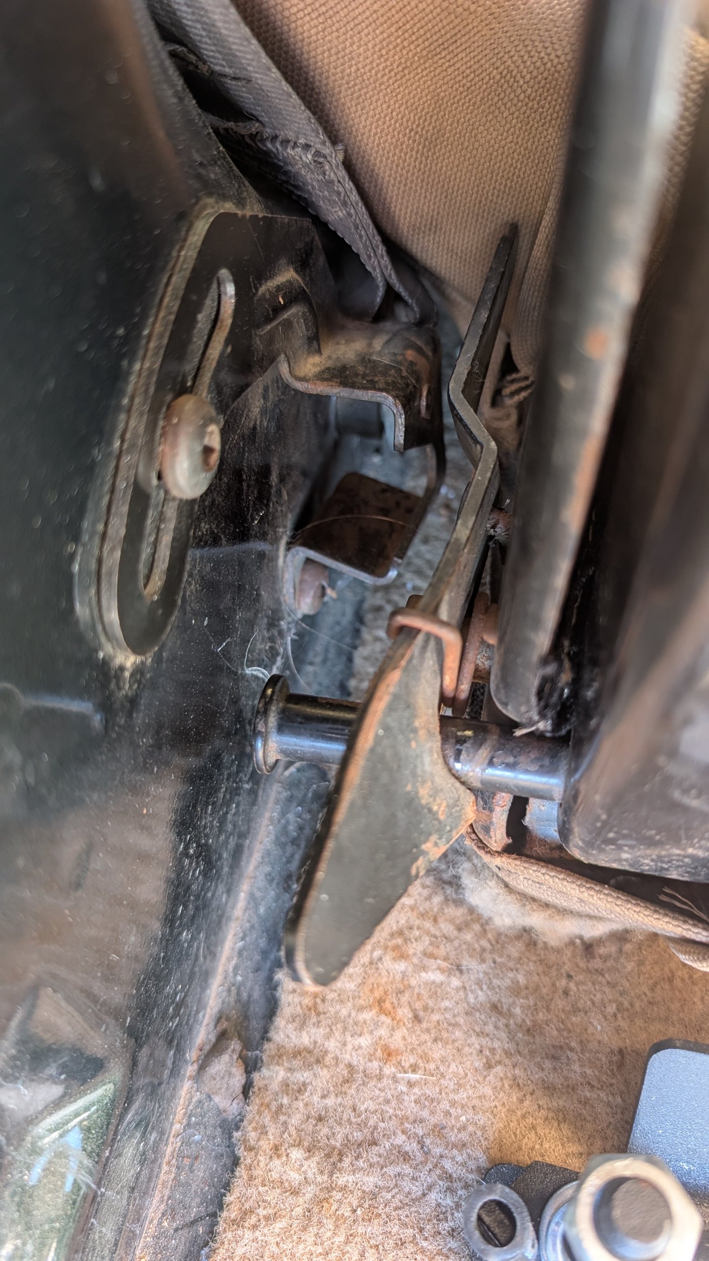

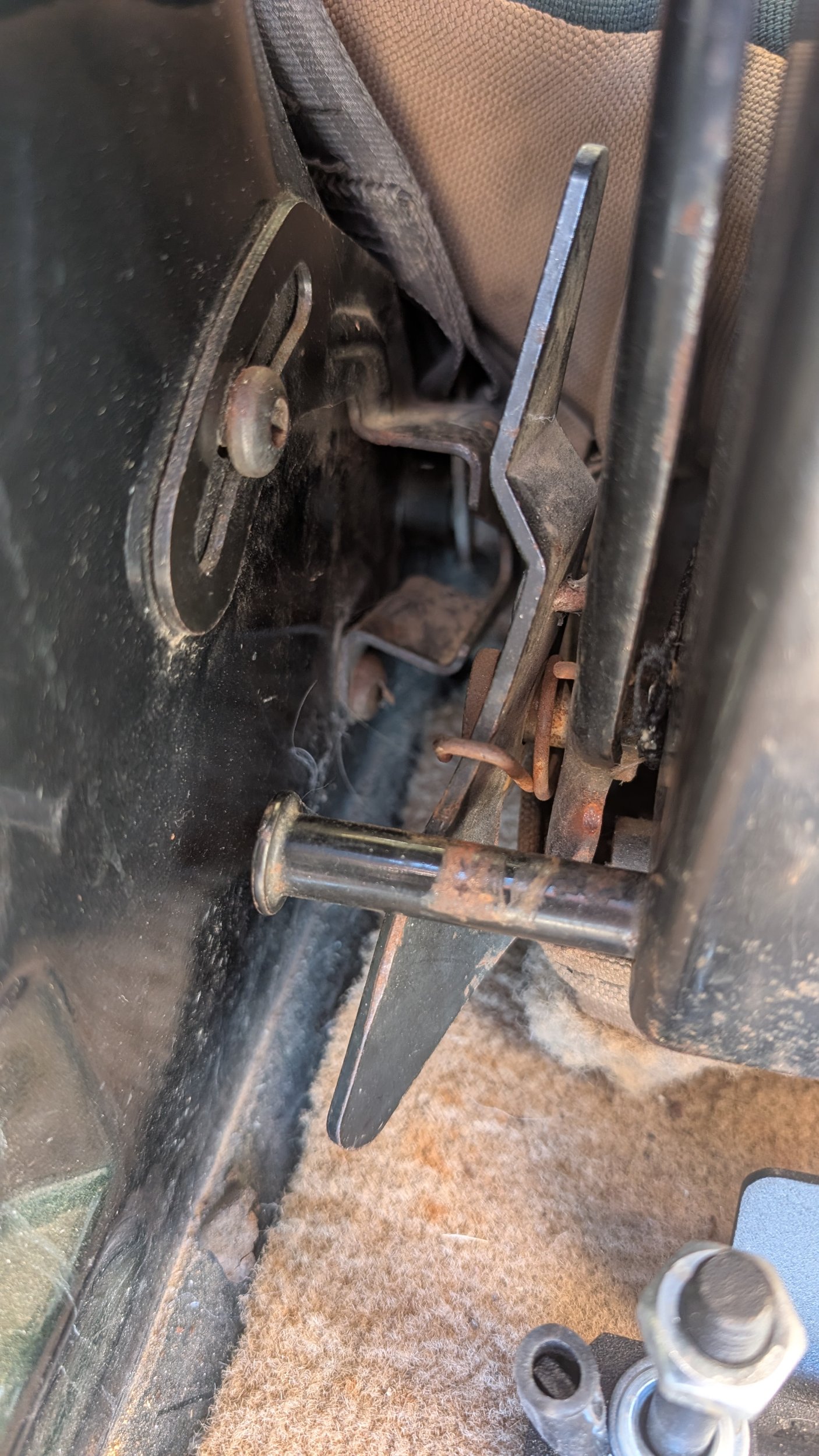

Next fun thing. What is the rear seat latch supposed to look like? Mine is mangled, and doesn't automatically catch the bar. Also, the bar is not caught in the holder on the fender well. Which appears to also be mangled.

The seat is so far from the bracket I'm wondering in the front brackets have been removed at some point and refitted backwards.
