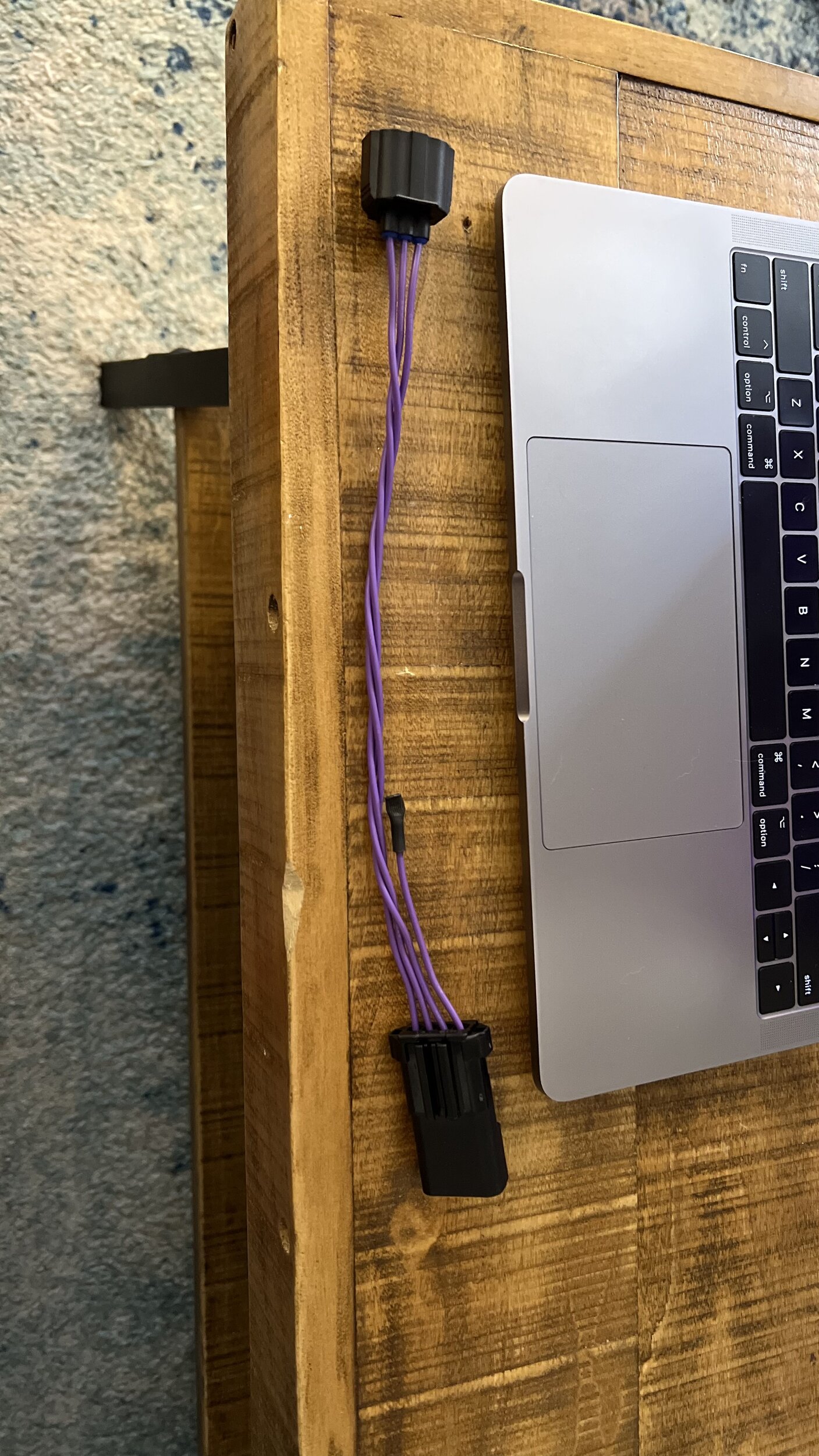

I hate to do this but i guess I'll shine the bat signal. @mrblaine Didn't you mention a pigtail between the harness and the 32rh that splits to the two connectors?
@starkey480 do you remember from your swap?
https://www.rockauto.com/?carcode=1373723&parttype=2602
The upper connector was from the link I sent. Lower is a Delphi/aptiv male apex 2.8 4 way connector

Looks like you are right! So I should be able to find a adaptor connector to connect the single 4 wire harness plug to the transmissions 2 plugs?

make a wire to connect C154 pin 3 to the NSS connector pin 2, and connect C154 pins 4 and 2 to the NSS connector pins 1 and 3. After that wiring is done, ensure you leave a fuse installed in slot 20 of the fuse block. See the attachments below for the starter circuit diagram, C154 location, and NSS pinout. Is this how it should go? I copied it from somewhere but lol idk where
Ok I have almost figured it out! The po installed the wrong harness, I replaced it with numbers matching 2002 harness for a auto trans! Everything plugged up except the wire plug fo the transmission and I did see another plug on the harness! After help here and other places, and the fsm, I figure out that I'm missing a pigtail to connect the 4wire (vt/wt, vt/bk, br/lb, and bk) plug on the harness to the three pin nss connector on the trans! The pigtail is discontinued and no after markets are available! Ill have to either find a used pigtail from a 98-02 32rh transmission or make my own pigtail! The pigtail only goes to the nss!

Yes that is what I've figured out! At least I know the wires are thare, i havent got under it to see wharè they go yet! I've read a few people that swear the plug is there! But at least I know now what needs to be done even if I have to replace the plug like you did! I've read a few people saying the same thing you are saying! In the fsm it shows the wires in the diagrams and it also shows the tcc plug and pin out! The wires are orange/ light green and red/light green! The or/LG comes from the pcm connector 2, and goes straight to the tcc(it don't go through no connector at all), the rd/LG comes from the fuse box, it goes through connector 106 and 103 then to the tcc!
The other 4 wire plug connector 103 with the vt/wt, vt/bk, br/lb, and black wires goes to the neutral safety switch! jeep made a connector pigtail to connect it but it is discontinue, so you either have to locate a used one(hard to find) or make your own!

I would have sworn the NSS is only 3 wires though. Yep, just went to the garage to verify against a pigtail I had bought but ended up not using. 3 wires.
My nss plug on my harness is the 4 wire plug with the obove mentioned colors! The nss on the transmission does only have 3 wires! That is whare I'll have to make the adapter pigtail to connect the harness to the nss on the trañs! I have found that jeep made quite a few different harnesses! I think it goes like this! 98-2000 are the same, 2001-2002 are the same, 2003 different from all. And 2004-2007 are the same! But each year also had manual harness and the auto harness exept 2001-2002 used the same harness for manual/and automatic, only difference in them is the pigtail that connects the harness to the transmission! Jeep made the pigtails for auto and manual but they are discontinued
