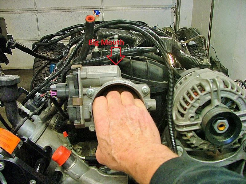

No wheel hop at all I suspect the metal got tweaked during the tub removal. Didn't have enough attachment points. Now here is a Throttle Body!
