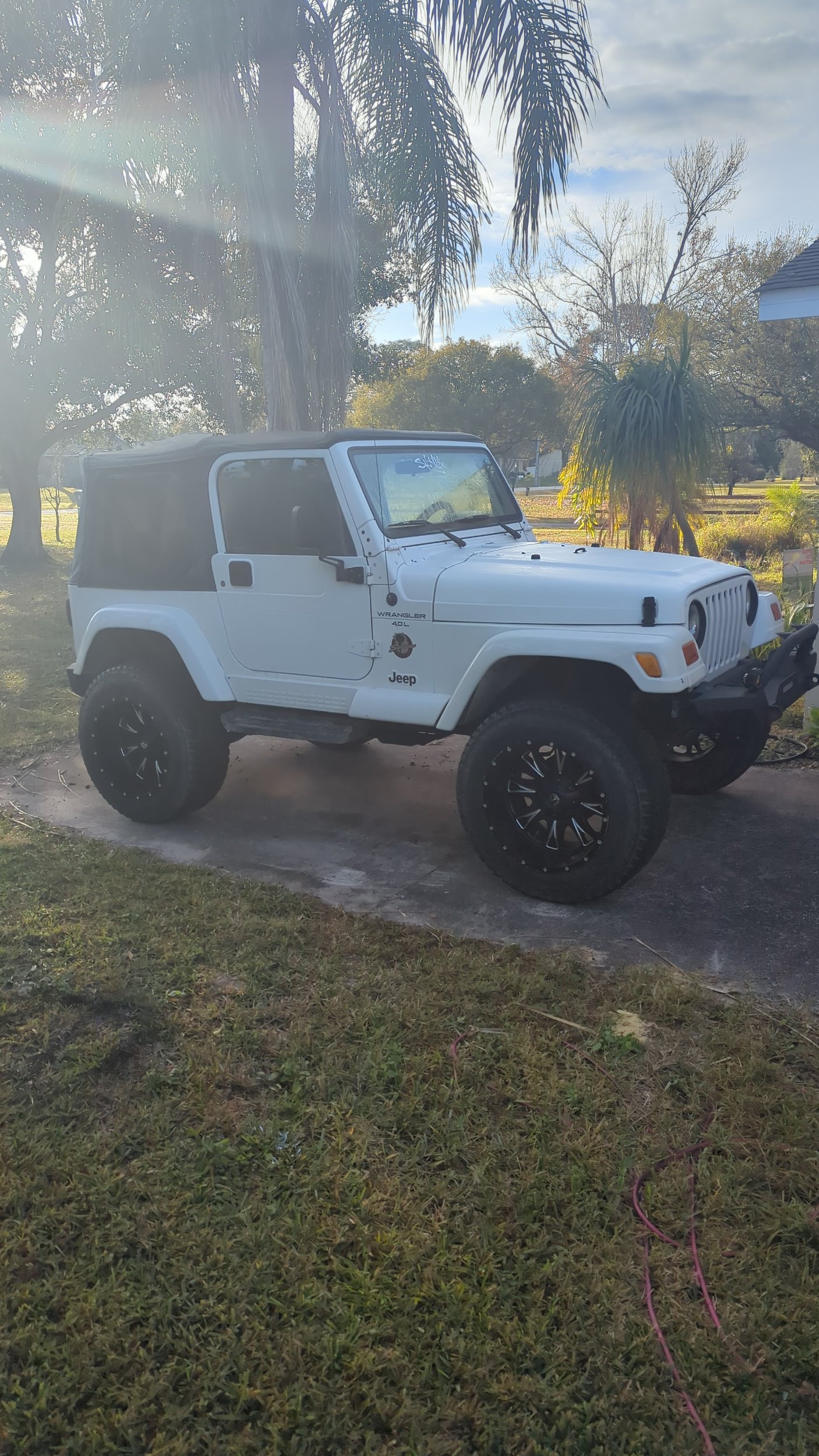

The problem with the 20’s in 35’s is that you can’t really air them down enough to make a difference when you run them in your Florida sand.
Let me start by saying by no means am I trying to justify it on a TJ (or at all for that matter).
We used to live by the sand dunes (in the same town) and I would occasionally take my truck out there to meet some buddies or just hang out. I never aired my truck down from street pressure (about 36-38) and never had an issue. Now we live near the beach, but it is mostly good drivable beach though the approaches get nasty. However, the truck has about 400hp and I'm willing to hit stuff hard and fast enough to get through. Now I wouldn't go park out in the soft areas of the dunes and try to leave uphill. But you can make it work if you have to.
Yea it sucks not much sidewall to work with. They are very wide 12.5" so I am hoping they won't sink in too much. The rims are 12" wide and the 12.5" tires barely fit the rims. The rim is flush with the sidewall currently. They have curb rash from previous driver and you have to use a bead blaster or either to get the bead to catch. If I went below 15 psi I would worry about breaking the bead. I will put a can of either in my rig if I want to air down. There is some larger tire options. The rims are so damn big.
