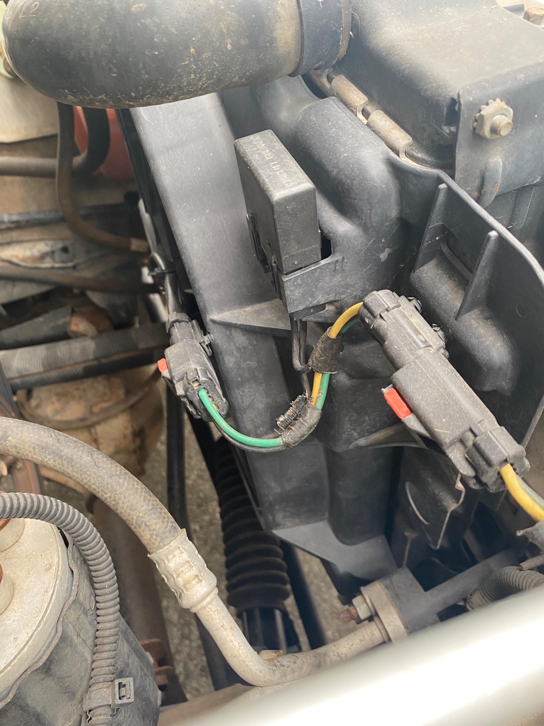

Does anyone know if the radiator fan fuse relay attached to the radiator shroud is grounded BEHIND (in front of really) the shroud?
I don't have this additional wiring on mine, and am having trouble getting a new fan to work, and it may be as simple as no ground. I assumed the black wire in the harness from the PDC went back to main ground, but thought I'd ask if anyone knows (or can take a pic, etc).

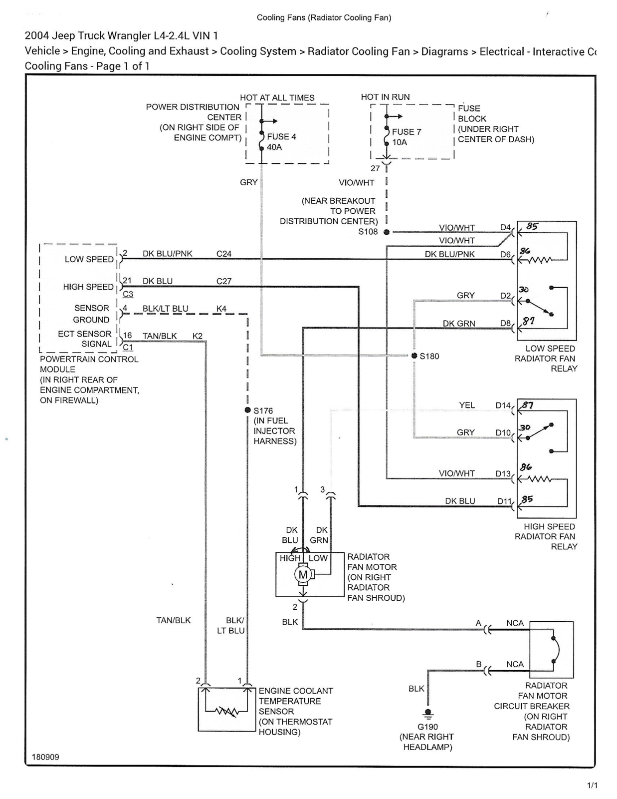

Thanks AaronPaul, for the reply. I looked at the above linked schematic for body grounds, and G190 is the ground for the fan assembly. That's next to the right headlight. There is a BK/DG wire from the PDC harness that grounds to G190, and then attaches to the fan harness. I verified that there is continuity to ground from the harness, so it looks like it's working. I was hoping for something simple, but now I'm thinking there is a signal issue from the ECM :(
Back to the drawing board.
I guess I can just disconnect the low speed relay EVERY-TIME I drive until I solve this.

Relays tested fine
Coolant temp switch was replaced (I didn't get resistance on it when tested. The new one does)
I don't see a fan control unit on the schematic
I don't get continuity on pin 86 Low speed relay socket when A/C is switched on. That makes me think it's either the PCM or the cable between the PCM and Power Distribution Center. But I'm happy to be wrong, because I don't want to replace the PCM
I added some refrigerant to the system today, and the fan kicked on with A/C. I guess it needed to get up to pressure before the PCM would ground the low speed fan.
I didn't get it to go to high speed yesterday running it, but maybe I just didn't get up to temp? It was slightly past mid-way on gauge (210F). I'll try again today after work.
We got a winner! Fan comes on with A/C once charged, so needs pressure before PCM will send signal. And, comes on about a little over 210F on Temp gauge.
