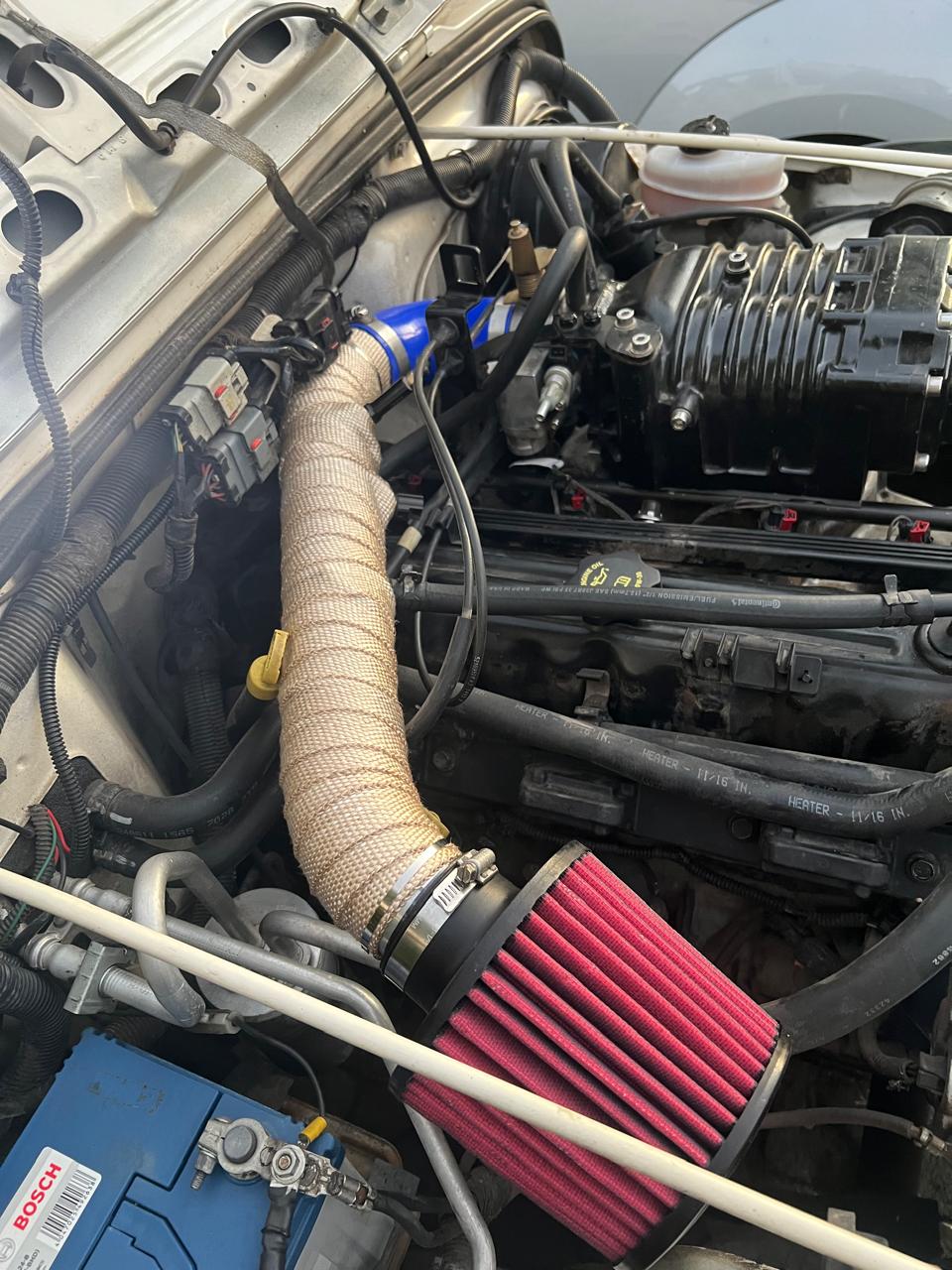

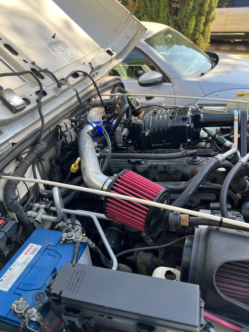

@jjvw and @bluescapegoat, what are your IAT readings ind hot weather with the windstar air filter breathing from the cowl?.
My readings are very high, i know my air filter is breathing directly from engine bay, but in this days, with an ambient temperature of up to 93º f my IAT is between 150 without effort and 220 on boost (With methanol starting at 2psi).
Other thing, i installed a wideband. On normal operation, it moves between 14 and 15, and on 5 PSI Boost, it goes between 11 and 12. How do you see this numbers?. (I'm still with OEM injectors, Ford Racing 47# are on the way)

You said you had a local tuner that knew how to do stuff. What does he say?
I can't tell you off the top of my head without looking up the logs but your IAT temps sound right. It's really hot, I told you this was the main problem with the setup when I initially suggested you sell the kit and do a turbo. I think 200+ is pretty normal even from the cowl. The intake manifold is pressed against the exhaust manifold.
Also what happened with the injectors you had? What tune are you running? What size is your meth nozzle?
Stoich is 14.7. I ran factory setup with wideband for months to observe the factory tune and it'll run really lean, 15+ down the road sometimes and even higher at idle. That doesn't mean it's safe with elevated temps and custom tuning. You should be targeting 14.7 at idle and cruise and 10.5 or richer under full boost imo but I'm not a professional tuner. 12.0 seems very lean especially at those temps. Although with enough timing retard I suppose anything is safe, it's just a massive fuel waste at that point.
Again, not a tuner, but your shit sounds kind of unsafe at the moment
I just looked at my last tune (as I told you, still tuning in progress with FRP) I was usually 180-190 in boost with meth. Just touching 200 once it was really heat soaked on longer pulls. I've since installed a larger meth nozzle but haven't done any more logging.
180-190 cruising down the road. Between pulls.

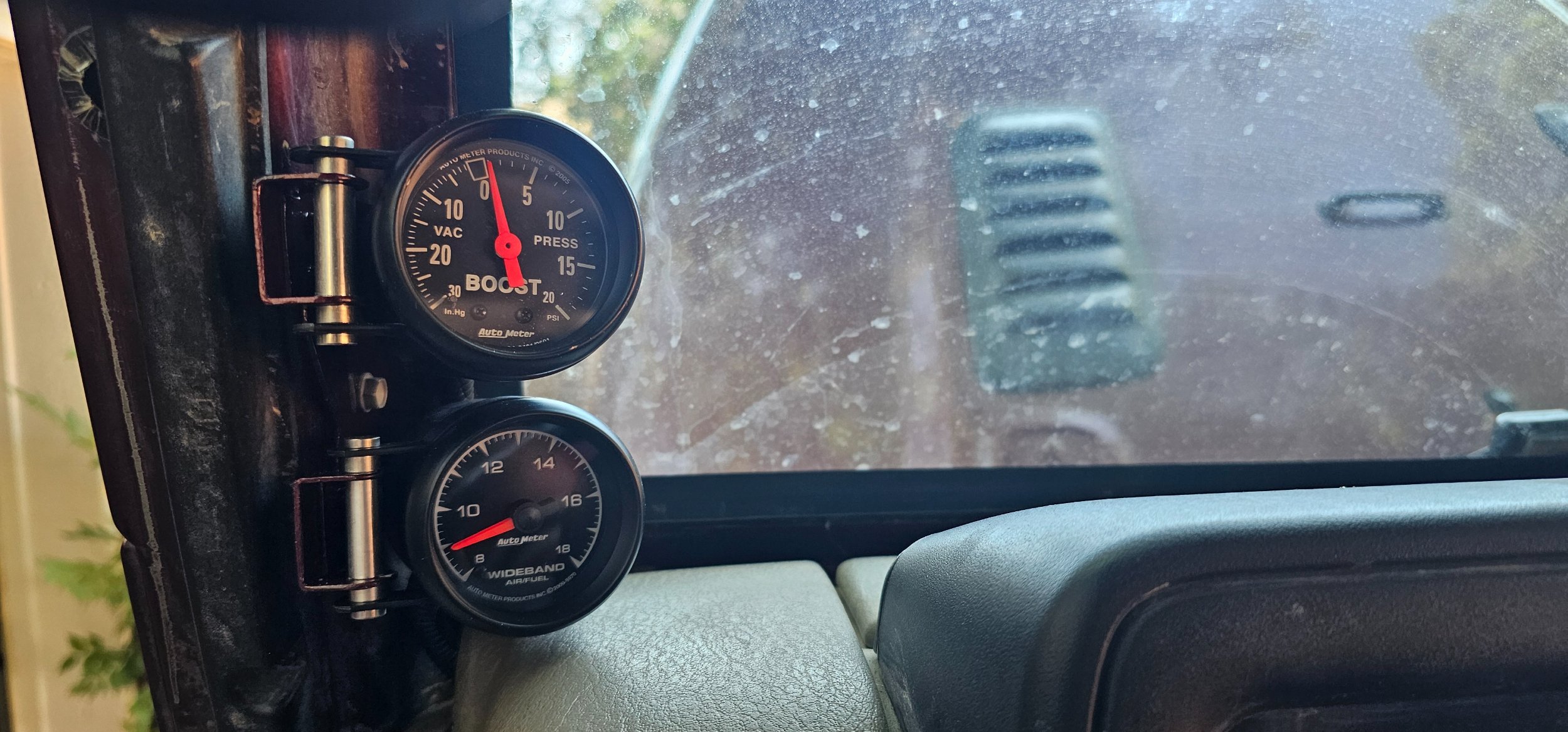

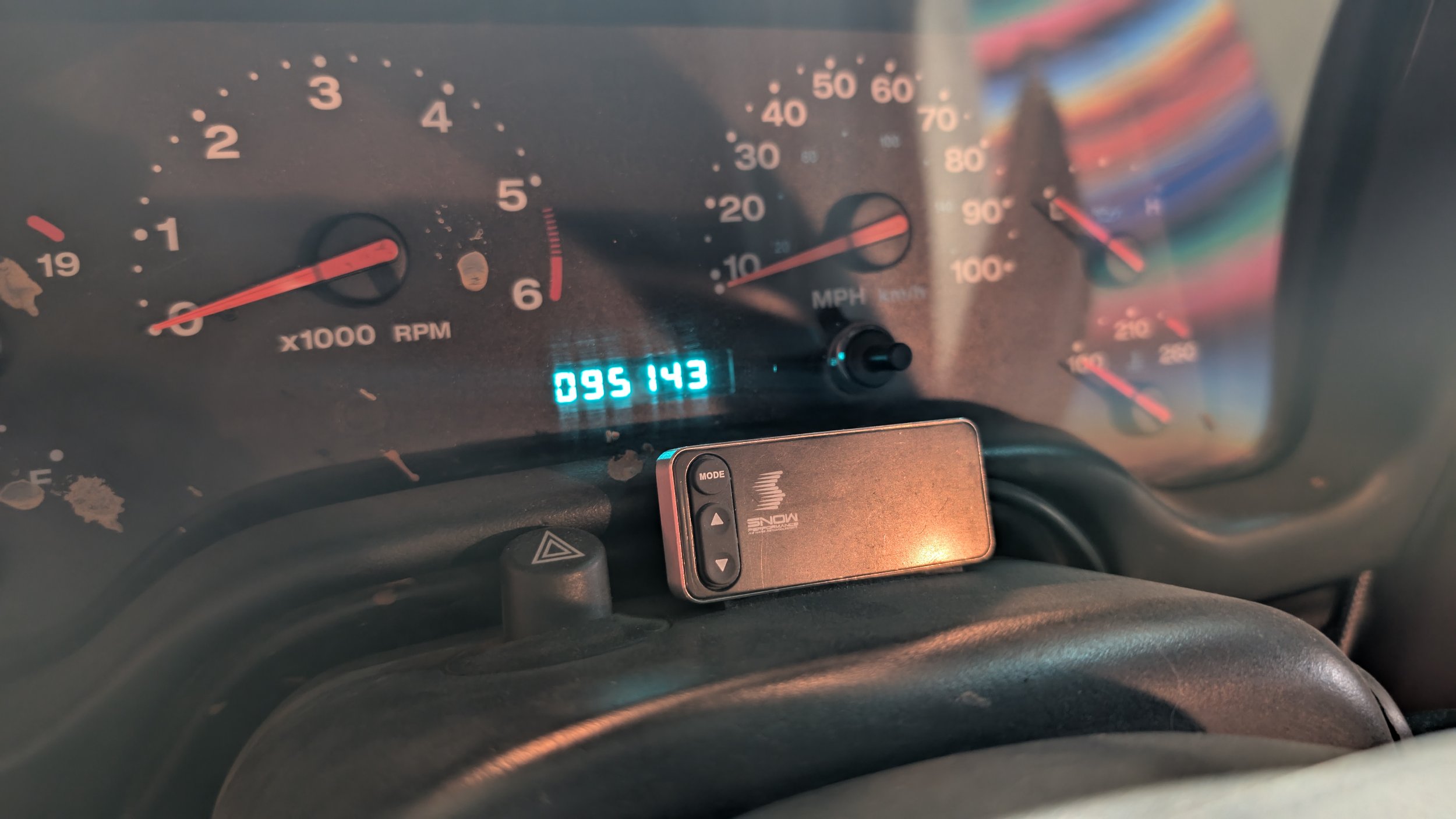

Here is a pic i took from a video testing. The boost gauge was at 5PSI and AFR was at 11,1. Anyway, i'll wait for the new injectors and also will connect the Wideband to HP Tunners for dataloging.
Thanks
Mariano

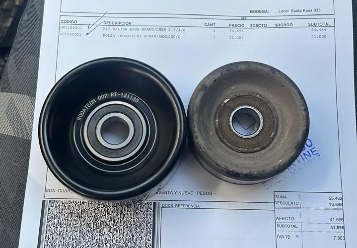

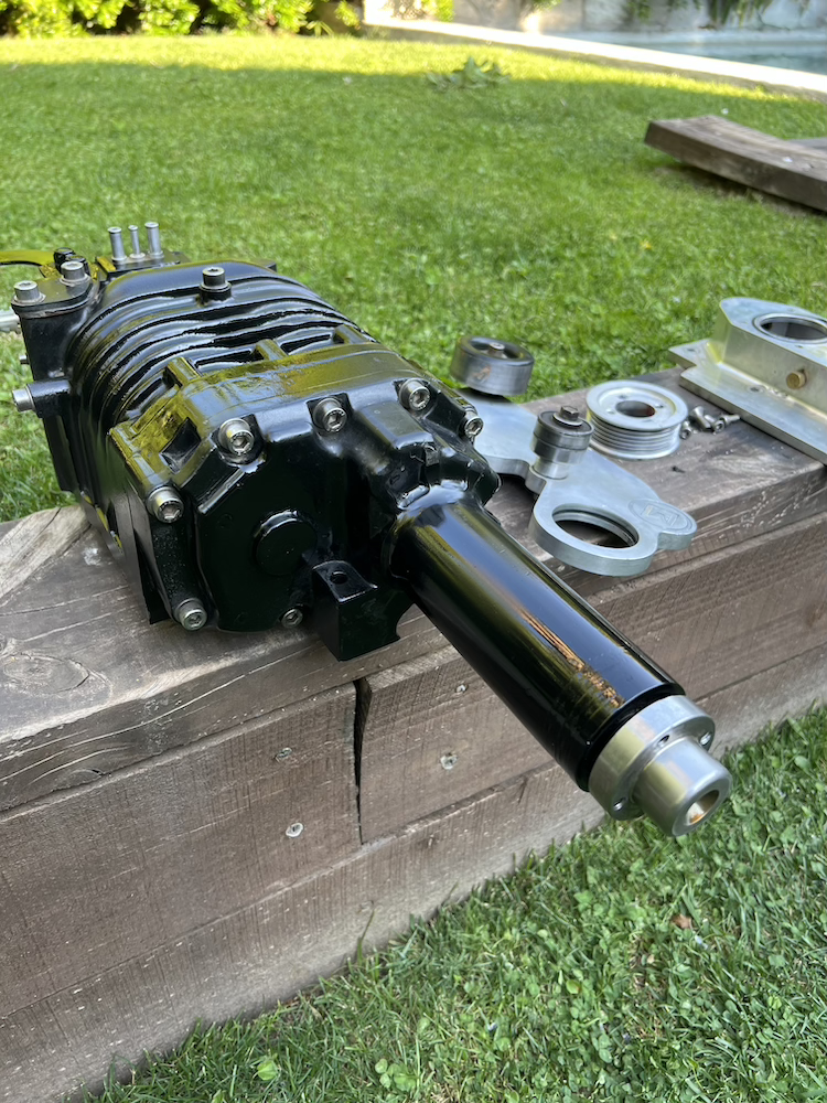

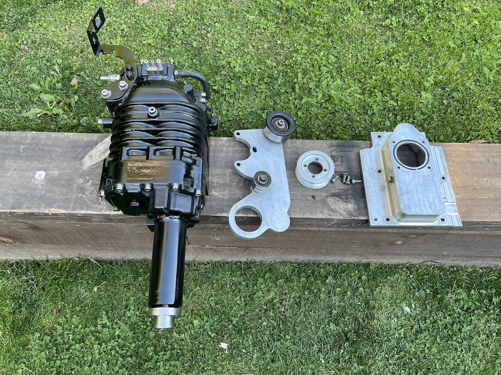

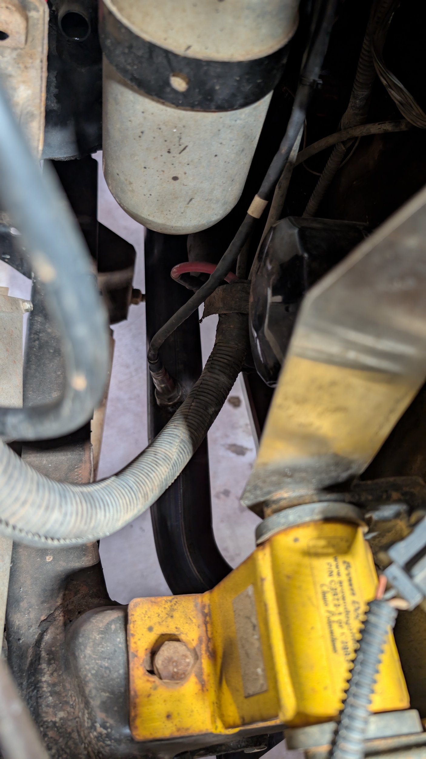

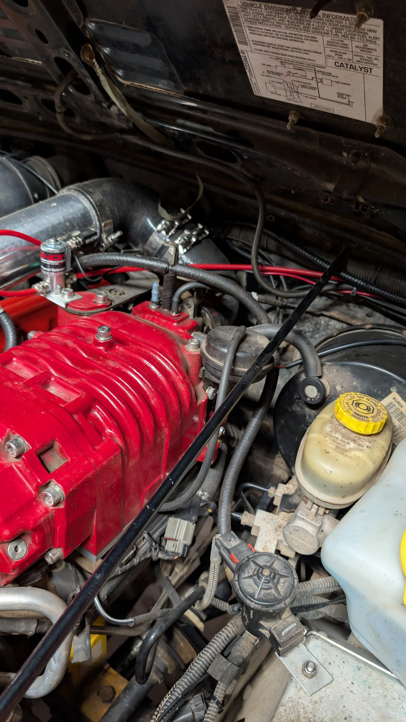

Hello all
Anyone can help me with the diameter of this idler pulley? (Ideally in mm).
The previous owner of the supercharger lost that pulley and replaced with just a couple of bearings together, but they are smaller, so I want to fabricate the pulley on the right original size.
Thanks
Mariano
