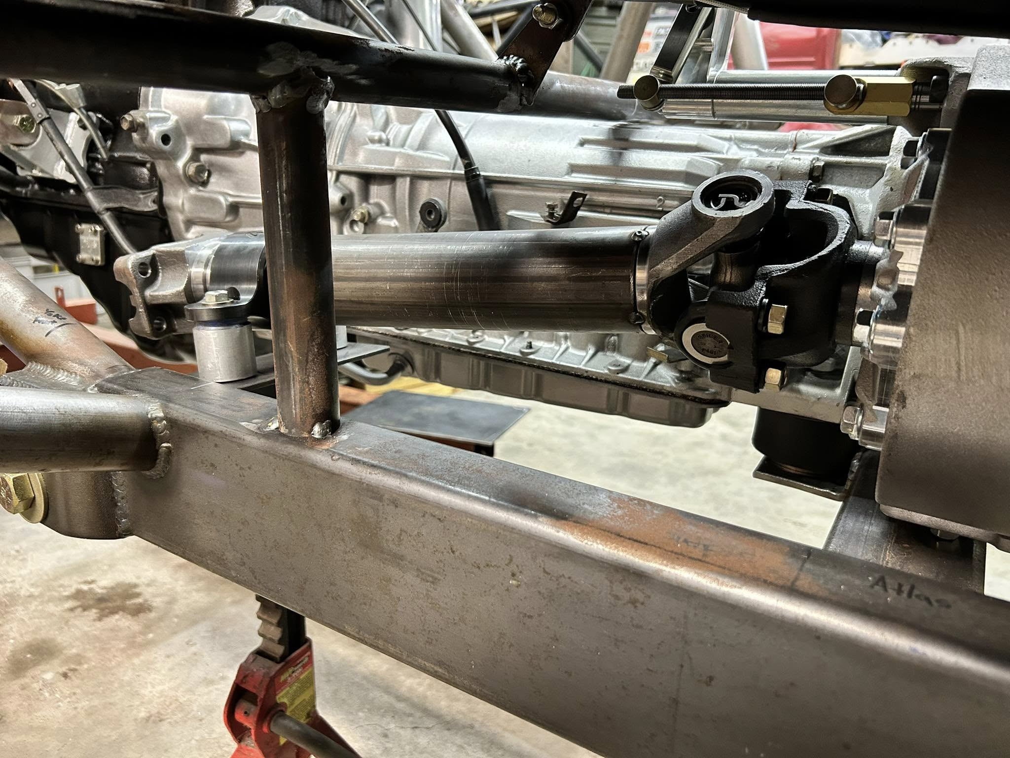

I don't see why it couldn't be. That engine and trans look to be set back, so that front shaft might be long. Or are you asking if a multi piece drive shaft is a thing?
What do you mean?
It's been used many times to get around things.
Never seen a front 2 piece driveshaft. Just never thought about it I guess

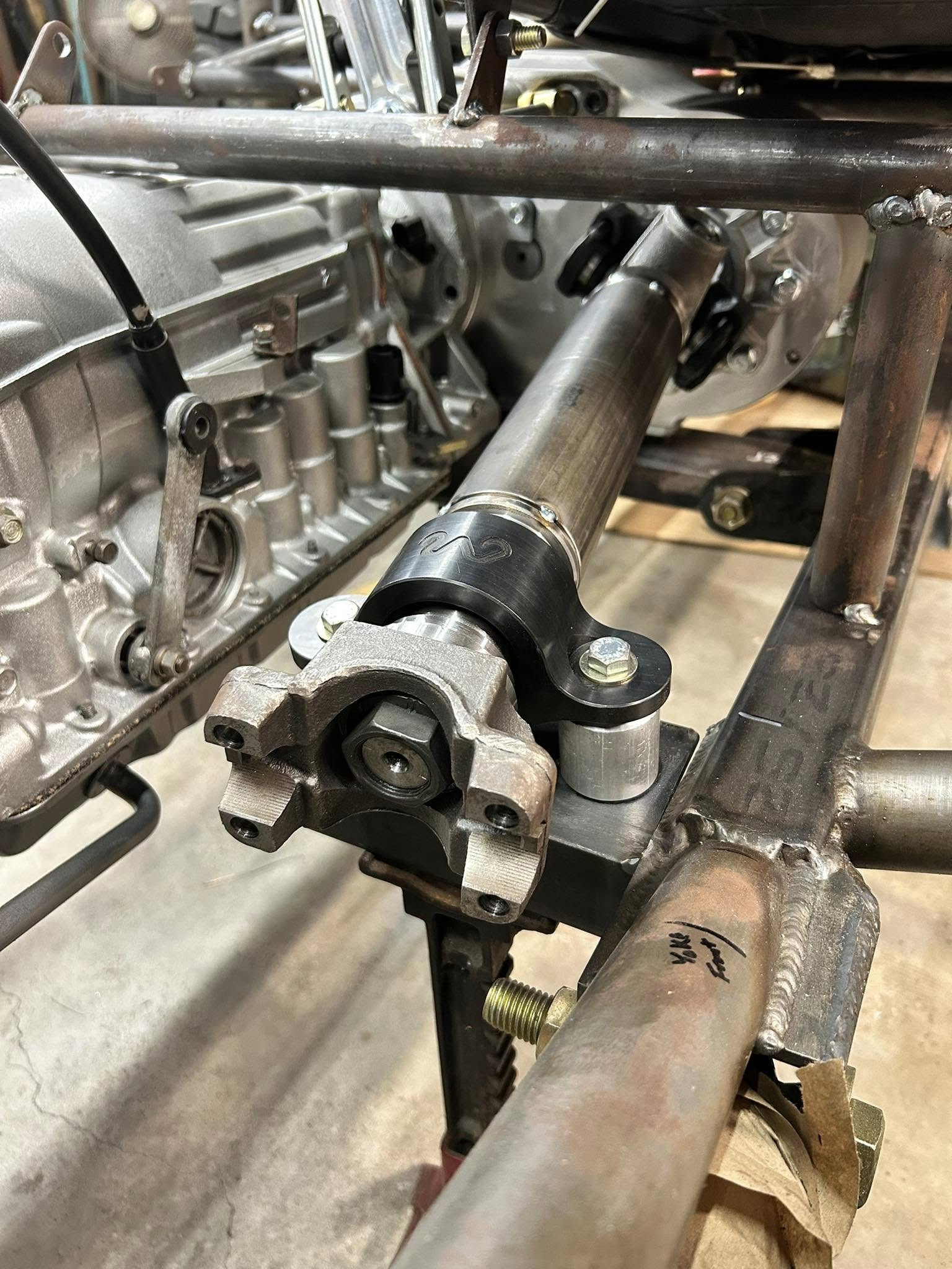

https://4xshaft.com/products/2-piec...Q8O0ZS6gf8fAT80hOeYv9llyGufS24is9GEUufIKGx1en
Why is his yoke 90 degrees off in front of the carrier bearing ? The separate driveshaft photo is correct though .
