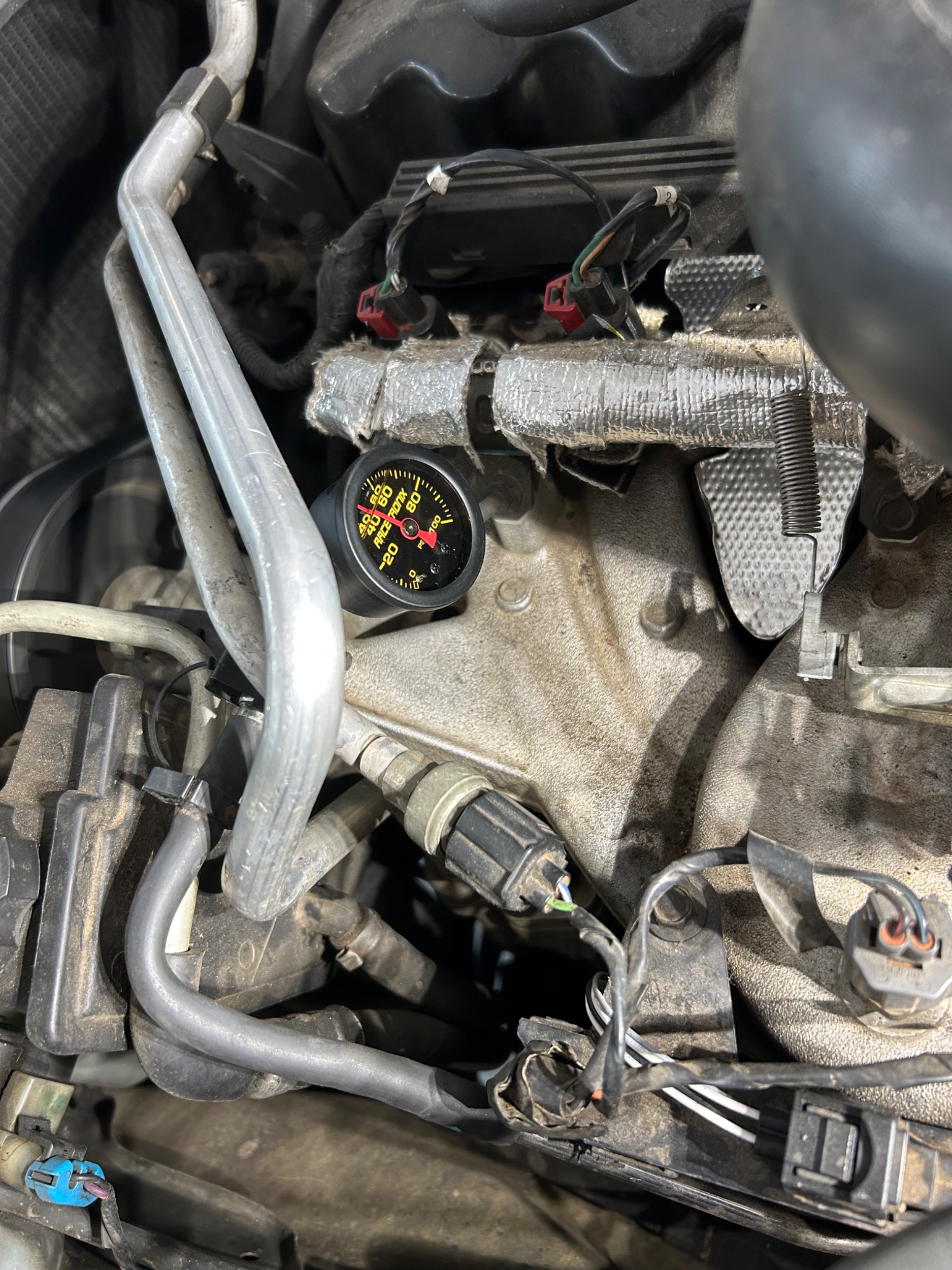

Your fuel rail doesn't have a Shrader test port...at least I don't think it does.
So you can't test fuel pressure.
That adapter slips on to the quick disconnect fitting and allows you to install a gauge or a test port.
-Mac
Reactions: macleanflood
Ok. But what am I looking for? How much psi? On the initial turn of switch or when it doesn’t start. Does this confirm it’s the fuel pump? I know just enough mechanical work to be dangerous.
48 psi is specified. Mine ran on 30 but the fuel trims were not good. You also want to see how it changes over time.
-Mac
Close to 50psi. Supposed to keep the pressure after shutdown but mine does not. Not keeping the pressure after shutdown is a sign the regulator is failing. Mine runs and starts fine so I haven’t worried about doing anything.
While running you should maintain close to 50psi. Mine runs closer to 48
A failure to start warm is often indicative of a fuel pressure regulator failing. As long as the fuel pressure regulator hasn't failed completely open, it will allow enough fuel pressure to build at the rails for a cold start. Warm starts become a challenge because engine heat will heat-soak the fuel rail. When the fuel pressure regulator is working properly, it effectively maintains pressure (it very, very slowly bleeds off pressure) in the fuel rail and the heat-soak heats the fuel but is unable to cause it to vaporize due to the aforementioned pressure. When the fuel pressure regulator begins to fail, it will bleed off pressure too quickly, allowing the heat to vaporizer the fuel. When you then go to start the engine, the fuel vapor won't atomize correctly inside the cylinder, and the engine cranks and cranks until the vapor is out of the fuel lines and liquid fuel is flowing into the injectors.
Sounds good. Now if we only knew what the pressure is actually doing? 🧐
