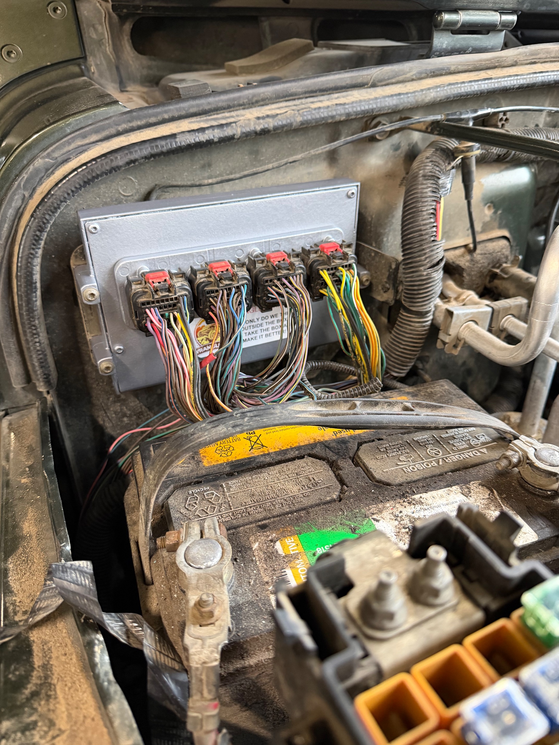

So new to the forum! I have a 06 jeep wrangler Tj 4.0 with the auto. Been fixing it up and it was idling outside my shop and randomly died, no check engine light but doing the key on off if showed p0688. Currently it no crank no starts and I don’t here the fuel pump or any relays clicking even after swapping the ADS with a few I know are good. No blown fuses and I got it to start twice moveing the pcm harness around but now it won’t crank at all and I’ve inspected the main harness and the room and can find anything the is alarming. Am I looking at a pcm? Hard to believe it would just go out after driving it for weeks with no issues
Reactions: Wranglerfix
Yes, there is. You can send the computer into us and we can run it in one of our jeepss. We usually get them tested the same day they come in.
Thanks,
Mark
Reactions: macleanflood
Hooked the new one in from Wranglerfix and she fired right up! No hidden codes and idles smoother then before I’ll post later after a few drives on the transmission issues I had before mark is THE MAN
