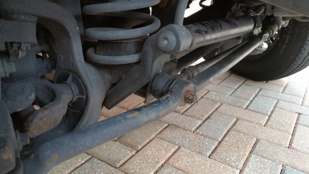

Axle center isn't going to affect how the tie rod end at the drag link/tie rod connection will interfere with the axle side sway bar mount. What will allow that interference is the axle position front to back and/or caster, both of which can be corrected with adjustable control arms. Another cause of this interference is if the drag link at the passenger side steering knuckle has been flattened out through an impact. That can be corrected with a shop press or a new drag link.

I see now that the sway bar bracket image isn't yours. Disregard that, assuming there isn't interference there. This usually occurs at full shock extension while airborne.
