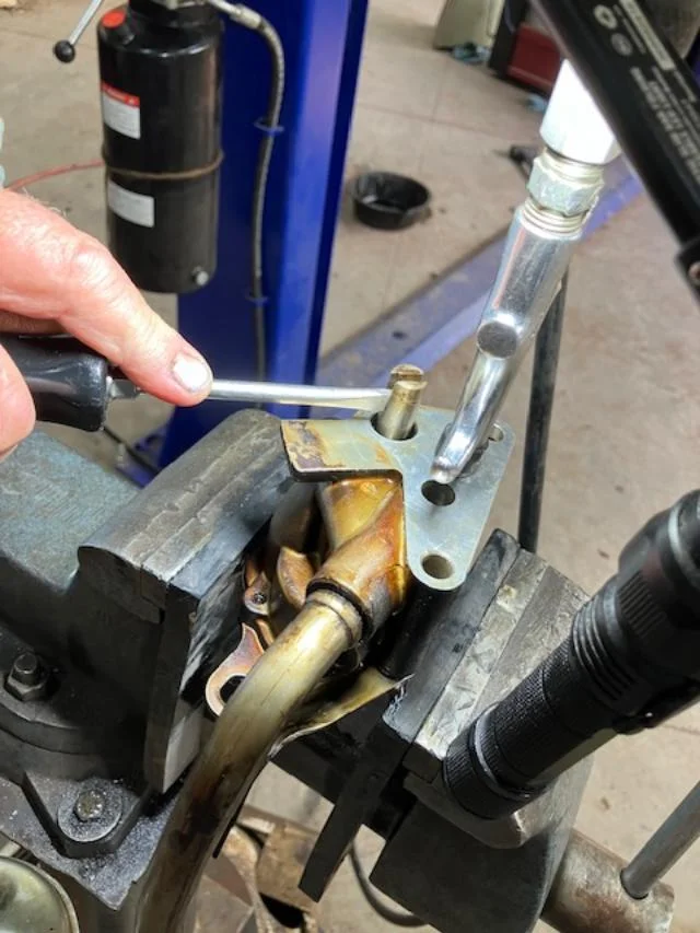

1st step. Clean the oil regulator gauge. Even a tooth pick works.
