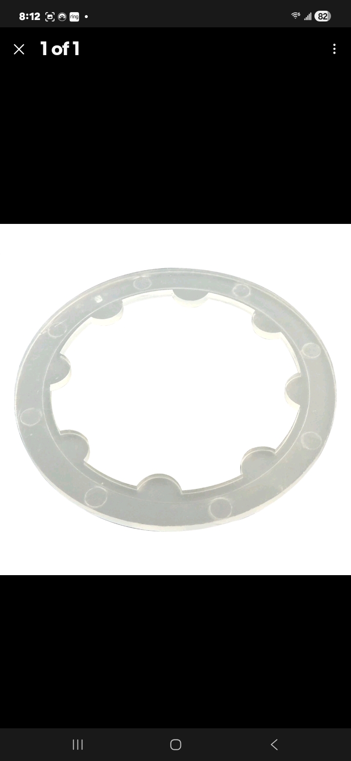

Another issue that popped up is one of the plastic dust shields is cracked and needs to be replaced so I need to order that with nothing available locally.
