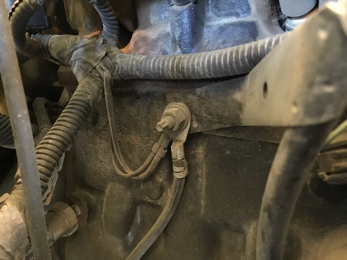

I see you’re from Ohio. Check the ground wires that attach to the right side of the block for a poor connection.
Thanks for the feedback. I checked the ground and it is tight and just has a bit of surface rust. The Jeep doesn't get driven in the winter months so has no rust. I wire brushed and that did not have an effect on the issue.

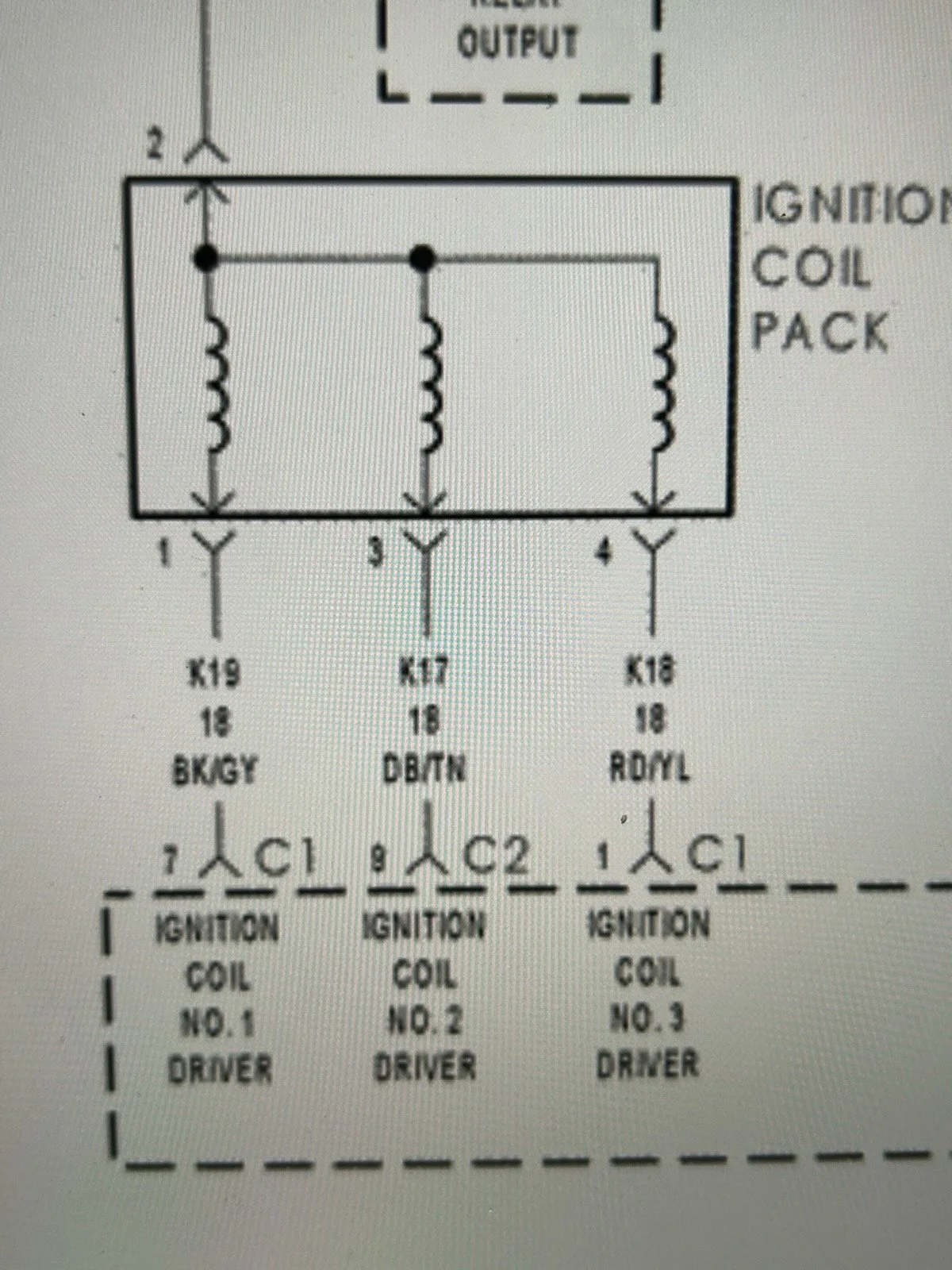

Following up on my previous post in case others find a similar issue. The problem turned out to be lack of continuity in the #3 dark blue wire with the tan trace running from the coil pack to the #9 pin on the C2 connector going to the CPU. This was preventing the coil pack firing #2 and #5 cylinders from functioning. After cutting and soldering in a new wire the Jeep is now running perfectly. I don’t know what caused the issue as I could not find any visible compromises in the wiring harness. Hope this helps someone else.
