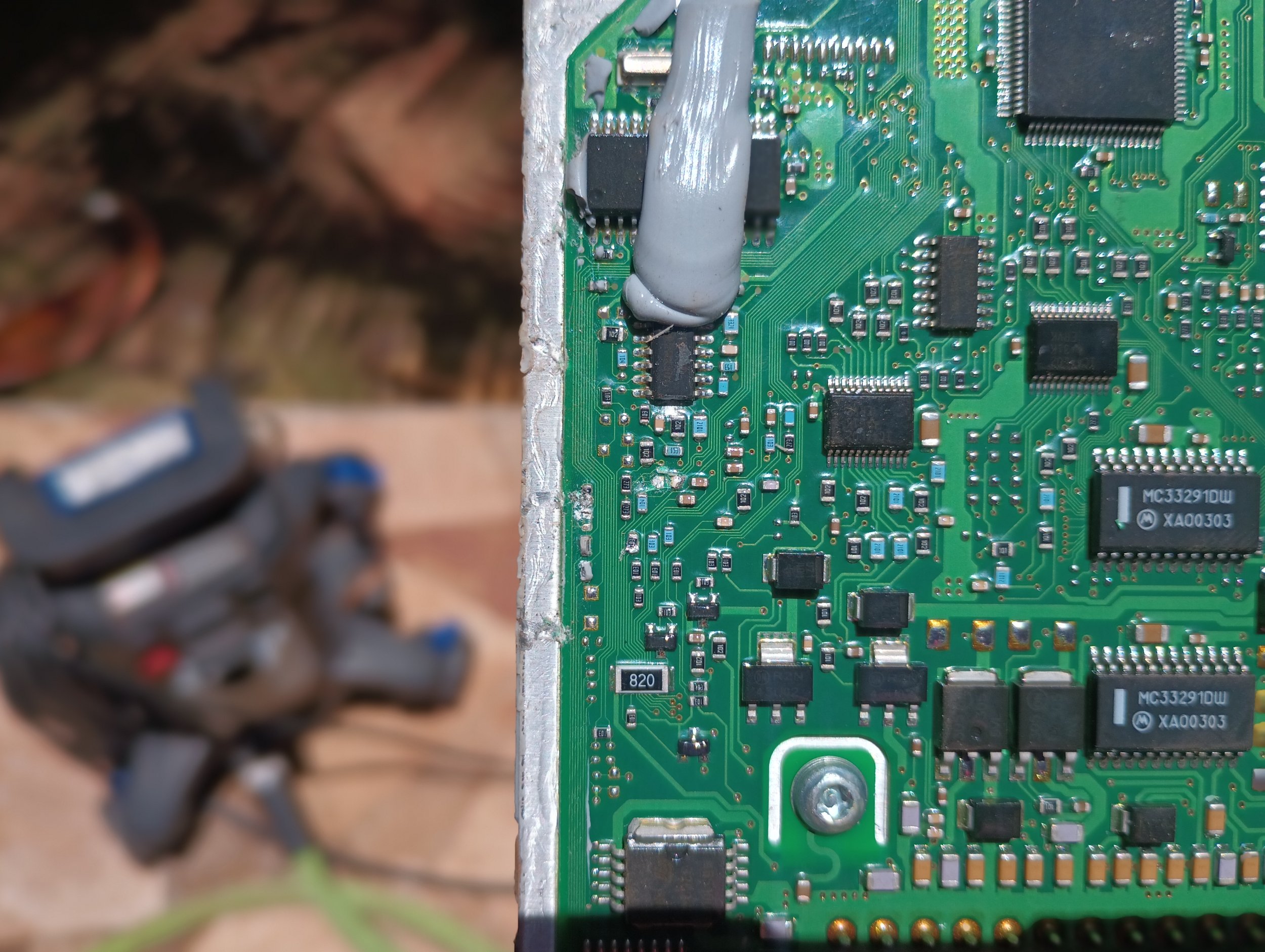

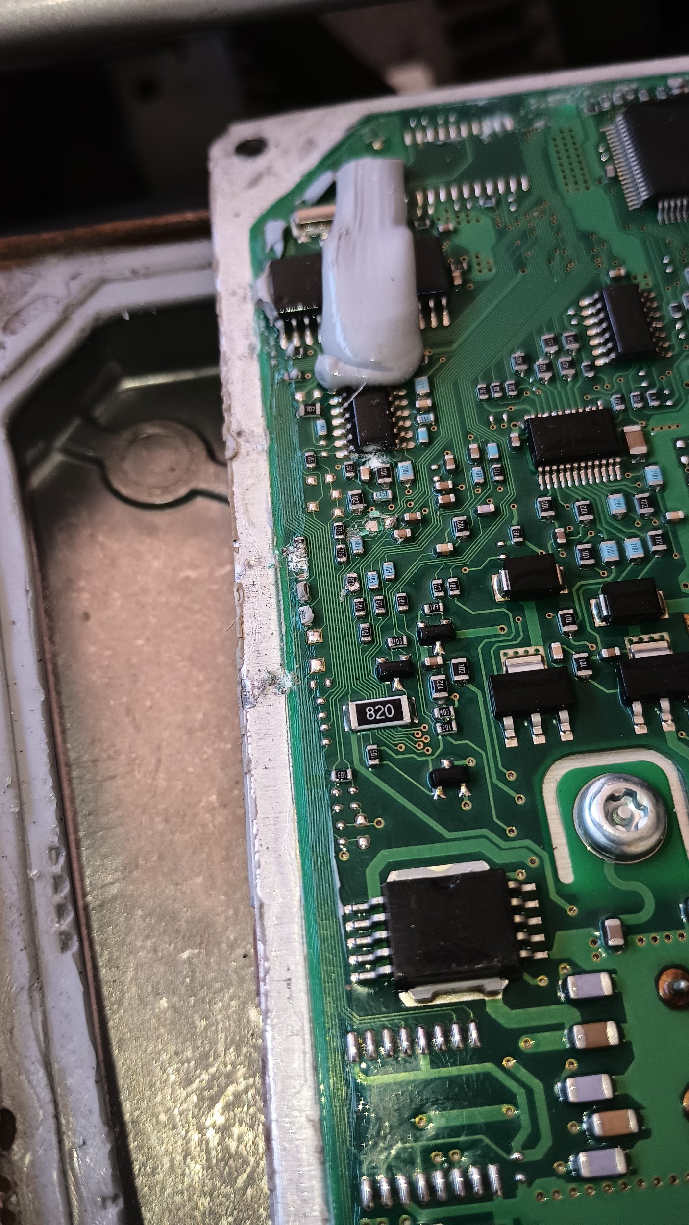

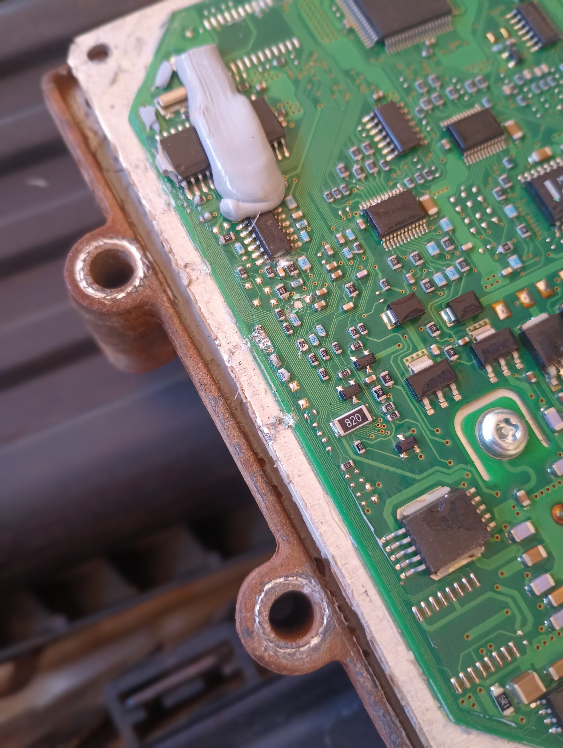

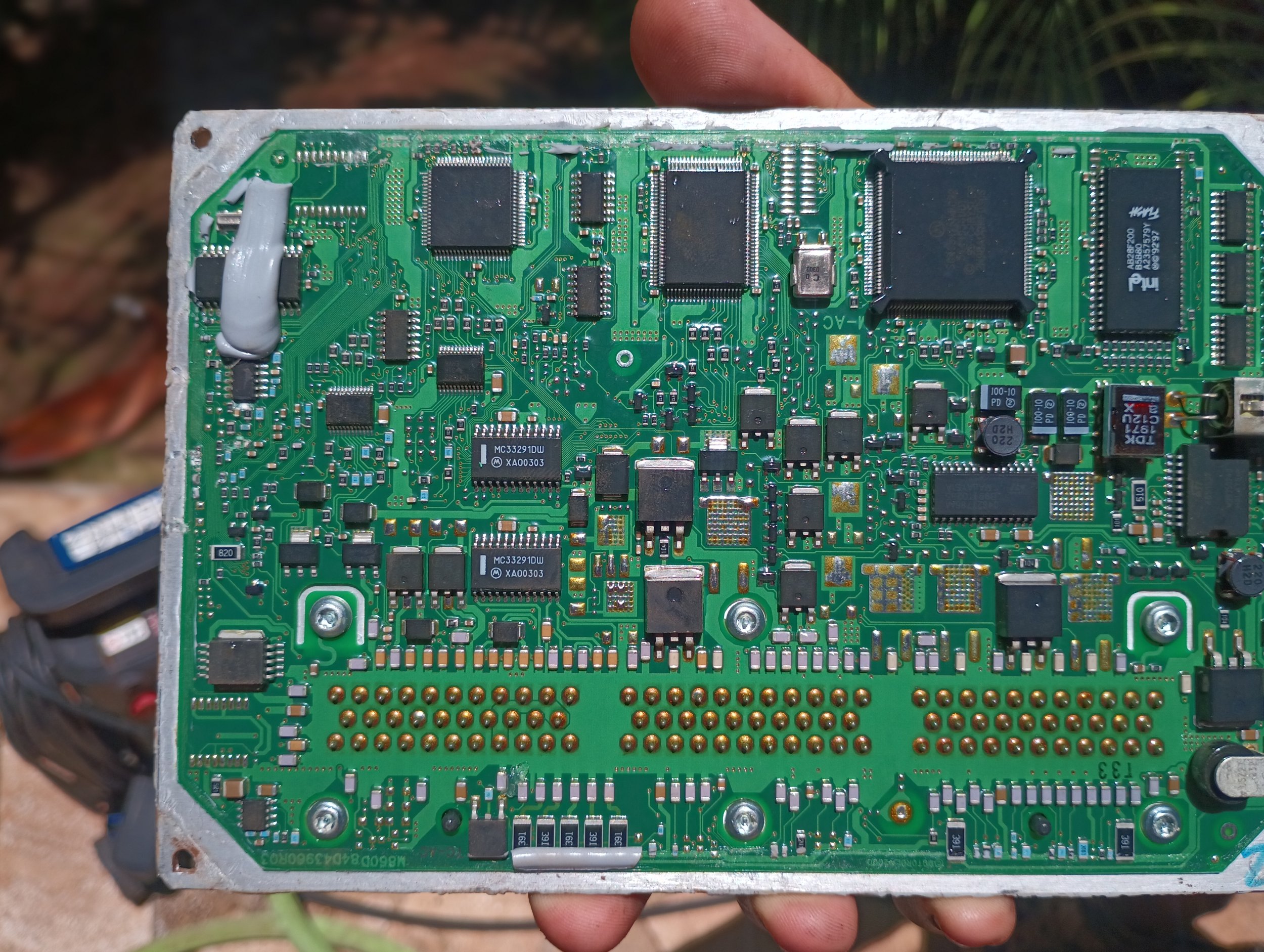

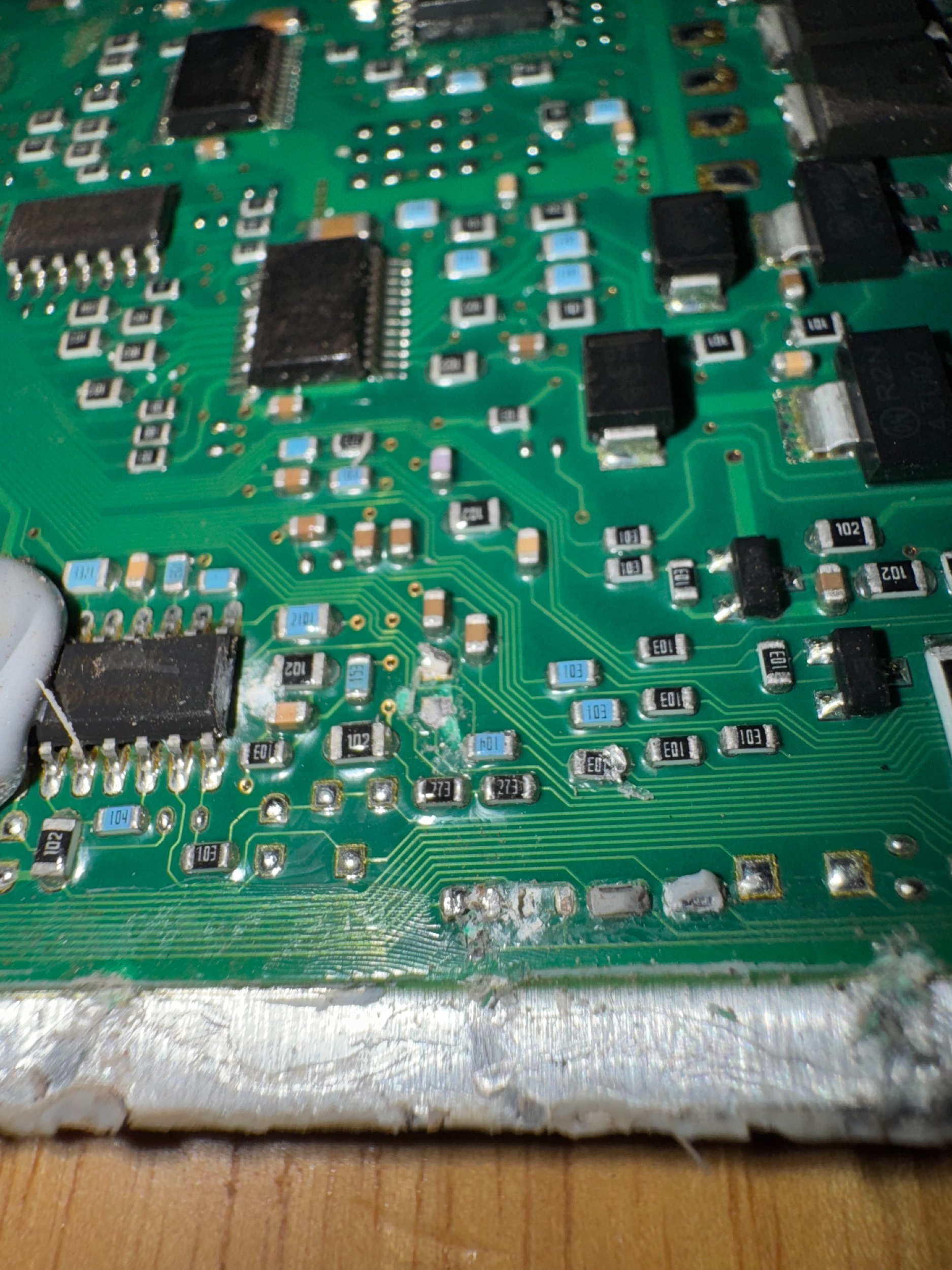

since i cant leave stuff alone lol while changing the valve cover gasket and waiting on paint to dry i decided to take pcm out to look inside... @ Mark, Steve from Hawaii talk to you week or so ago... my son noticed the pcm cover pulling up at the bottom we opened it to this mess... few things broken shorted cracked in half. what yall think repairable? lol

Aloha from Miami
I need the ecm in house in order to determine what’s going on with it. The current turnaround time is one to two days on diagnosis. 🐊
