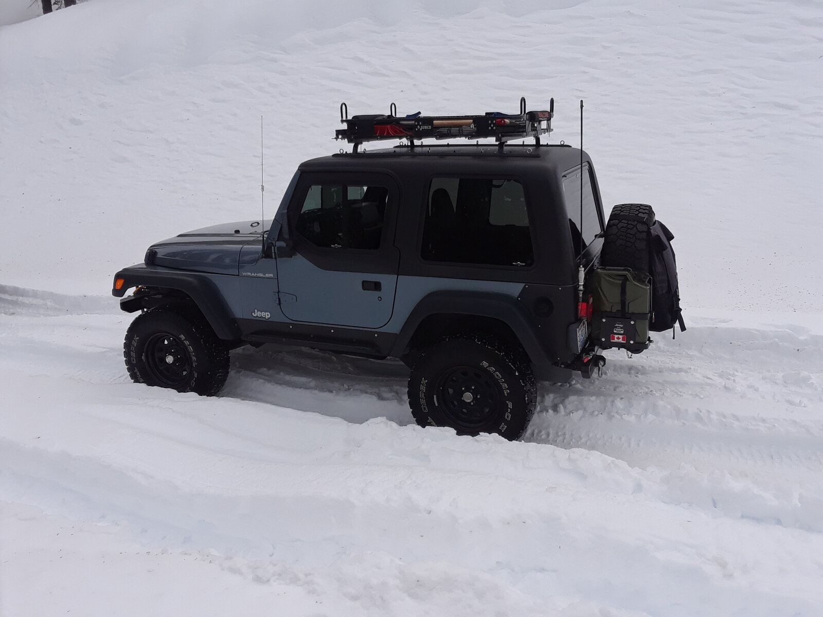

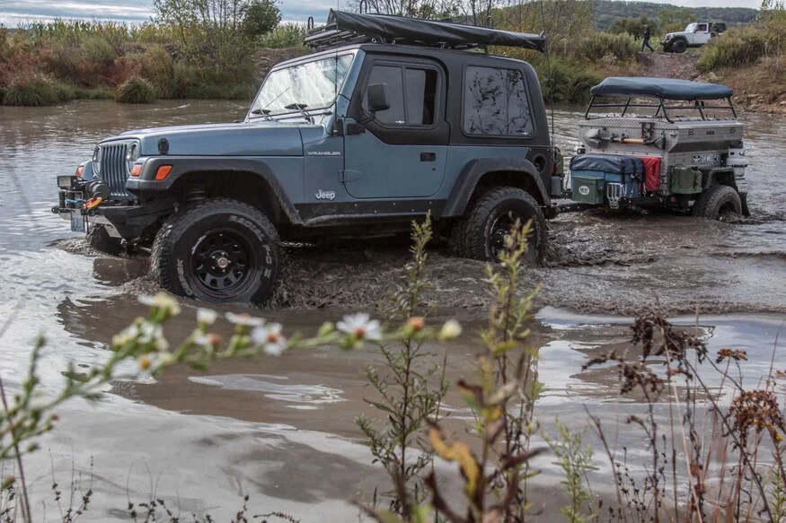

My Jeep: 98 TJ, 2.5/five-speed. Dana 30 front with Aussie locker/Dana 44 rear with Detroit locker. 4.88 gears (don't know if 5.13 was an option in 2008 - sometimes I wish I had 5.13), 33" tires (285/75/16), 3.5' RE lift. Lots of other stuff too. I have fun with my TJ. That's what I've got it for. Fun and adventure.
Sometimes I pull a little trailer.
