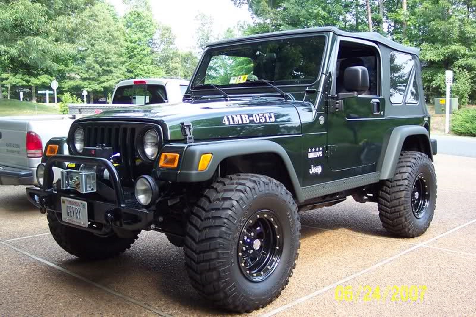

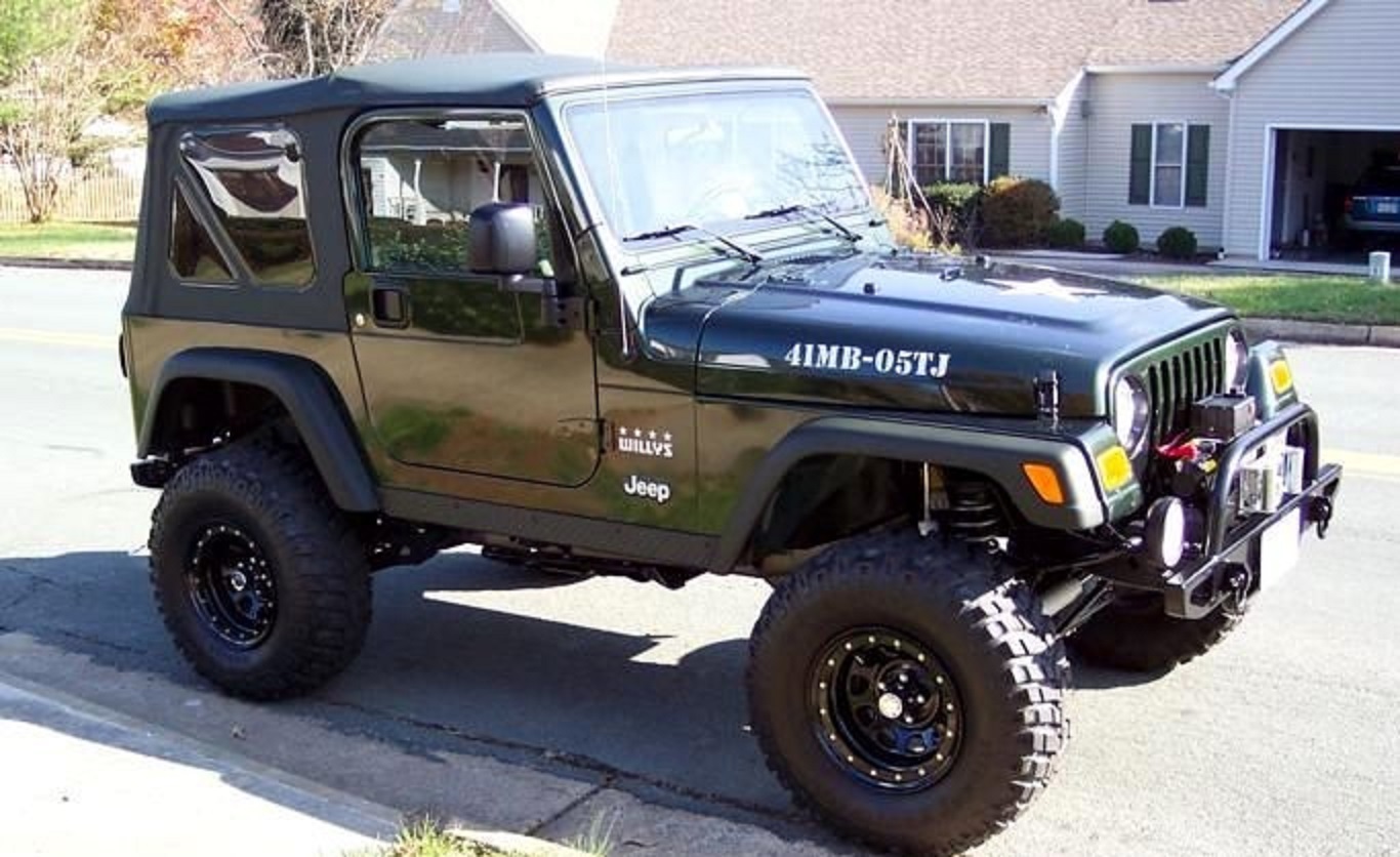

2" SL with a 1" BL and 33s. Springs, shocks, rear track bar relocation bracket, longer bump stops. Dropped the skid 1/2" with washers for slight vibes. A MML was done later on, and the skid drop removed.
p.s. That lift was short lived (Jeep addiction). 😬
Are both pics of the same setup? The bottom one appears to have a higher gap
