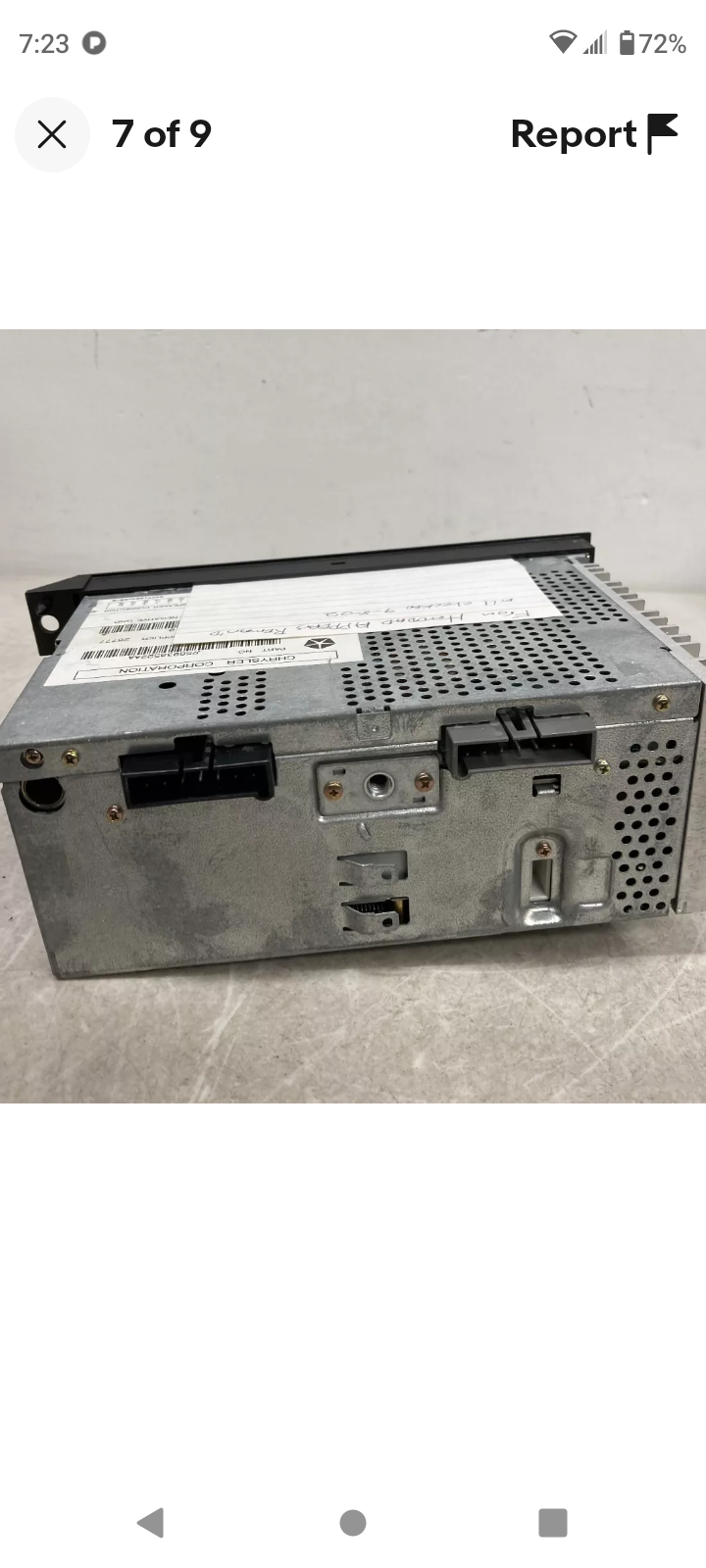

1998 TJ factory radio connections
keef410
Jul 13, 2023
1
New York
I have a 98 TJ with factory cassette player and I am looking to upgrade to a OEM cd player from the same era. There are two rectangle connections on the back of the cassette player and the cd units has the same two connectors, however there's a third smaller connection. In the below photo the I'm asking about is on the bottom right side of unit. What is this connection for? And will this cd player be plug and play for the connections I have? Just curious before buying one.
My guess is that the bottom one could be for an accessory like a factory external multi disk CD player. Of course, factory players and CD's are obsolete anyway.
The black and grey plugs will connect and operate the radio normally, the extra plug is probably for steering wheel controls

The two main plugs are sometimes called "twin 7 plugs". If your current stereo has them, then yes any other one with them should be plug and play.
That two-prong plug you're asking about ... I can't remember right now what it's for, but I think it was an anti-theft feature. I remember looking into it once, then learning that it wasn't anything to worry about. I have swapped in stereos with any without that plug, and have had no trouble.

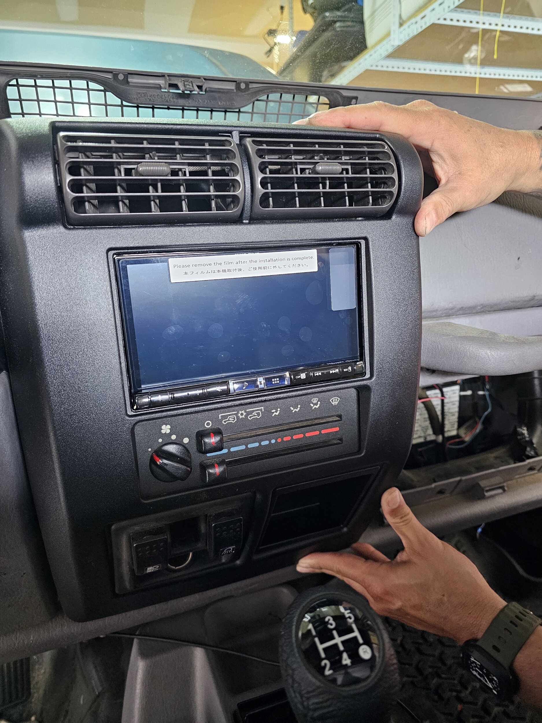

I guess you're right. Now that I think about it, it was easy pulling the center console off and replacing the head unit. How about one of these barking gaurd dog cassette tapes they used to sell back in seventies for home protection? 🤣
My boss 10 inch touchscreen with rear camera and wireless Android Auto is detachable leaving just a big hole. I have a Alpine PDX-V9 mounted completely out of sight under my steering column with a special kit. My stereo is legendary and I take care of it. I keep a small shoulder carrying bag behind my front seat. The screen removes in about two seconds by pressing two buttons behind it. The screen goes in the bag and comes with me. If I park in downtown Long Beach, obviously the stereo is coming with me. If I go to the pier, and use public parking, the stereo comes with me. I learned my lesson more than 30 years ago and vow not to repeat it. We have a gate and a guard at work so, I don't worry about it at work.

FYI, you can also find these on eBay and Facebook marketplace. Any stereo from a 97–02 TJ (with square corners, not rounded corners) will fit and work for you.
