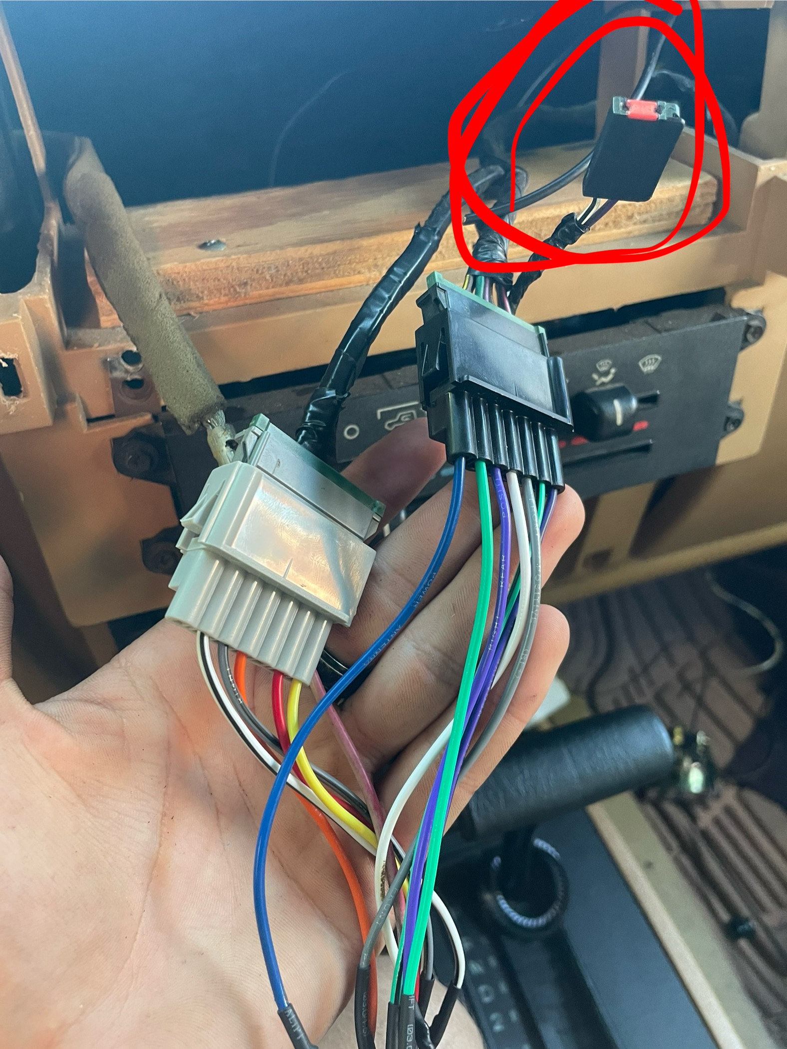

Installing a new radio on my 97 TJ and I was wondering if this CCD Bus connector has another plug inside the vehicle or if it attaches to the radio?
Wonder if this is a quirk of the 97s. CCD is Chrysler collision detection bus... suppose to go to the cluster, PCM and airbag module...no mention of it going to the radio...
I don't recall seeing that connector on my 97...but my PO installed an aftermarket radio (that I reinstalled because rat tailed connections wrapped in electrical tape didn't meet my standards.)
Safe to say it doesn't go anywhere.
Wonder if the factory radio did something when the airbags deployed like a noise. Hmm.
-Mac

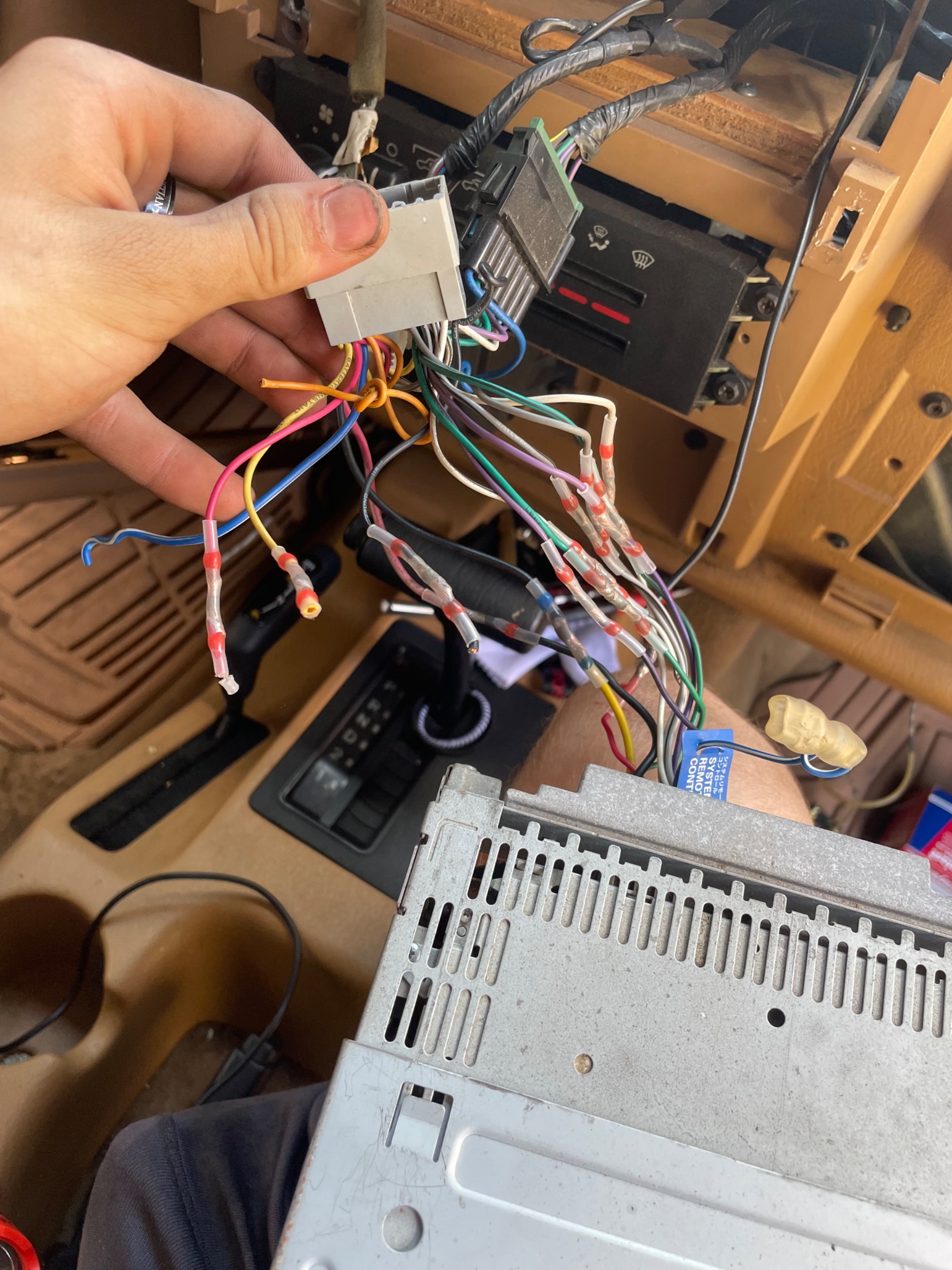

I added some pictures of the crap that was pulled on my headunit before me. Not to mention there was a piece of house wire running through my jeep to my cluster….
Looks like my previous mess.
