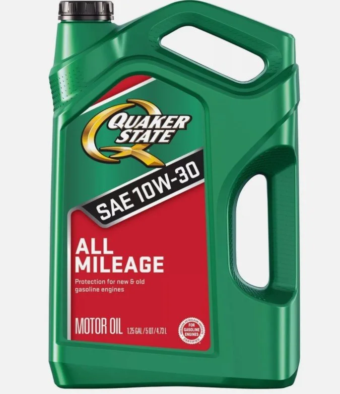

You can buy Quaker State conventional 10W-30 and 10W-40 ALL MILEAGE at Wally World in gallons and quarts. Worked for me.

If it says Conventional right on the bottle you have in your hand, it's conventional. Otherwise it's not, no matter what Wally World or Amazon or anyone else says, or what old photos they show you.
Most manufacturers quietly stopped making full conventional a few years ago. Check their websites. Pretty much every "conventional" oil people are still using are actually a syn-blend.
