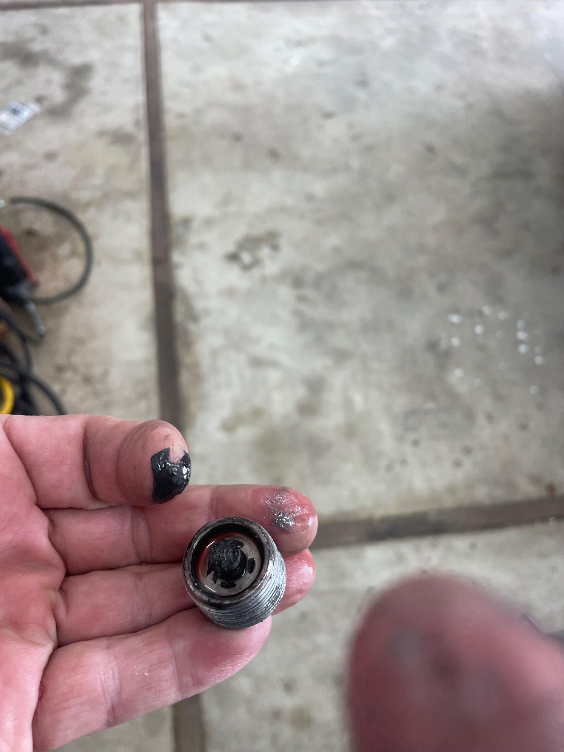

Just finished a transmission fluid change:
1. Surprised at how much easier it is compared to my 98 Sahara
2. Transmission still notchy but the whine is gone or majorly diminished
3. The amount of metal attached to the magnetic plug is surprising; quite possibly fluid hasn't been changed in a while or maybe original?
This is 1/4 mile on an overhauled nsg from an 05 LJ, second transmission.

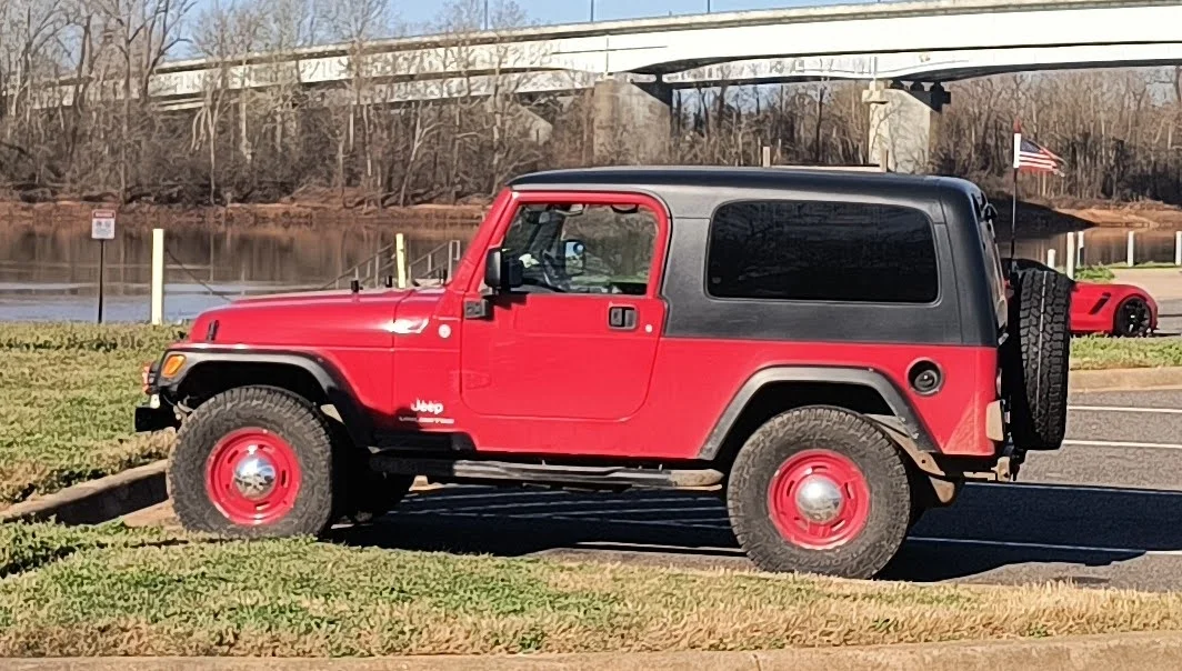

Two inches of lift with 33 inch tires . Next time I get tires I may go back to 32 inch tires . The difference in ground clearance is about half an inch between 32's and 33's .
Good idea. I understand wanting bigger tires to fill the space in the wheel well, but that doesn’t give much space at all without hitting the wheel well
