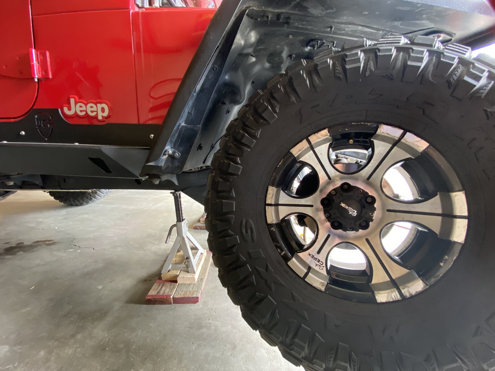

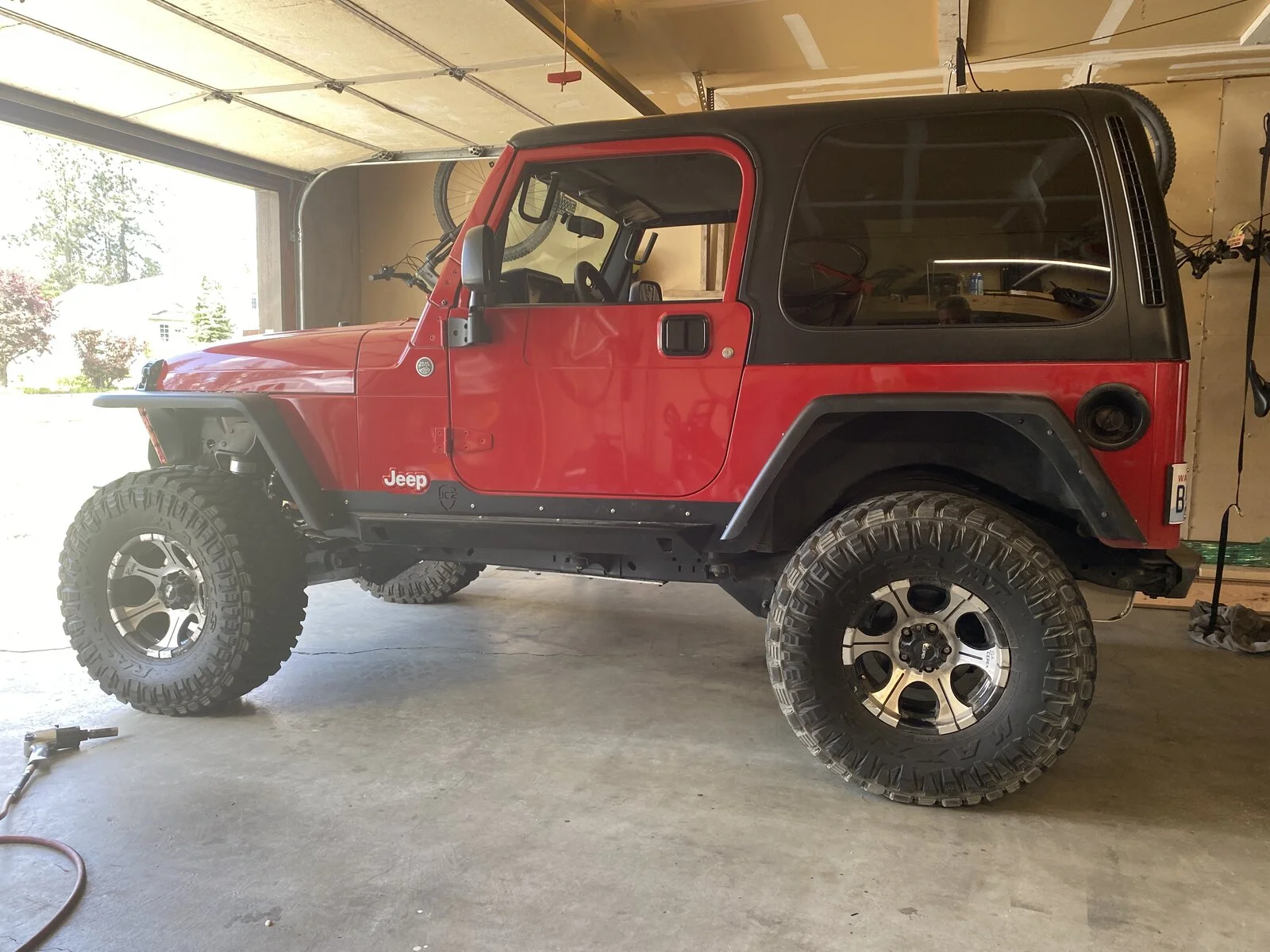

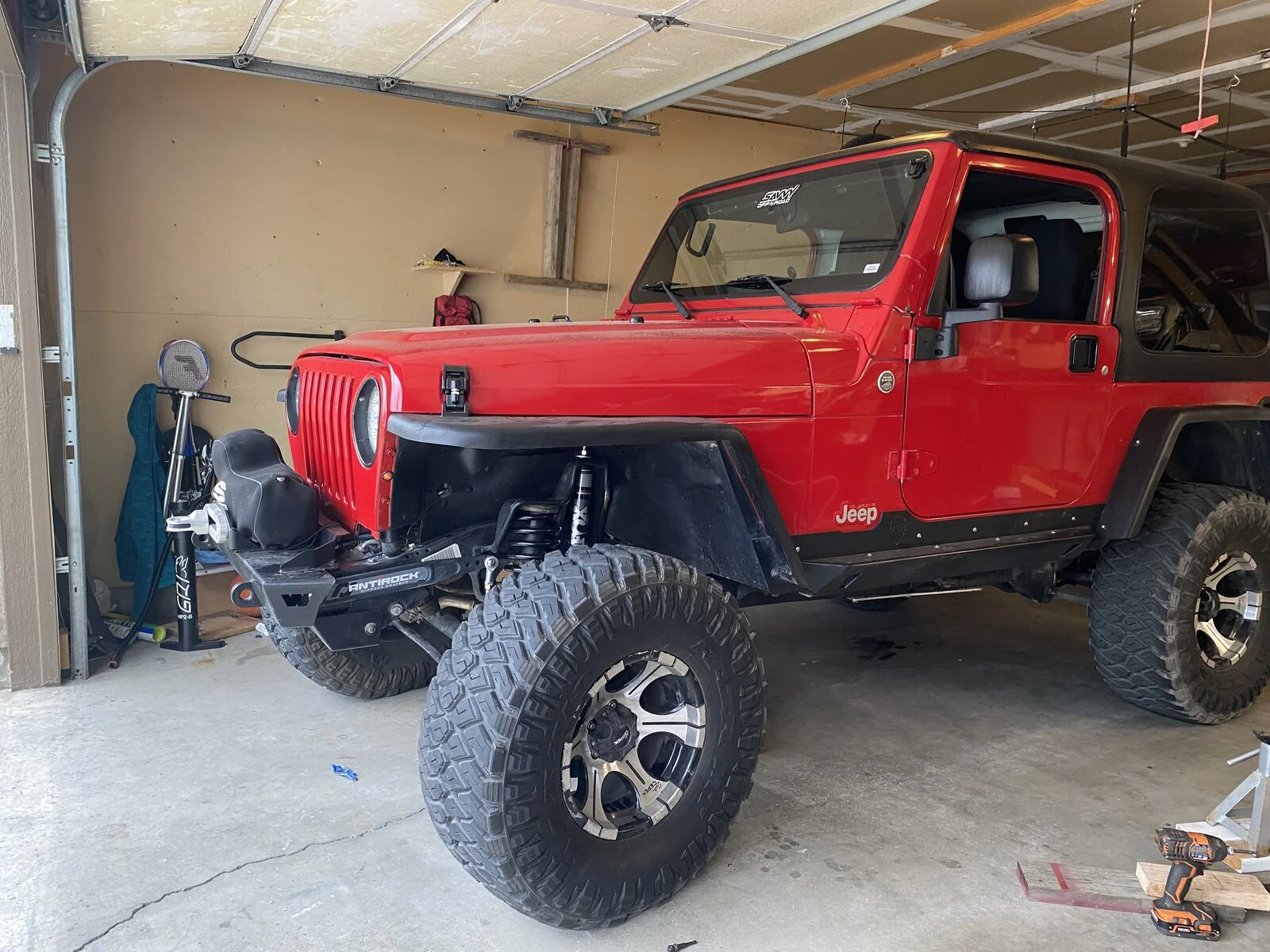

The only thing missing is 35s!This is the last picture of my rig at 3.5” SL.

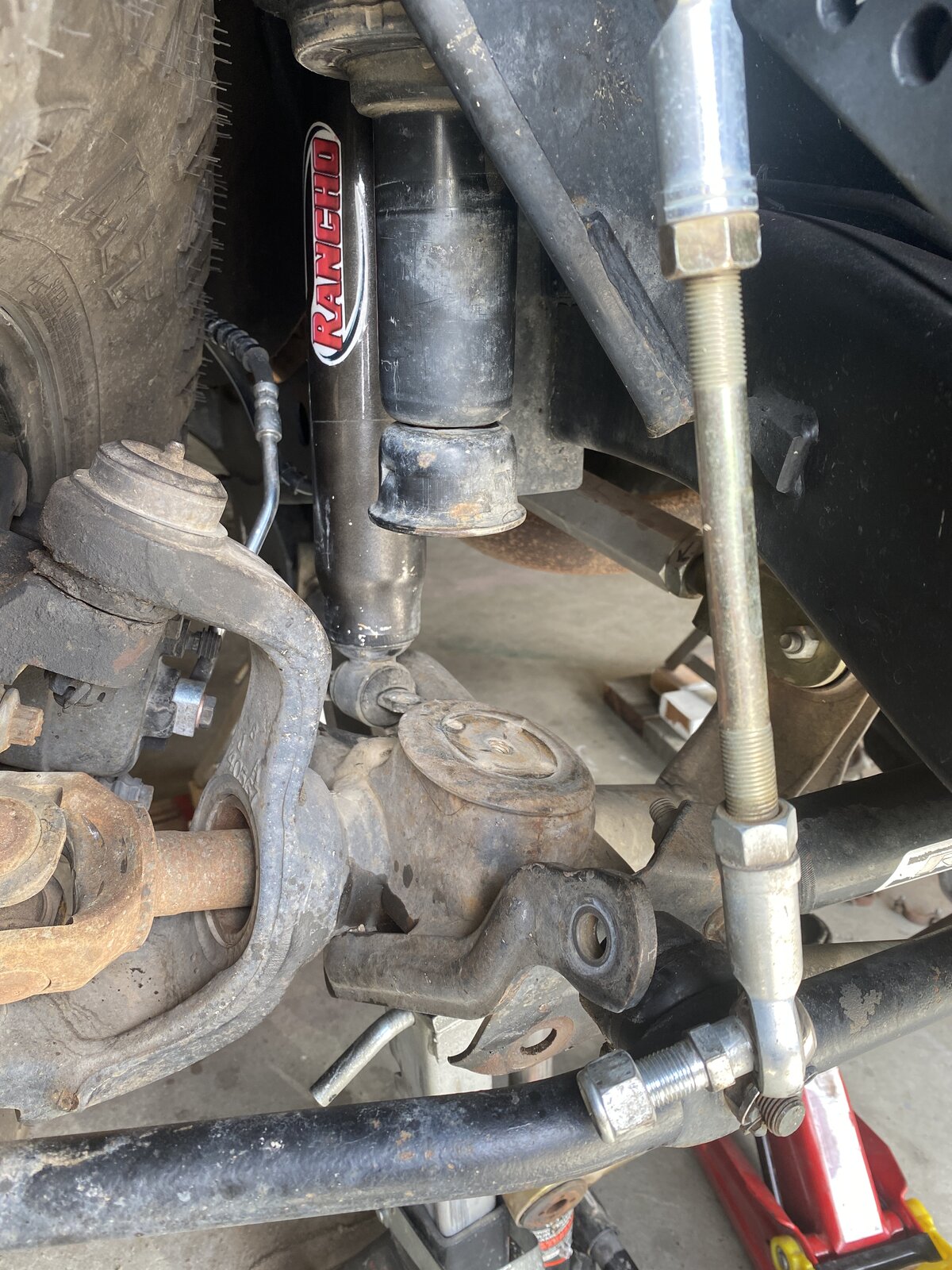

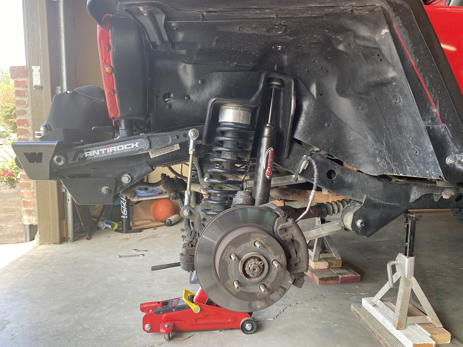

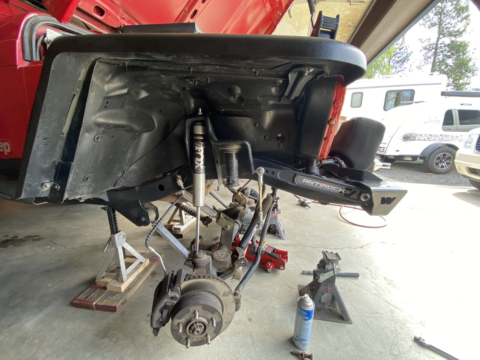

Moving to Currie 4” Coils + Fox Savvy TJ Valved shocks and moving my OME 2” Coils + Rancho 5000X (55239/41) over to the Twin’s ’04 Sport. Here’s a last look at the front OME’s and Rancho‘s on my rig. Note the 1.5” aluminum spacer.

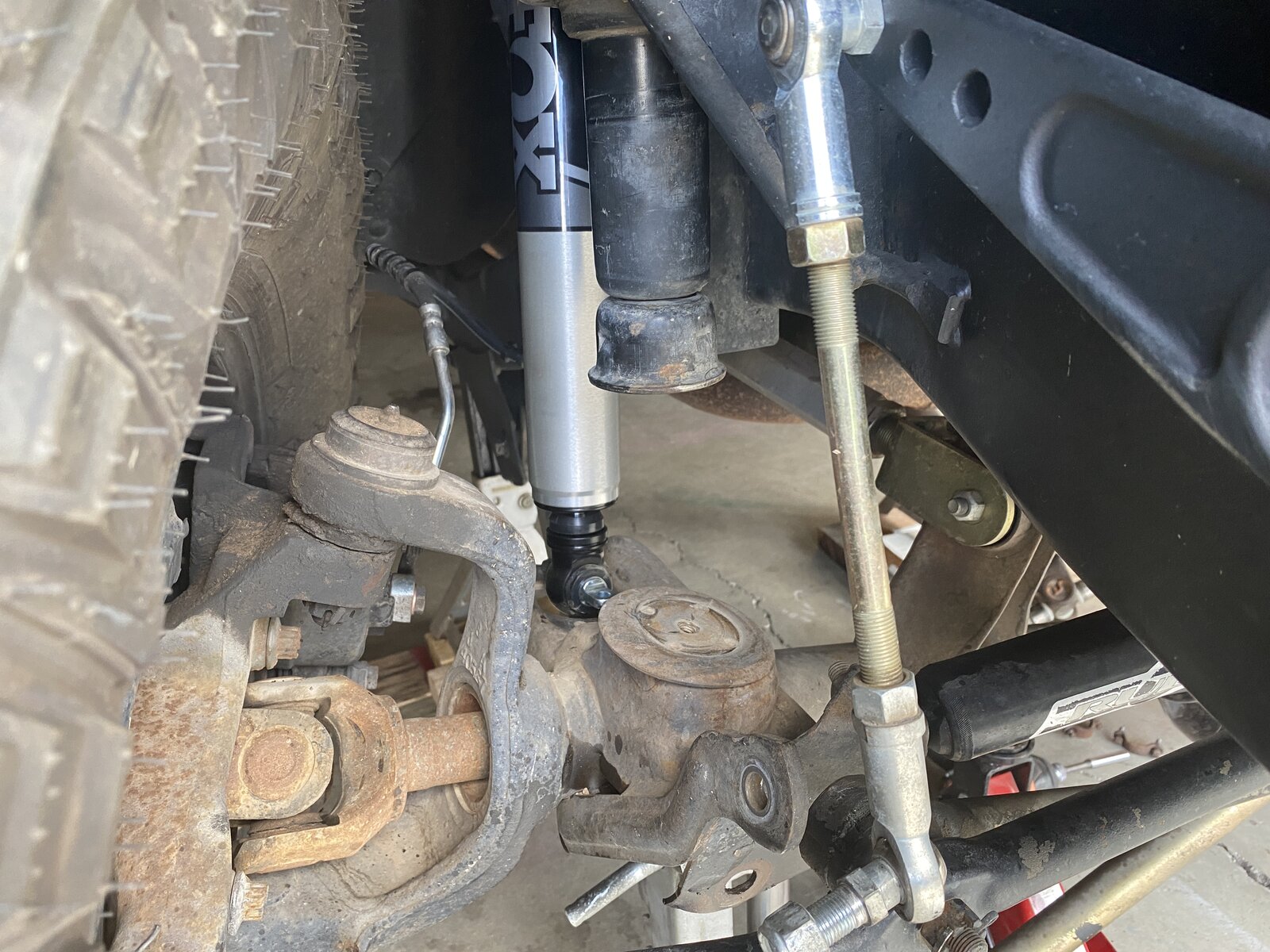

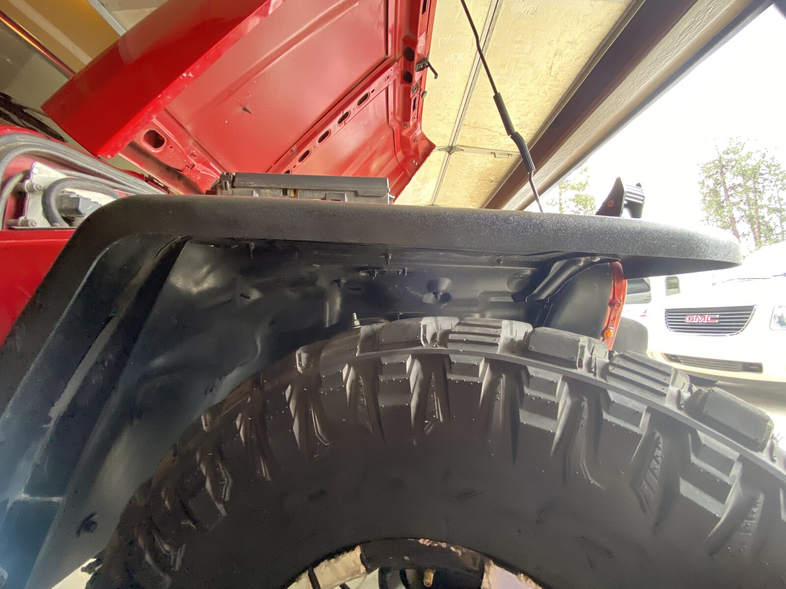

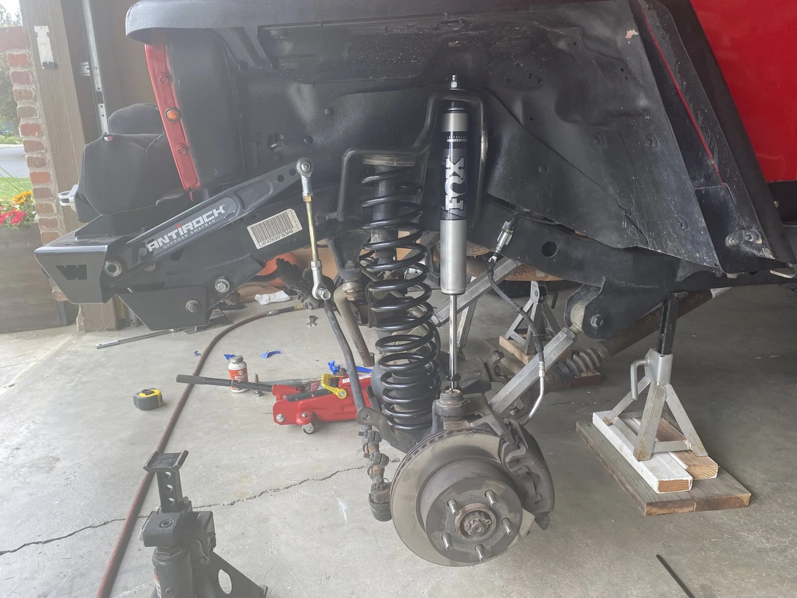

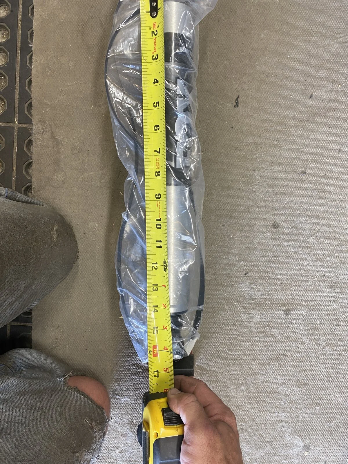

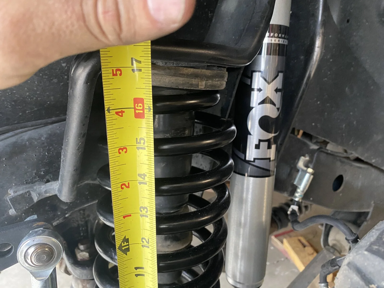

I measured the Fox Savvy TJ Valved shocks in preparation for cycling the suspension. Front shocks are 16.25” from eye to base of stud. Shocks ‘look’ aesthetically pleasing. When I cycled the suspension I was not so happy. 4” bumpstop needed for shocks.I’m not sure what the deal is at this point. These shocks are designed by Savvy to pair with 4” Currie Coils on a TJ, which is what is going on this rig. That’s going to put me at more down travel than up travel, which does not make me happy. I went ahead and put the tire on and plenty of clearance at full passenger lock. Driver rubbed on the Anti-Rock, no surprise there, plenty of space up and behind. When I go to 35’s there will be no tire clearance issues with this setup, and that may be the reason Savvy had Fox build the Shocks this way. Out of frustration, I removed the Fox Savvy TJ Valved shocks and put the Rancho’s back on, went to full compression of the shock and needed 2.5” bumpstop. When I put the tire on it was getting quite a bit closer to the MCE flares. With 35’s I think I’d clear them, but at full lock I’m sure I’d push the flare out of the way and the tire is close to rubbing the upper shock housing and may with 35’s, it’s hard to say for sure. When all was said and done I added 3” bumpstop (hockey pucks) to the 3/16-18 tapped lower perch. I‘m not happy with the MetalCloak front trackbar. The clearance is fine, but he stupid flag nut stripped, and this is the second one to strip (you basically get one use out of them, WTH?). Fortunately, they sent me two last time (must be a known problem, fix that crap MC). I’ll be selling the MC front trackbar sooner than later. Axle is centered though. Adjusted the steering so it’s all straight. I’ll do the rear tomorrow or Thursday. I took it for a spin and it rides well, but I still have the Rancho’s in the rear, so who knows the real story? I’ll know more tomorrow. I’m not happy with how much up I have. (4.2”, crap!) I don’t see that improving when I do the rear. Total lift up front currently, 4.5”.
Which brand highlines?Really the fix is to move the lower shock mounts, at least that’s what I thought with mine. For the stock setup it all worked well, but now that you’re long past that you could keep some of the up travel and get closer to the 50/50ish bias it sounds like you want.

Yes, this setup looks like it is designed to maintain factory travel. 4”. Well shit. I should have got the Rancho’s, they’re $400 cheaper and I might be able to get 5.25” up.Really the fix is to move the lower shock mounts, at least that’s what I thought with mine. For the stock setup it all worked well, but now that you’re long past that you could keep some of the up travel and get closer to the 50/50ish bias it sounds like you want.
