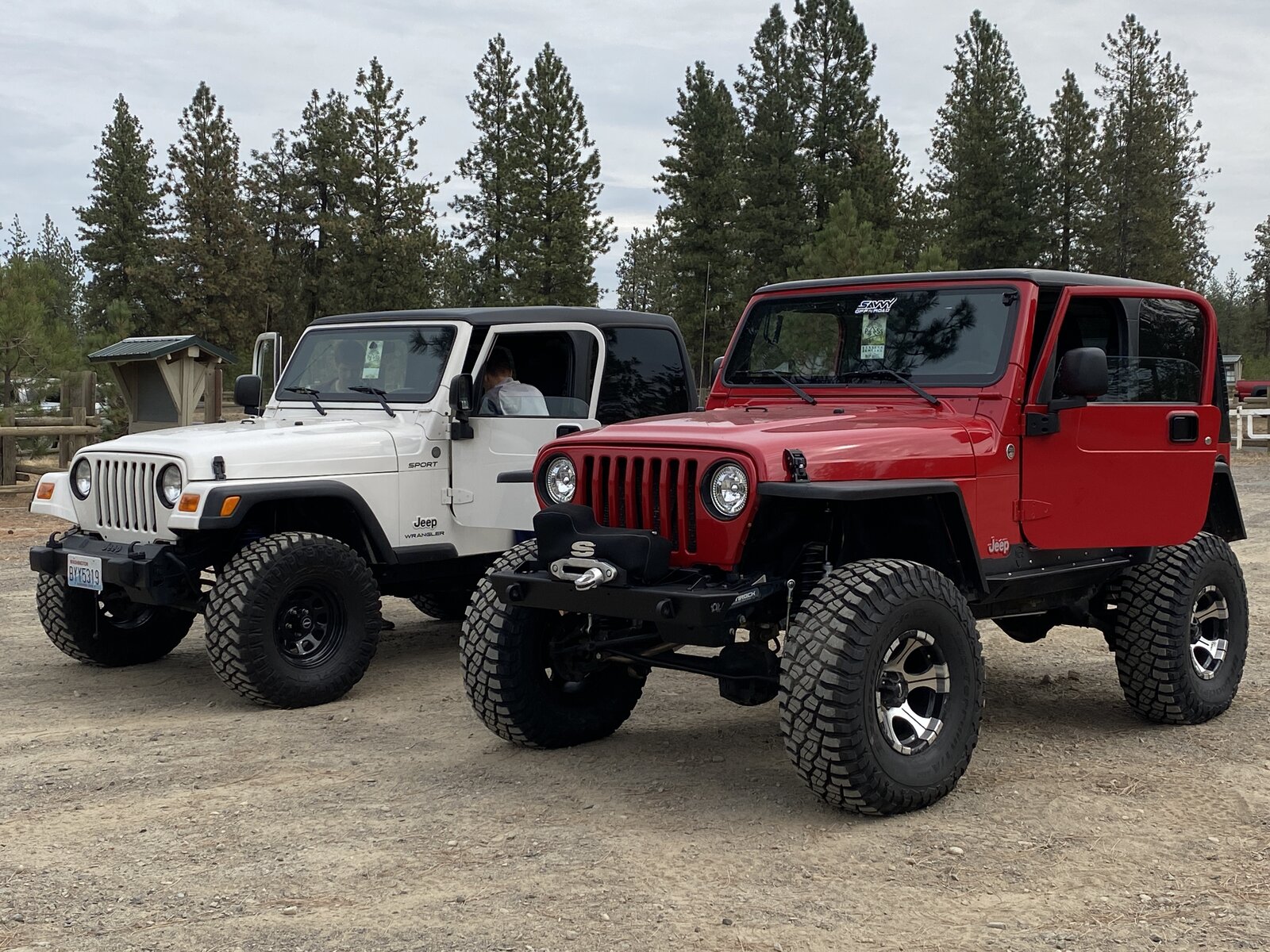

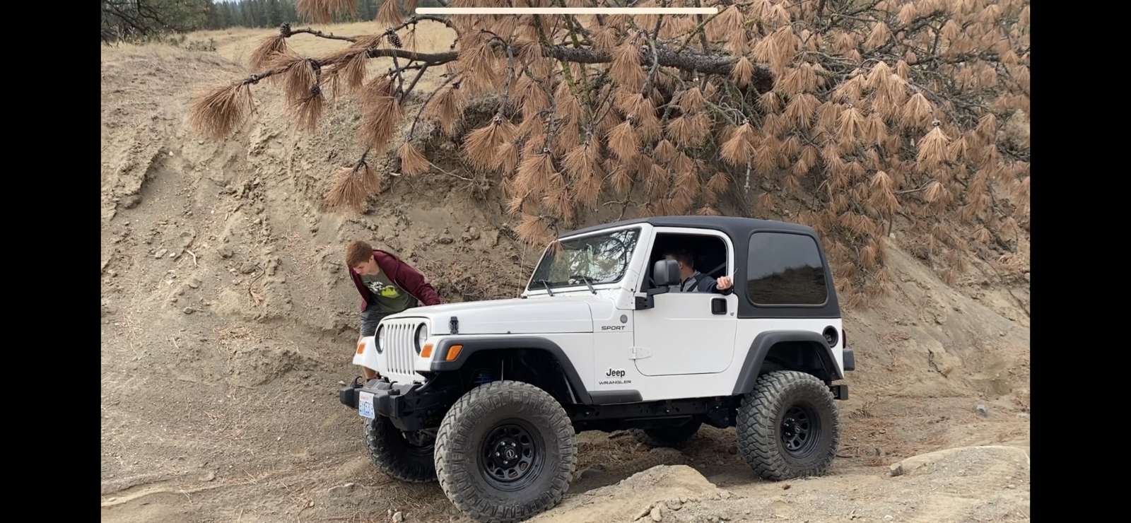

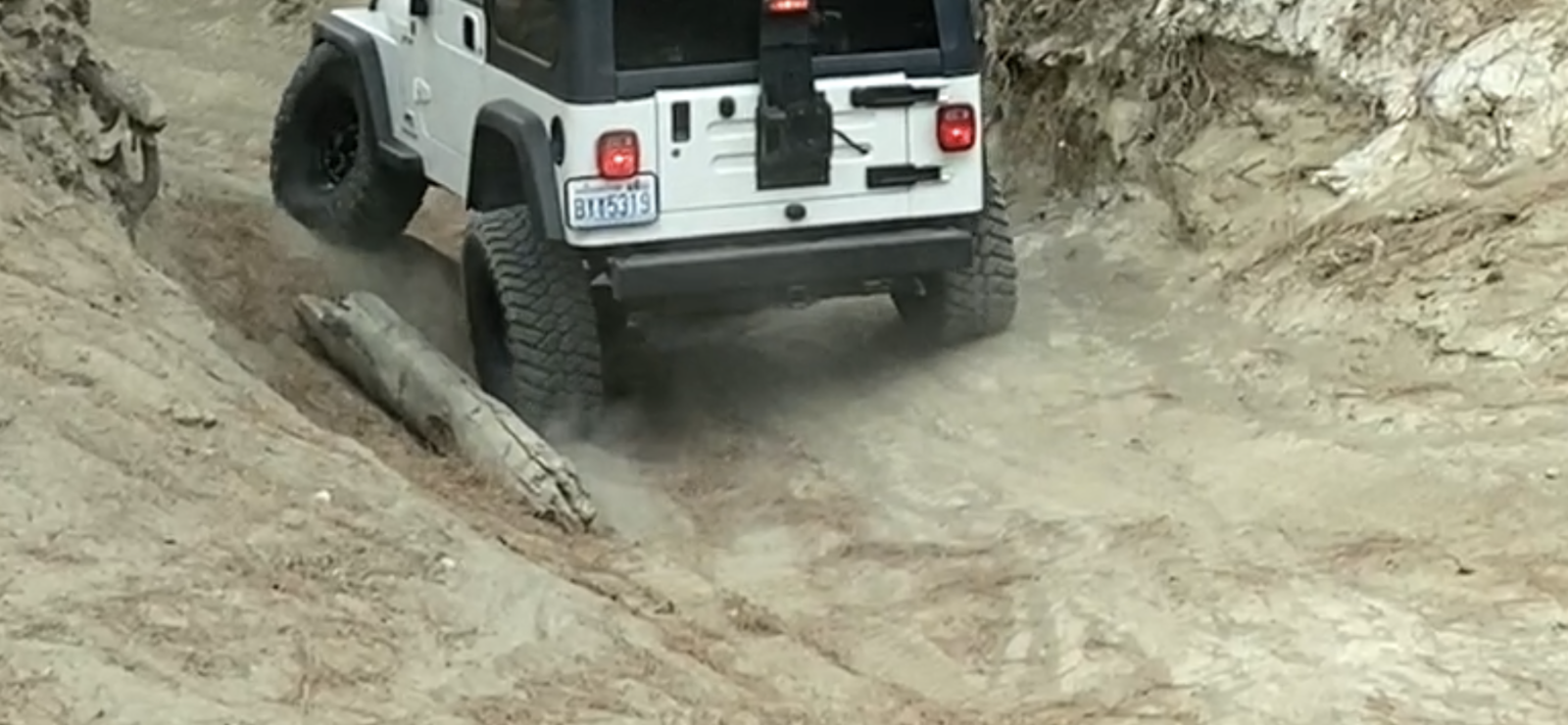

OK so now we want to hear about their first trip out with the Jeep. How did it go? Any pictures? Any damage?
Reactions: Alex01
Went great. Picked up a guy and his Yota while were out there. I have some videos, but not uploaded to YouTube yet. Here’s a few pics.
What did the twins think? Are they getting as HOOKED on wheelin as dad is? Do they traded off on driving? Great pictures.
Yeah, they switched driving every once in awhile. We celebrated their birthday today and they chose to go wheelin’, so must be something they were looking forward too! They did say it was fun! Hopefully get some vids up soon!

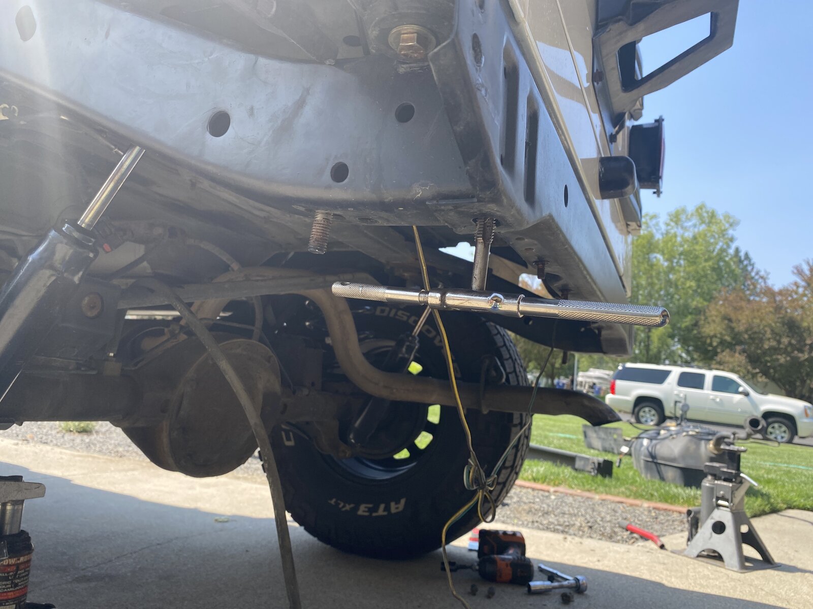

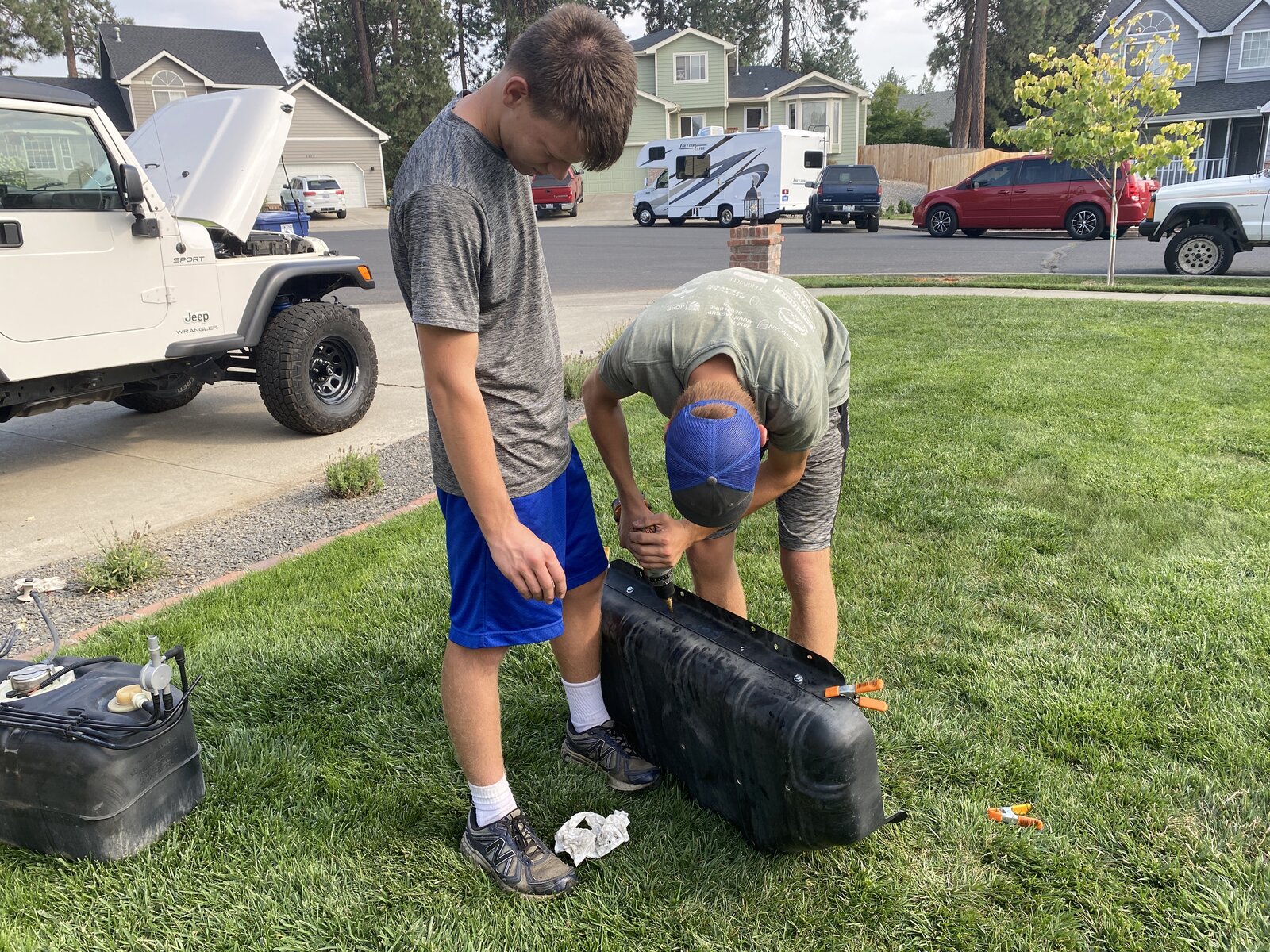

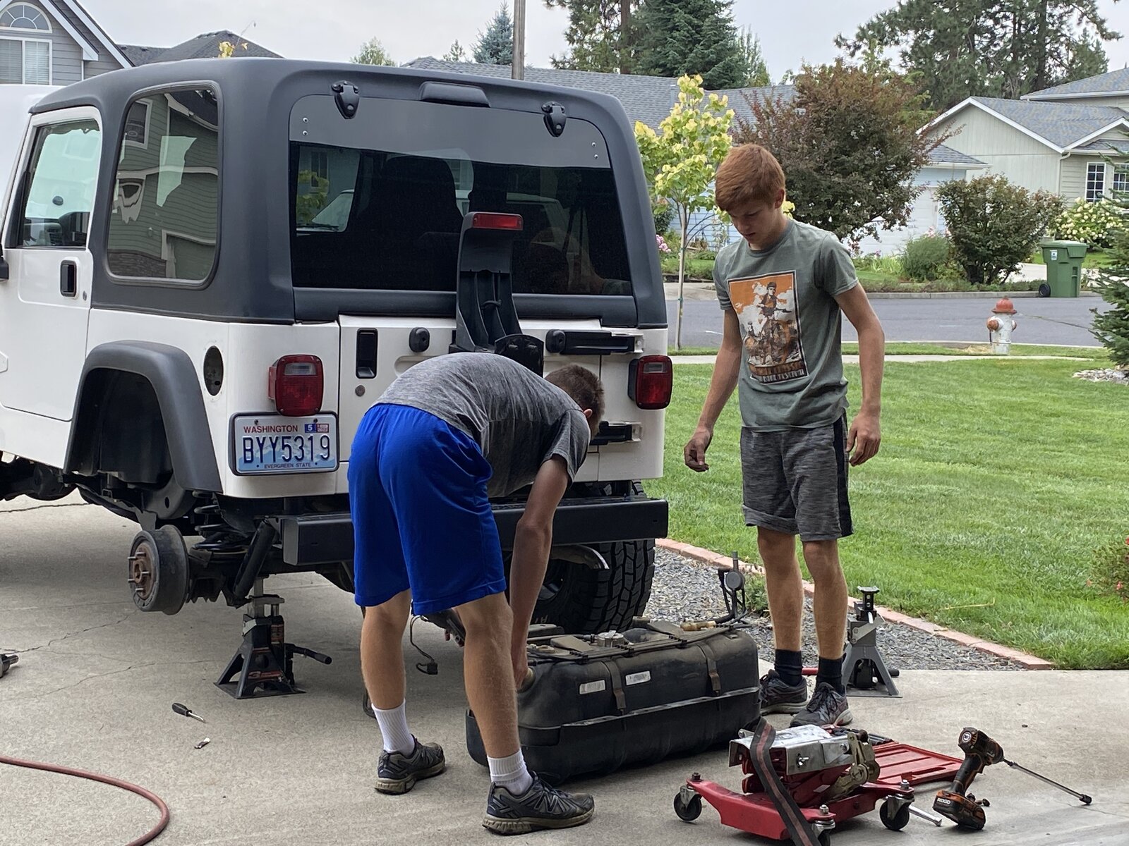

Day 150: the twins got to work on the GTS Mod. We’re going to raise it 1.25”. This will solve the gas tank fill tube being too short after the 1.25” BL. It will also give some added clearance, and we all know “every inch counts.”
They also had two stripped frame nuts that attach the lower bumper, so we tapped it to 1/2-13 and we’re good to go now. Last pic shows that process.
I think this took longer than they expected, but they were fine with it. We’ll finish tomorrow. Well worth the time and effort if all goes well. They really want to do the frame tuck. We have to learn to weld to do that trick. They’re talking about learning. I’m thinking about getting a welder. “We could do so much,” they say.View attachment 271970View attachment 271973View attachment 271972View attachment 271971
