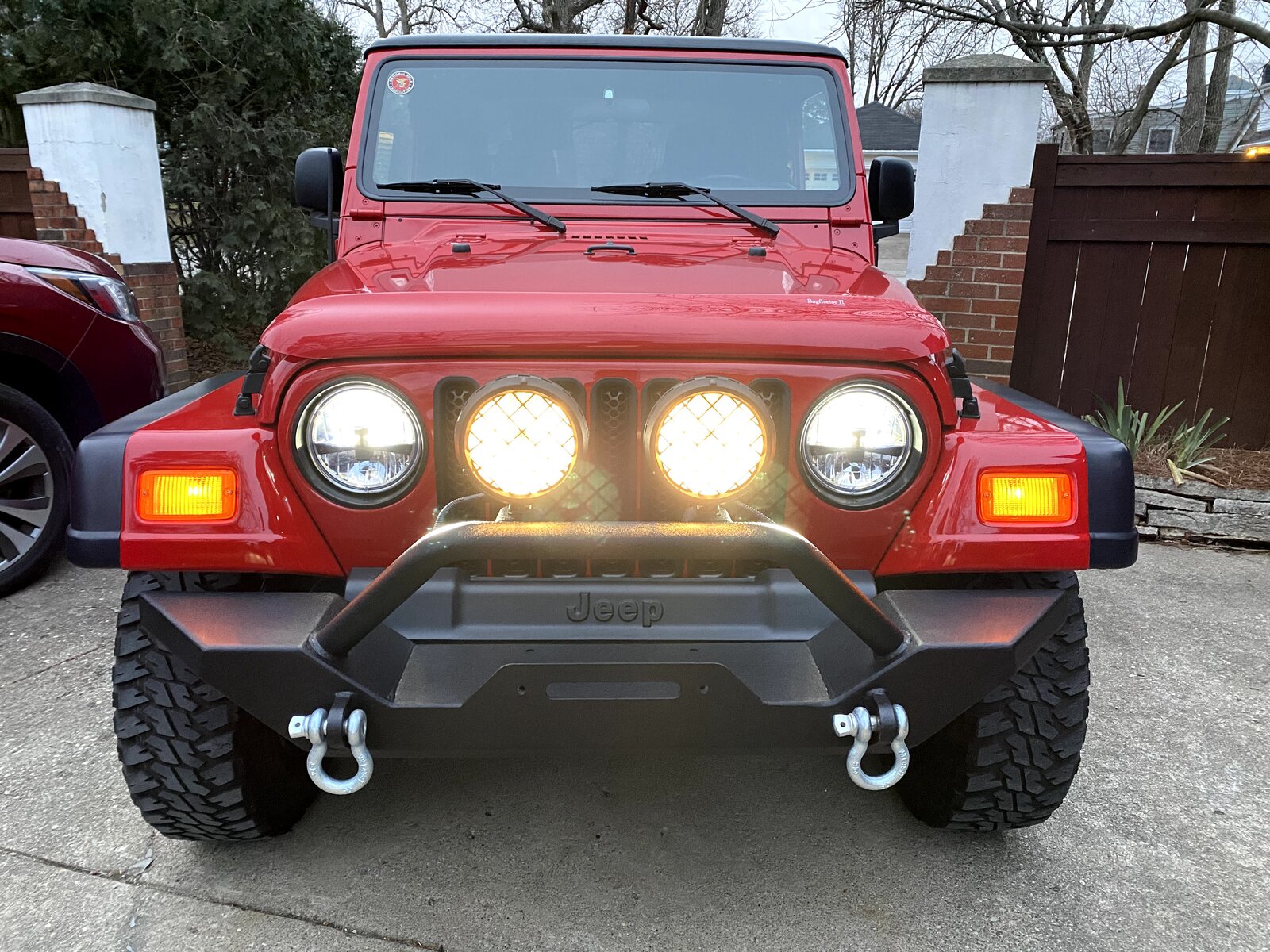

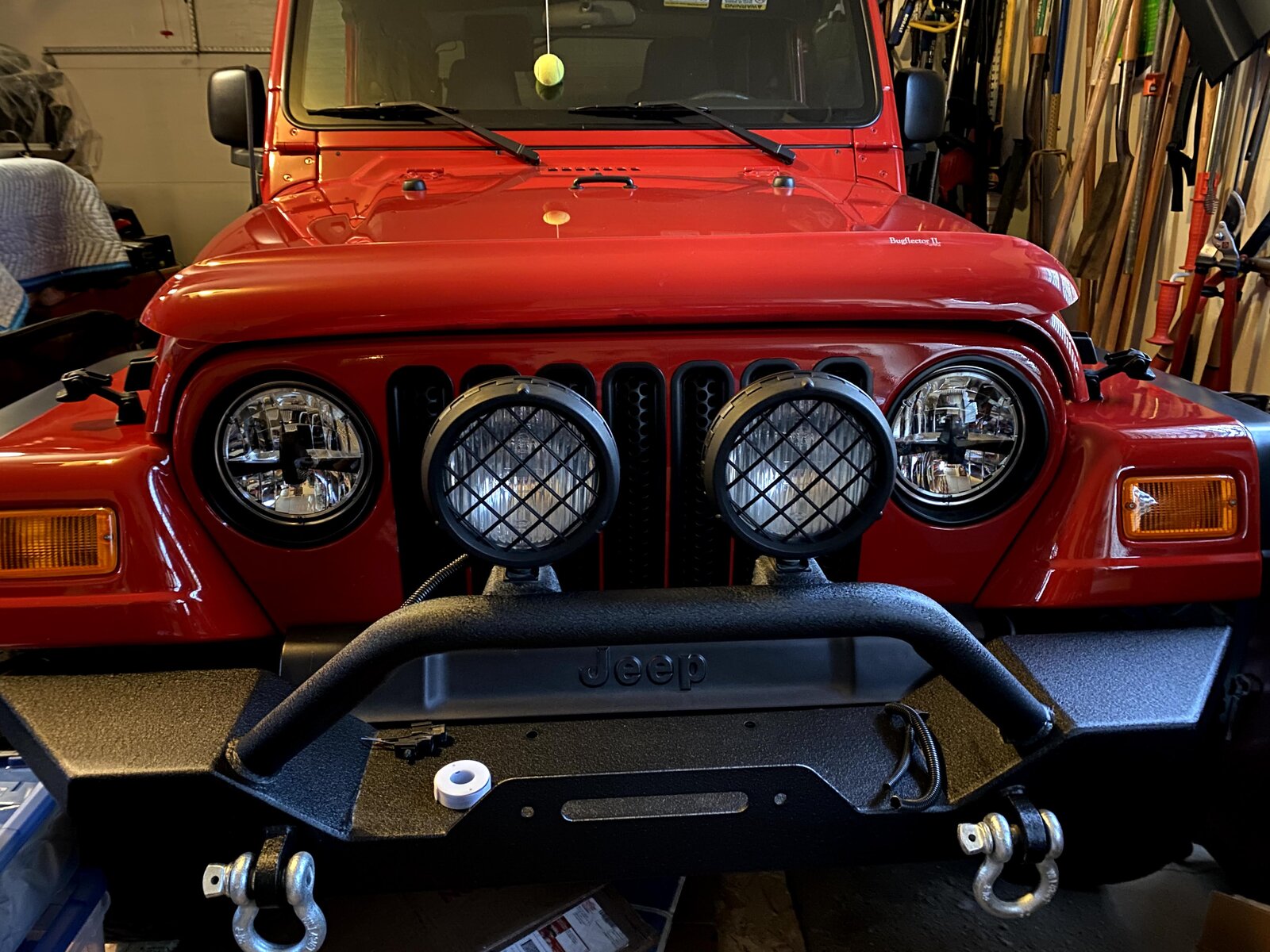

So I posted earlier on @psravits 2005 TJ Rubicon build with my anticipated build. Happy to say that it has officially started with the order of the Gobi Rack Ranger, which will hold the RTT and other gear. I was amazed that despite the holiday shutdown, I received a call from Gobi to confirm the order. I was pretty stoked about that. Unfortunately it will take about 16 weeks to receive the rack. BTW, Gobi has holiday promotion that ends January 11. I was able to select a free accessory so I jumped on the sunroof insert ($250 value). I will tackle that install when it arrives in April. After a lot back and forth discussion with the shop, I am moving forward on the TeraFlex Premium Suspension System for a 3" lift and adding a TeraFlex slip yoke eliminator. Shocks will be Bilstein B8 5100's. Tires/rims are still TBD but looking not to exceed 33". I was wanting to put a rear bumper/tire carrier set-up on it but the folks at the shop indicate that these set-ups are prone to a lot rattling and noise. Still researching but I do like the Hyline standard bumper and Spartacus rear tire carrier. Any thoughts on this? Lastly I got the factory fog lights working properly with 18 AWG wire. Also added black bezel rings and grill inserts. Thanks.

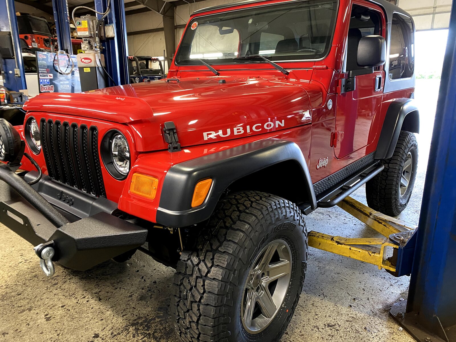

It's been awhile since I posted, but then again it's taken some time to get scheduled for the installation of the lift kit. Happy to say that is done now but the build is officially in progress. Here's where it's at: 3.5" lift, 33" Falken AT/3W's, and Quadratec Rubicon Xtreme rims. Still waiting on any word regarding the Gobi Ranger Rack that was ordered 4 months ago. Business is good for them for sure. This happens to tie into the Hyline bumper I selected to compliment the Gobi. Per earlier discussions, and BTW thanks for everyone's advice, it looks like I will go with the Rugged Ridge Spartacus HD tire carrier hinge kit and a large spare tire mount which pushes the tire further out for clearance. This selection will work better in the long run with the Gobi.
