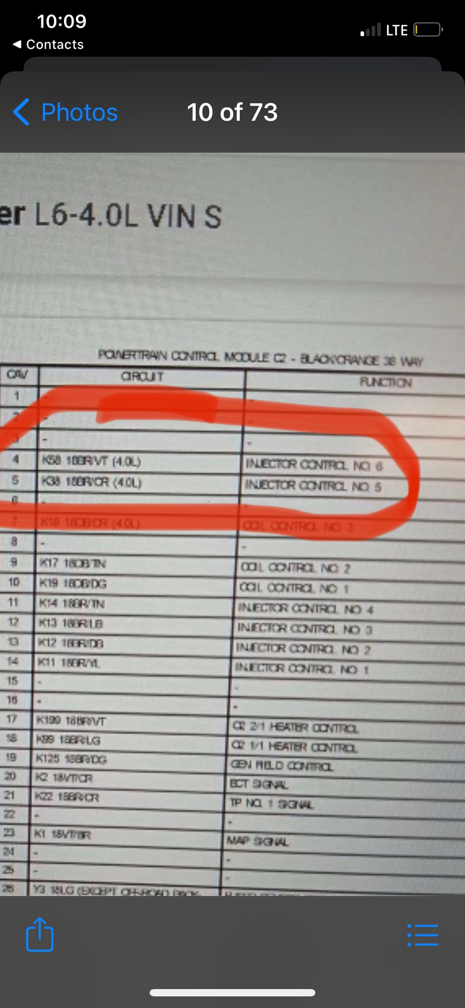

So I’ve been having a p0306 code for I don’t even know how long as this point and I’ve tried everything to the point it’s only come down to wiring and I was wondering if anybody knew any key locations I should start? I’ve switched injectors between #5 and #6, changed spark plugs 3 times, changed coil rails, done a compression test, done a leak down test, done a fuel pressure test, and everything came back fine. Thanks!
