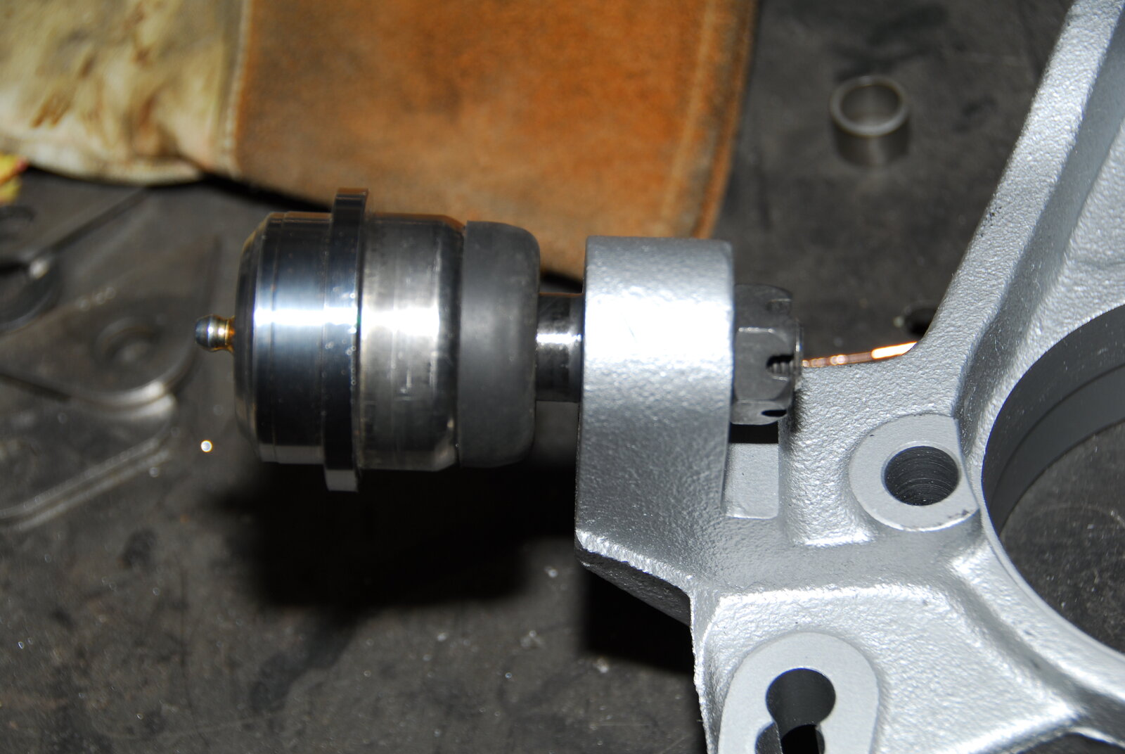

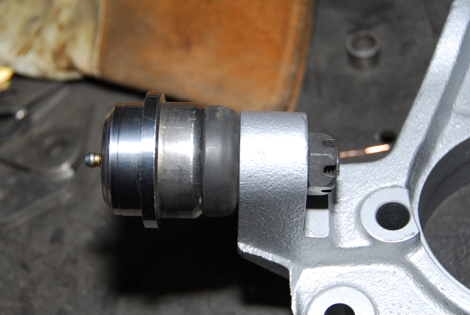

I was checking over my 2000 wrangler and I noticed that my right side lower ball joint was not fully seated in the c? I’ve been chasing a steering issue for some time now and was wondering if that will cause any stiffness or steering issues? It’s got a decent gap between the flange of the ball joint and the inner c… the other side is seated perfectly. I guess I just made a mistake but more importantly I just want to kno if this will cause any issues by not being fully seated? Thanks guys
If "the lower ball joint was not fully seated in the c", I'd think that would keep the steering knuckle too low and stop the upper ball joint taper from getting seated tightly in the steering knuckle. If the upper taper is seated maybe the C is bent?

It would not stop the taper on the upper from seating since the upper pin floats.

Thanks I’m thinking that’s been my problem all summer. It has a really strange steering feeling . I’ve had I lined up two times. Caster and toe are correct and camber is within stock spec to. I’m thinking I just found my reason for the weird steering having. I’m gonna take it apart and look at it. It was totally my fault for not seeing it not pressing in fully so I can blame nobody but myself. Thanks for the input. No matter what I have to fix it . Thanks

Thanks mr blain.. I’m an idiot. I can’t believe i didn’t see that before I reassembled it. I guess I learn something new every day. Today’s lesson….. slow down and check over my work;) thanks

If the upper pin wasn't seated on the taper correctly, you wouldn't drive it long or far before a terrible issue of some sort showed you there is a big problem.

There is some method of vertical adjustment for all double taper pin set ups because it is almost impossible to get two tapered holes the exact same distant apart. All it takes is half a thou larger or smaller on one and you are forcing the two pins together or apart via something like the knuckle.
The early Jeep knuckles were fixed pins so they put a threaded adjuster in the lower hole that you threaded onto the pin with a little 4 prong socket. Ford has a floating sleeve on the upper for the F-450 style. You snug down the lower, then when you tighten the upper it pulls the sleeve down and then expands into the hole because it has a split in the bushing.
