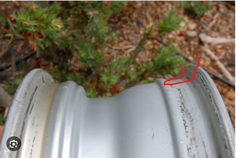

You need to go back to bubba and have them remove a tire. Once the tire is off, compare the wide of the tire bead to the width of the groove created by the safety bead and make sure that the lip of the tire bead is not up on the inner raised ring of the safety bead. If the inner edge of the tire bead is up on the safety bead on the wheel, they will pop off very easily and leak air or lose the bead.
If I understand you, you're saying the interior edge of the tire should be on the left-hand said of that ridge aka the safety bead?
I don't think that is what I said at all. The safety bead of the wheel is the only thing that keeps the tire bead from moving inward at low pressures. At normal street pressure, the air pressure does it but we need something else at low pressure and that is the safety bead.
The problem is there are no standards for tire manufacturers to use that dictate the shape of the air lip seal and bead. Some tires like the MTR have to have that trimmed down to run them with beadlocks because they are so wide.
