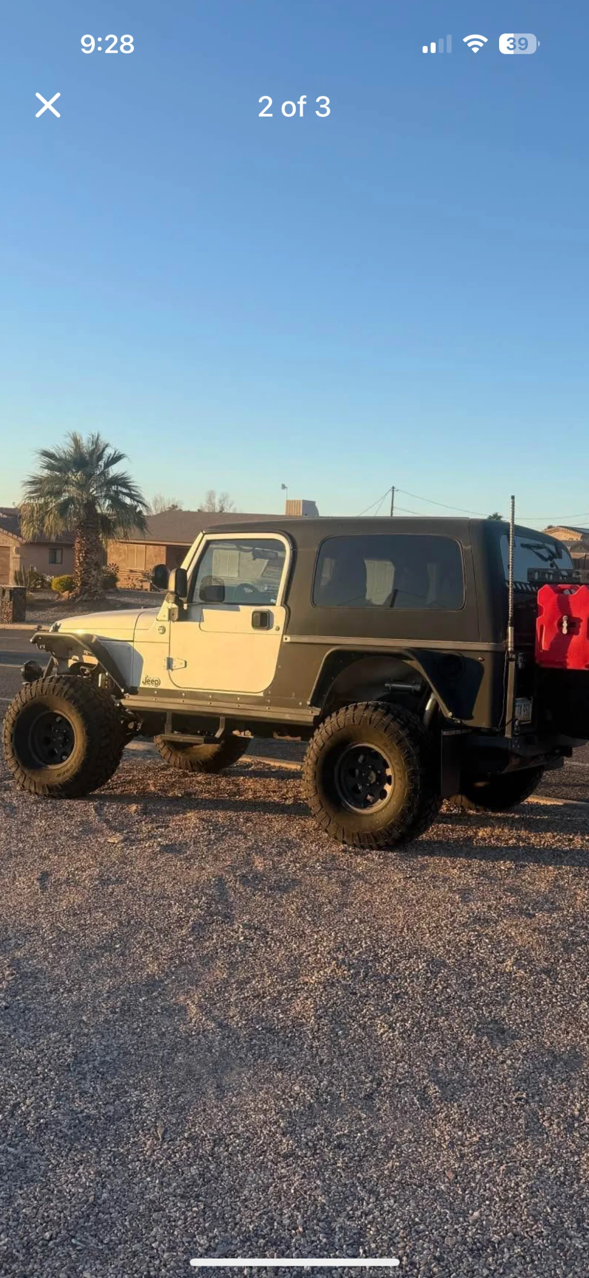

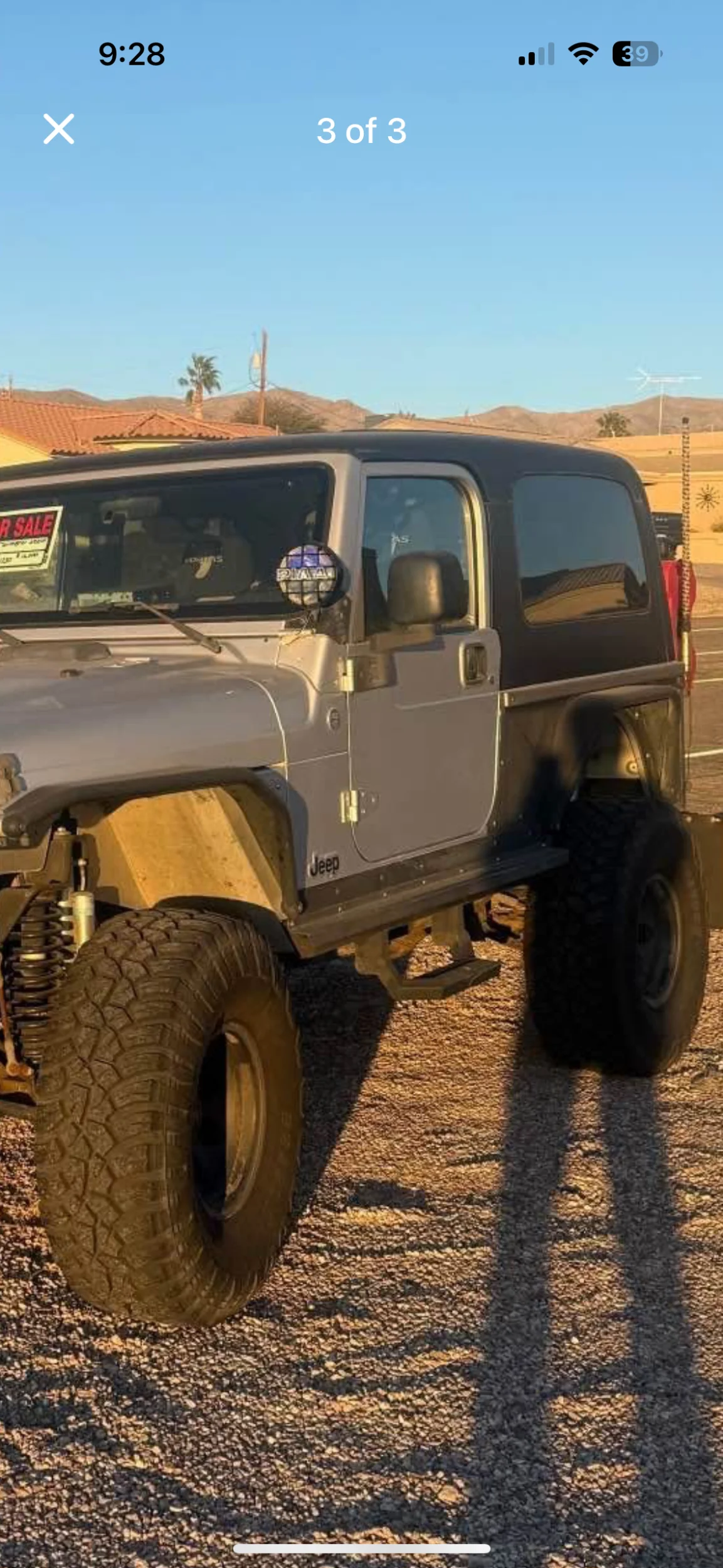

Okay guys. I have found two different jeep and they are both nice builds. What would you choose? I know it will come down to my preferences, but I still want to hear some opinions.
First:
2004 Jeep Tj Rubicon: 49K miles Automatic. Full traction lift (stretched). King coiler outboard shocks in the rear. Front has springs and Bilstein. ARB locker in the rear. ARB air compressor running locker. Factory locker in the front with RCV Axles. Genright front and rear fenders and roll cage. sitting on 37" tires. It seems like it has been wheeled a lot, but is not crazy beat up. Soft top. Automatic trans, transmission cooler. Bought it from his friend who was the original owner.
Second:
2006 LJ: 130K miles Automatic. Looks to be on a Savvy lift. Outboard shocks (Bilstein Reservoir). 35" tires. Metalcloak fenders , savvy sliders. The guy seems pretty clueless when I asked questions. His response is, you gotta come look at it. I don't know much about the build. I just thought it was a cool jeep. I asked if it had lockers, he said not the 4x4 shifter is inside the jeep. So, I will have to go see this one.

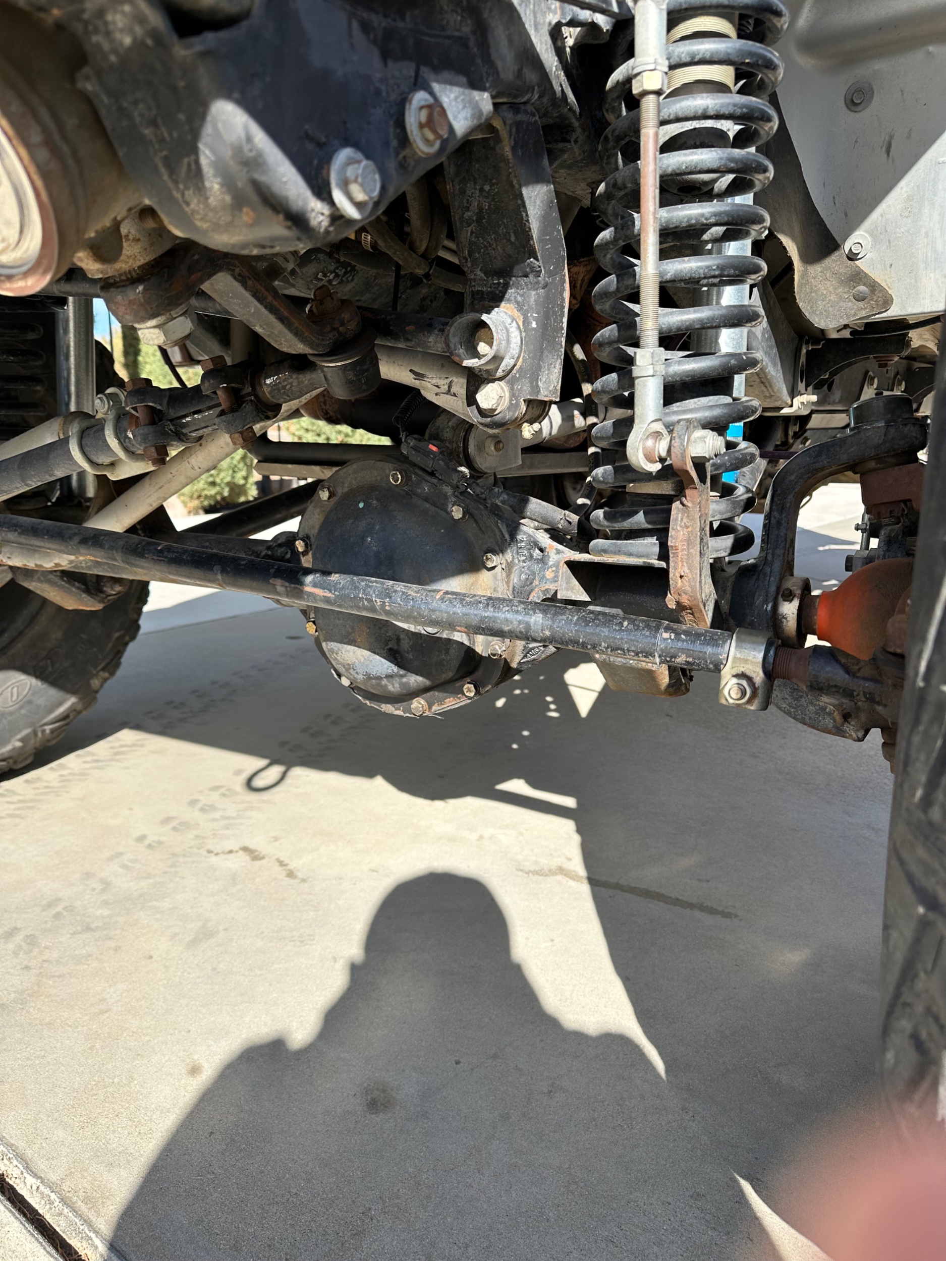

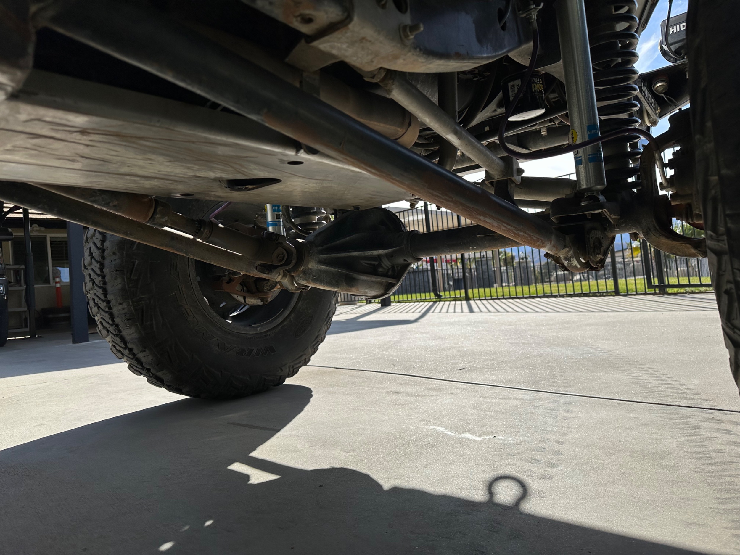

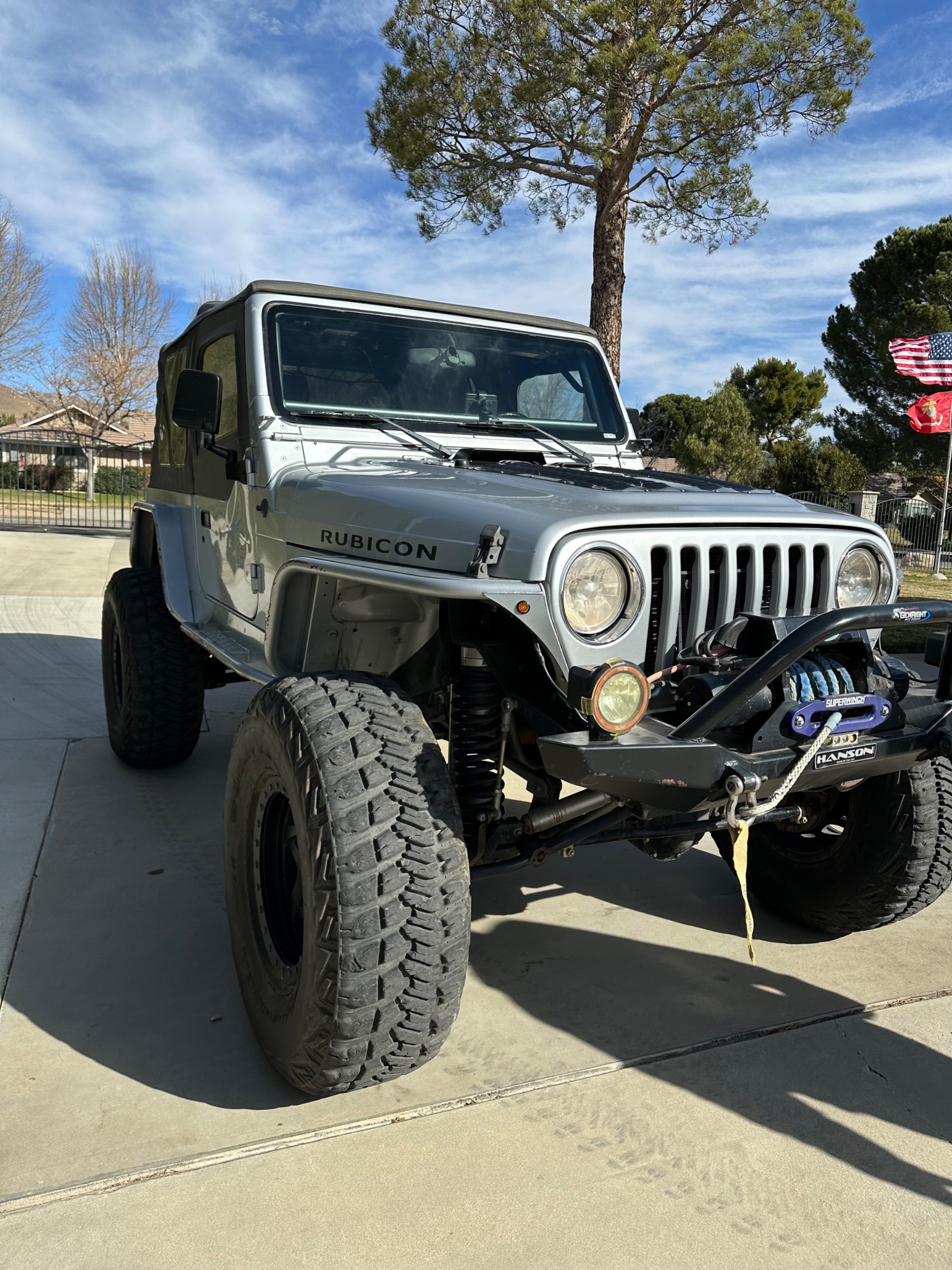

2004 Rubicon: Rubicon Dana 44 axles are not strong enough for those 37" tires and you won't be able to hear the axles low enough. Full Traction long arms aren't a great setup based on my personal experience.
2006 LJ: You'll need to regear to 5.38 to make that 42rle bearable on the highway. Figure $5,000 minimum for regear, axle shafts, and lockers.

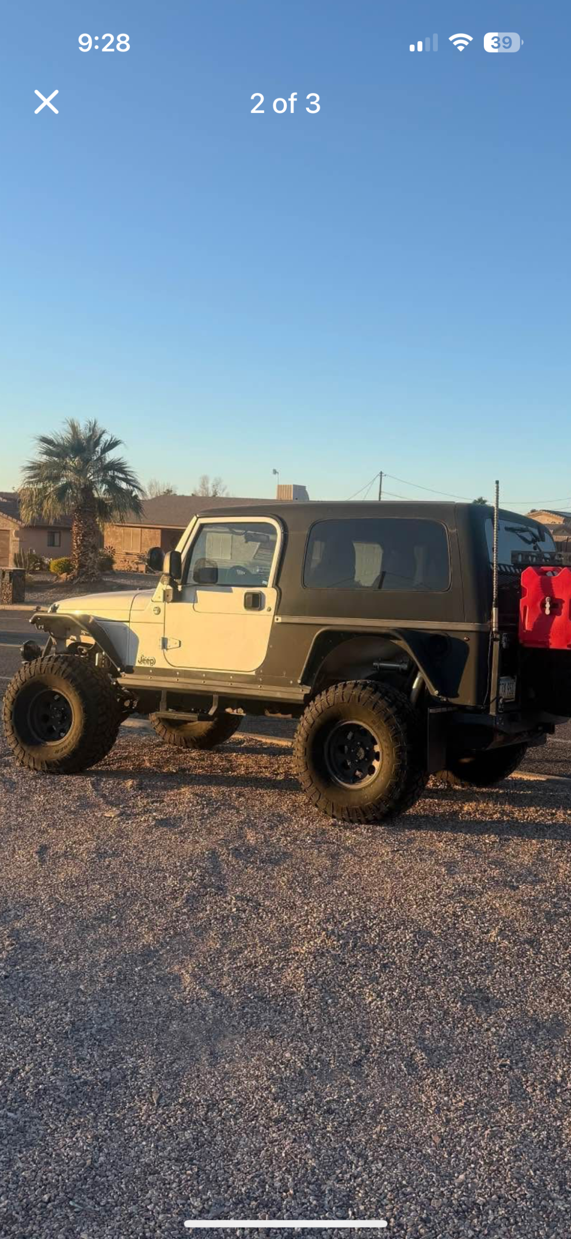

Stepping back from the specific details here - judging by your username, “Family Fun Wagon”, assuming you’ll be in a party or more than two people, an LJ would be more suitable for you and your family.
I’ve got one of each and if you’re not in tight terrain the LJ is really nice- If you like to go places and do things and carry stuff the LJ is head and shoulders better with the added room.
The TJ shines on tight trails.
Keep in mind built doesn’t mean built correctly so make sure you’re not gonna be straightening out somebody’s work more than you want.

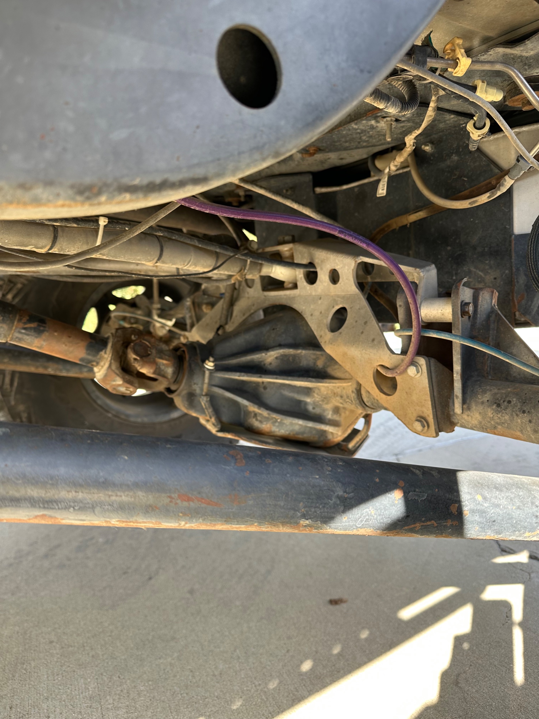

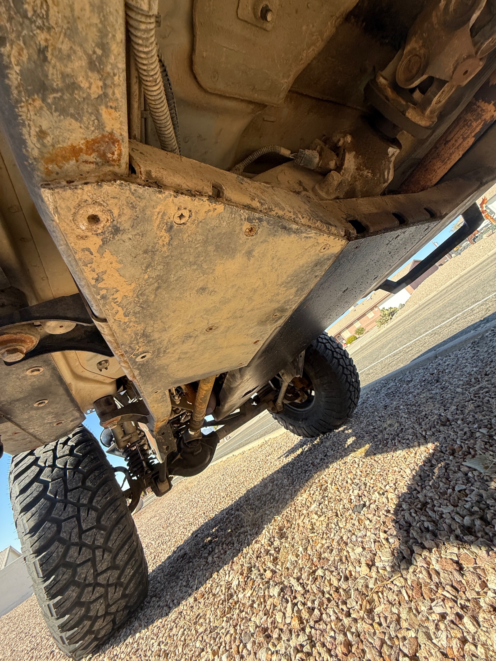

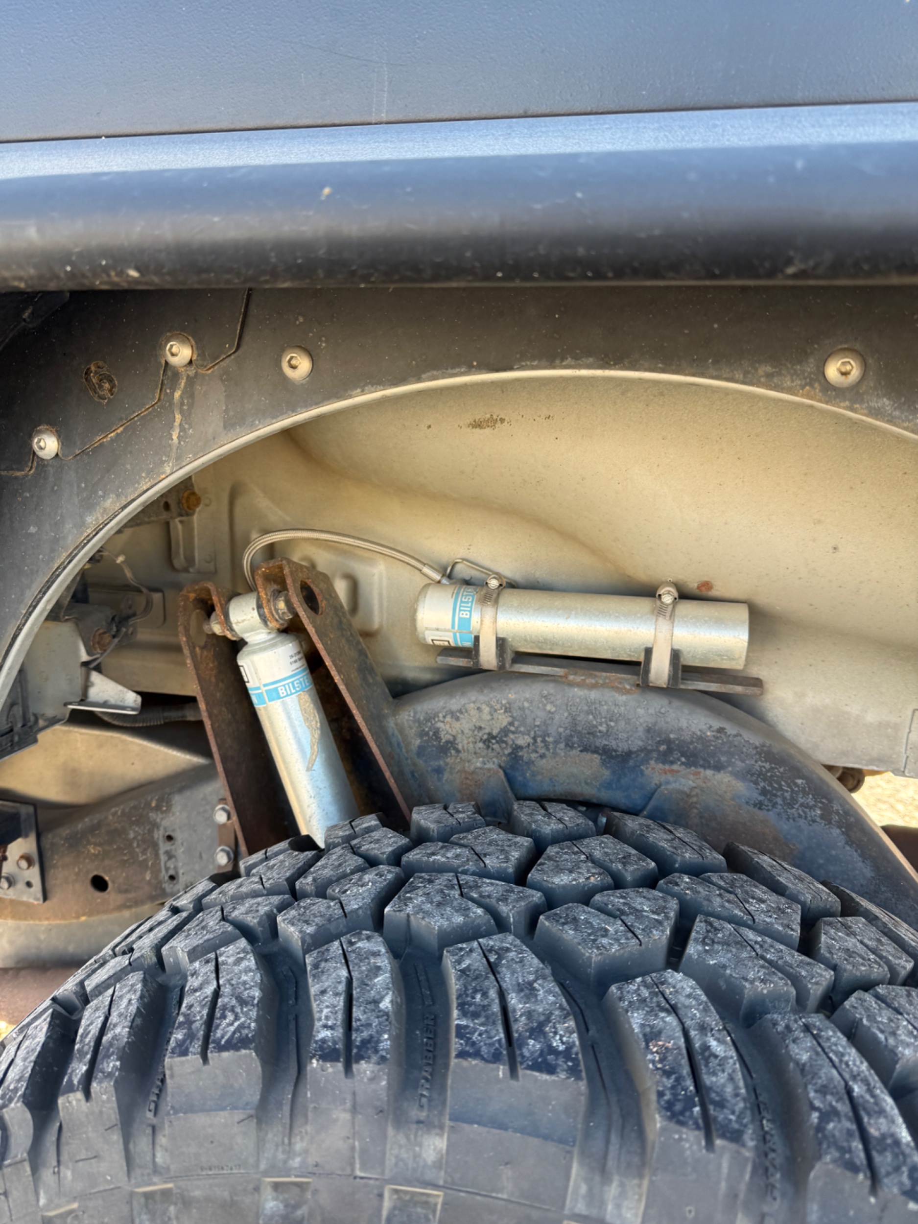

I forgot about the pack steering. And the rear shock mounts had Currie stamped. Don’t know if that means it is currie

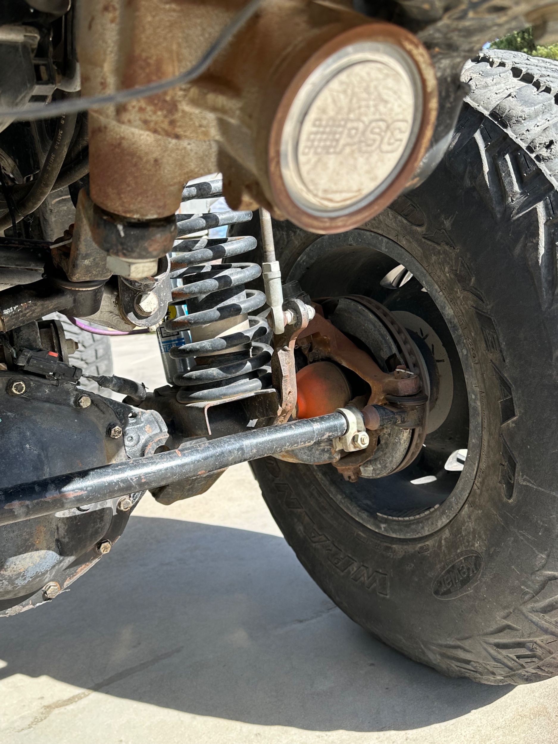

Remember that the Dana 44 ball joints are not up to running 37’s. You’d want to drop down to 35’s unless you want to be changing them every six months.
Not much love for long arm suspension, so if I bought that Jeep I’d replace it with a midarm. Besides that pretty decent setup. If the price is right.
