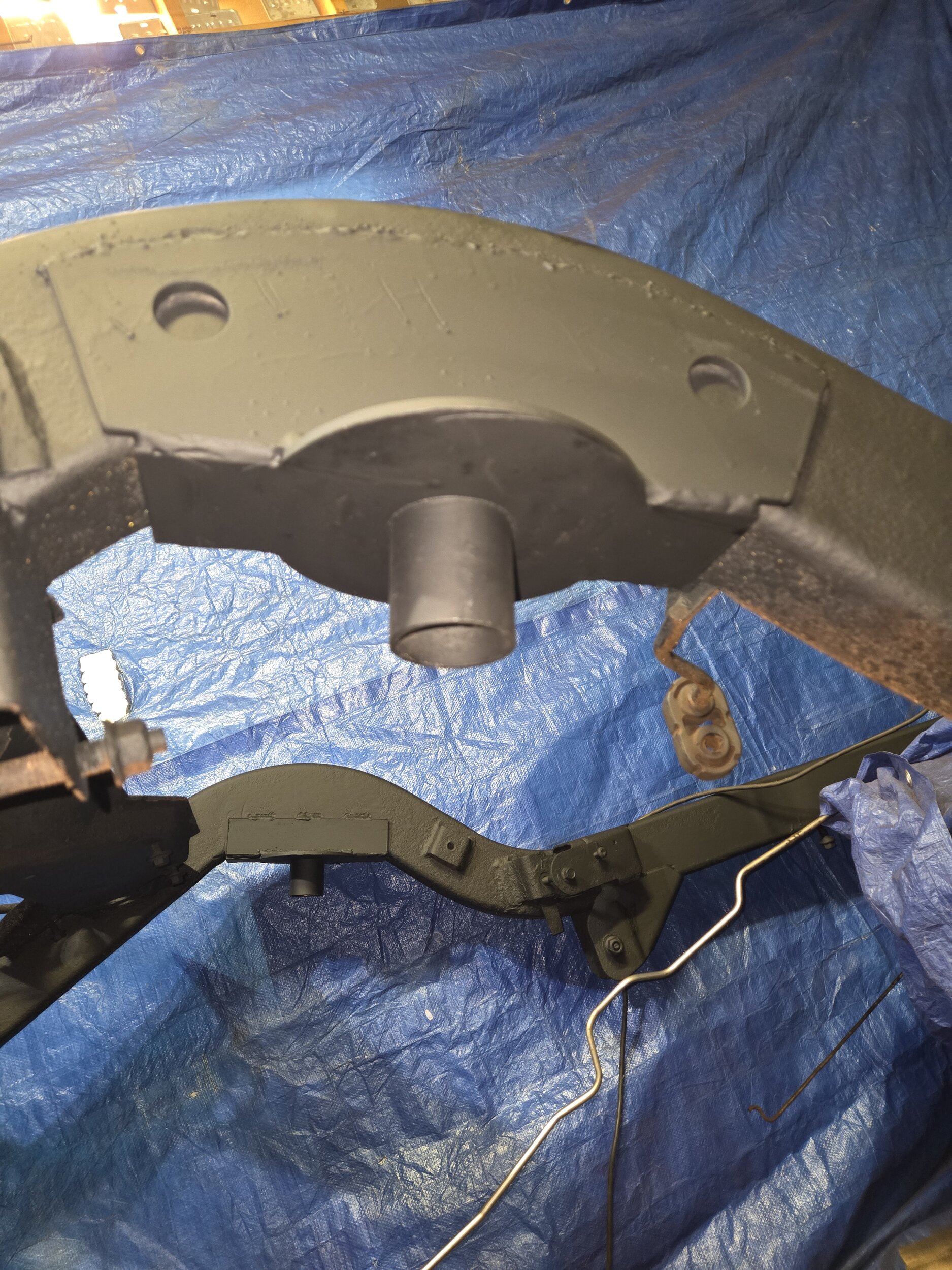

You've got to cycle your suspension without the springs installed to see what makes contact. Then you determine how much bump stop you need.
This is me failing to set proper bump stops on my front axle and smashing in my oil pan.
Also... general best practice for relocating spring perches is to just reuse the factory perch.

Mine were not useable. This what the uppers look like
