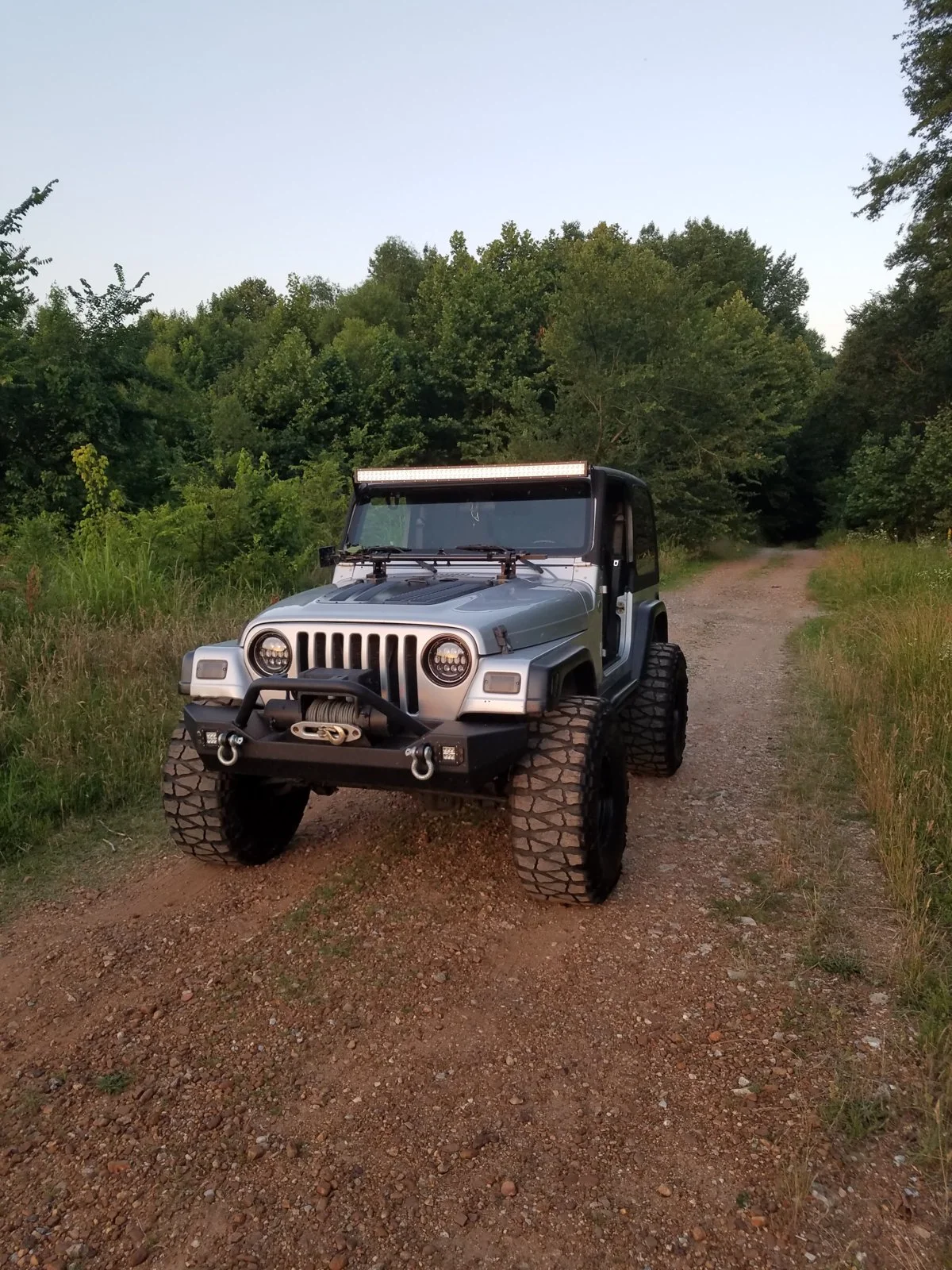

I run a 14.50 inch tire on a 10" wheel at 15 psi no beadlocks and I've never popped a bead, but possible for sure
Running a 14.5” tire certainly makes a difference. I say that because the majority of people it seems are running no wider than a 12.5” tire.
I’m going to assume you’re running 37” or larger?
Damn, those are some wide tires!!!
