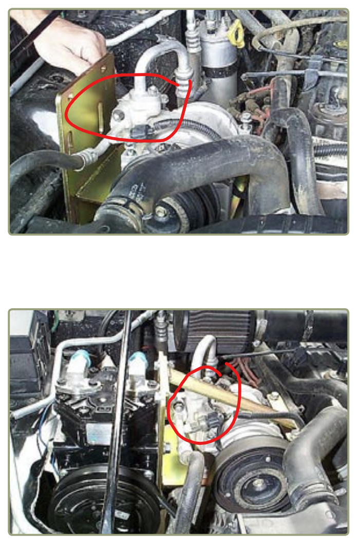

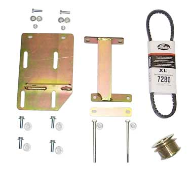

Not sure why I didn't think of this sooner but looked up Kilby's old site on the Wayback Machine and found he following info:
"In 1999 DaimlerChrysler changed the AC compressor mounting dimensions as well as the location of the AC manifold. It was necessary to manufacture a new bracket to accommodate the changes for the 1999 models. The biggest change was having to move the compressor mount closer to the passenger fender by another 1.75" vs. our KE-1000 kits. Because of this change, customers will have to cut their fender to make room for the York compressor. If cutting the fender is not desirable, check out our kit part number KE-RCA1. The KE-RCA1 is a rotary compressor adapter bracket that allows the use of a Sanden type of compressor in place of the York. Fender cutting isn't required with this setup unless the customer runs a big body lift without an engine lift."
For reference below is a photo of the Kilby York pump kit for a 97-98 vs that for a 99.
