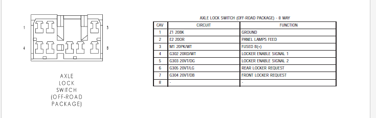

hmmm ... the diagram I posted isn't clear in that regard. It shows going to the switch. However the drawing below though implies all power comes through the pink/white wire.
If you're using the factory switches; you need to have the 4wd (low) light on.
Then you need to check if the locker light flashes when activated.
Then listen for air pump.

What part of that isn't happening?
No lights, no locker action. The issue is no power to the switch.
Start with the 4WD light.
If it doesn't come on when you put it in 4WD, then jumper across the plug at the switch.
you didn't read the whole post did you. I did that and it worked that way then the next time it didn't.
