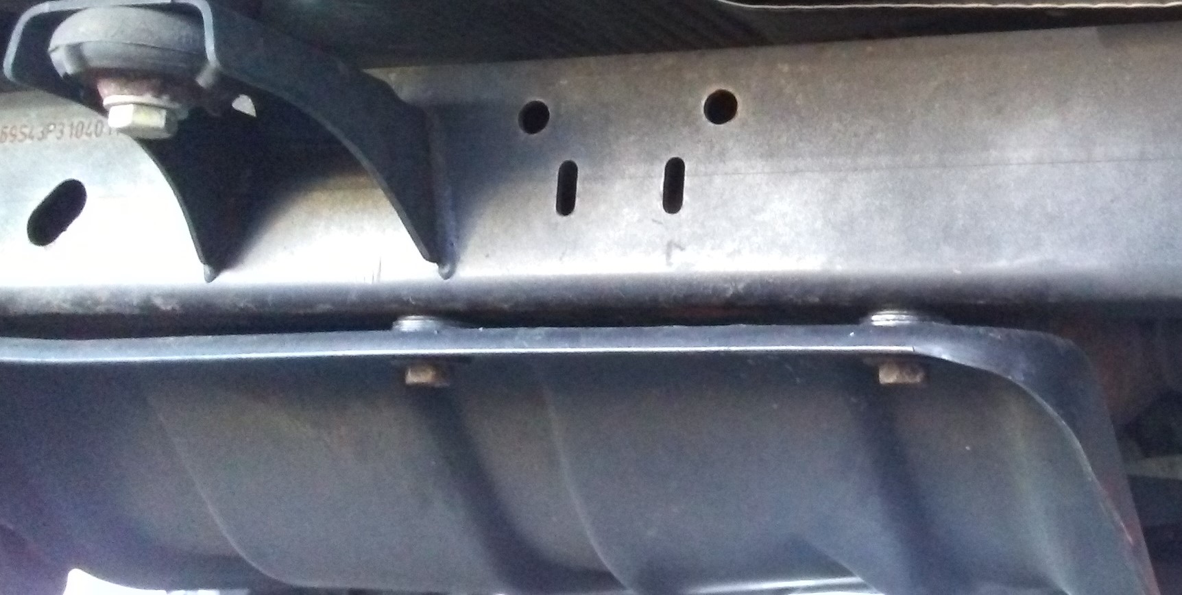

Drop the skid 1/2" with some thick washers (Lowe's $7 a pack of 24). If that works and you don't like the 1/2" drop, do a MML (motor mount lift).
